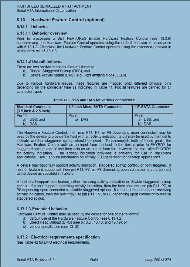

        For SATA the drive activity LED is ported out on the power interface instead of data, unlike PATA. Getting the drive activity light info is kind of useful for me, I wish I had a source of the SATA power connectors that had that wire connected out.
          That sounds like nonsense to me. Power goes directly to power supply, there is no way to get anything from that. You need to go the controller way.

            Sounds like nonsense but it's the truth! Nothing is stranger than the truth!
              Specs:
              See page 259 and onwards (click picture to zoom).

                But that's only relevant for backplanes, that means servers mostly, not that you connect a wire to pin 11 and go, you will read nothing as long as it is grounded. If you wanted to use that, you would have to place a board between the drive and power connector, and interrupt that pin 11 ground.

                    Regardless, yes this is for a hotswap backplane and can be applied to general purpose usage.
                    Here's someone with a minimalistic wiring for the power connector to have an activity light - and virtually it's the same for my 4-bay SATA hotswap backplane.
                    http://www.tooms.dk/forum/topic.asp?TOPIC_ID=280
                    I have one last singleton hotswap bay that does not port out the activity LED. I really wish this one did so I could see when this bay is actually being used or not.

                      OK than it makes sense :-) But definitelly use some small transistor as suggested, even the spec says it has very low current and is not to drive LED directly.
