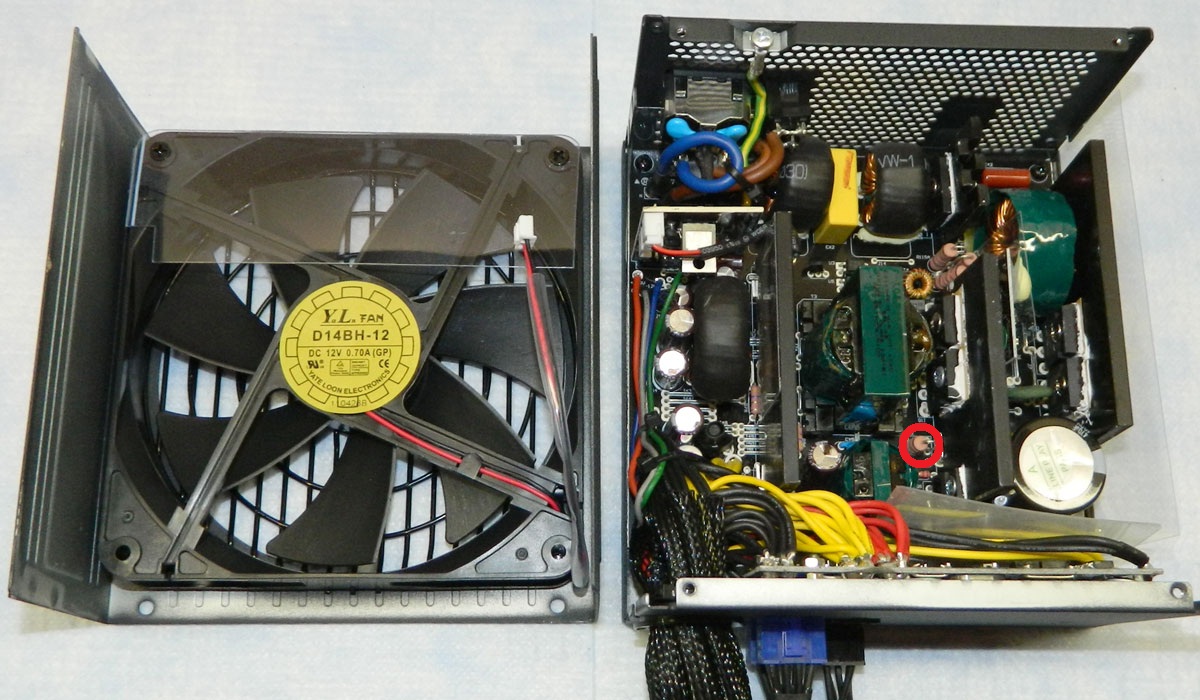

    Ok I am working on an ATX PSU, namely a corsair TX650.
    This PSU came to me after it went bang on its owner... The underside on the secondary side of the board was black... after cleaning with IPA i found a vaporized MOSFET and using my DMM found a few blown SMD resistors... Having replaced these I have one last issue :
    There is a through hole resistor that has fried... the bands are unreadable and I have no idea what OHM this resistor was... Is there any way at all of working this out?

      Post a picture of it. Maybe someone here might have a similar unit for reference.

            Re: Burnt resistor
            This is the resistor that has blown on this PSU,
            After looking at many inside pics of these PSU's Im pretty certain its the same as a few others in the supply, Though im not familiar with the banding...
            BROWN - GREEN - SILVER - RED - BLACK
            Can someone tell me the rating please?

                    Re: Burnt resistor
                    That would be a 0.15Ω resistor, but that seems too low, can you get some closer pictures of it?

                      Re: Burnt resistor
                      Unfortunately no, The one in this PSU is fried beyond recognition.
                      I have had to use pics from google
                        Re: Burnt resistor
                        That resistor can be the Source resistor for the MOSFET, or the fusible resistor for the B+ Feeding the B+ o the MOSFET. That low value is about right, but you should trace out the connection to see how it is being used in the circuit since you may have other damaged components that took out this resistor.

                          Re: Burnt resistor
                          if the resistor was feeding the "vaporized" FET then it (the FET) likely failed short just before it popped, taking the resistor and other components with it...
                          "fusible" resistors are usually low values like this but are (at least in properly designed circuits) meant to fail open in order to protect other components.
                          I'm still not that great at reading 5-band resistors (they confuse my old-skool brain) but 0R15 is a "preferred" value so is plausible (depending on where in the circuit it is of course).
