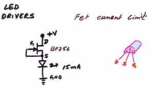

          Now that I think of it, it was actually a single FET constant current source like attached. Can't get much simpler. Wish I hadn't glued the watch box closed so I could see what part I used.

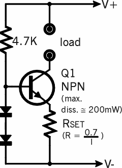

            This is the one transistor current source I was thinking of, built quite a few of these for various nicad chargers over the years. Add a rotory switch with a few resistors and you can set the current for AAA AA C D and 9v batteries, 1 to as many cells as you want in series.

              I use LM317 for constant current source for battery charge or just for current source, 1 resistor for setting the current.

                Simple and convenient (assuming you have some 317s laying around) but limited to 1A max and 35V supply. The above circuit has the advantage of working with just about any current and voltage you can find a transistor for. Not to mention it's esentially free using parts pulled from scrap boards. You can even add another diode in series and use a darlington power transistor for REALLY high currents.

                  I do have many many many LM317, LM338 in my stock. You can also add pass transistor for higher current source. The max. differential spec of 40V, so the max input voltage will be the 40V max across the LMXX + VLoad. I max 1.5A
