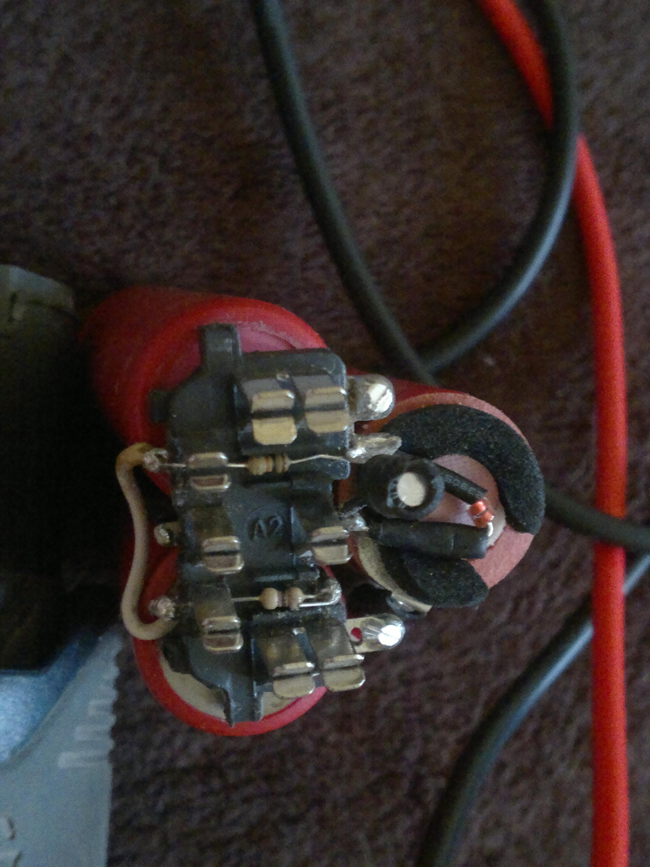

    hi all
    i am new to this forum and have many questions about quite a few things and intend to learn a lot
    but yesterday my thithium battery stopped charging and charger indicates broken battery
    i opened the battery to see if i could replace the cells with with a bigger ah
    i tested each cell to find that they read 4.13 4.15 and 4.11 this seemed about right so i investigated further to find that the strap from 1 battery to the other had broken so i solered a whire across the twothought this would be the fix
    it was notthere are 3 cappasitors 1 temperature sensor and somthing on the side that i havent uncovered yet as i think 1 of the cappasitors has a ground fault
    my quesion is how do i identify the offending object
    thanks for reading and dont be to harsh if ive got it wrong altogether
    i have attached a pic to help
    cheers

    Re: aeg 12v lithium battery broken
    hi all
    can anyone help with this battery it is showing as broken in the charger and i could do with it for work
    thanks
      Who make this battery pack
      If this is Milwaukee M12 battery pack
      There is something you should know about these battery pack if the voltage
      different between cells more than ( [0.25 ] volts it will not charge this is not a misprint )
      Battery Load.................>>>
      You need to test these batteries one at a time you need a 12 volt 50 watt bulb and a volt meter
      Each battery need to read about the same voltage and different can not be more than more than ( [0.25 ] volts between cells
      if it is more than that then these cells are weak

        • Jul 2011
        • 6070
        Do you have a spare battery that shows good to know if the charger is working right
          it seems to be a bit out of balance.
          i bet the broken joint caused the management chip in the pack to shut down.
          some can be reset.
            thanks for the replys
            the battery is made by aeg witch is somthing to do with Milwaukee i think
            i do have another battery and the charger is working fine
            it was a broken connection that stopped it working but i have soldered a bridge across the breakage
            i will check the voltages of the batteries
            just throwing this in there how about if i attach a small fan and wait till all batteries are dead then do you think they will recharge
              Maybe but do not count on it....> "do you think they will recharge"
              " wait till all batteries are dead then ".....> This is not a good idea you need to only discharge them to a voltage of 2.8 volts and no lower than that
