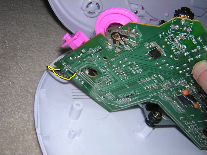

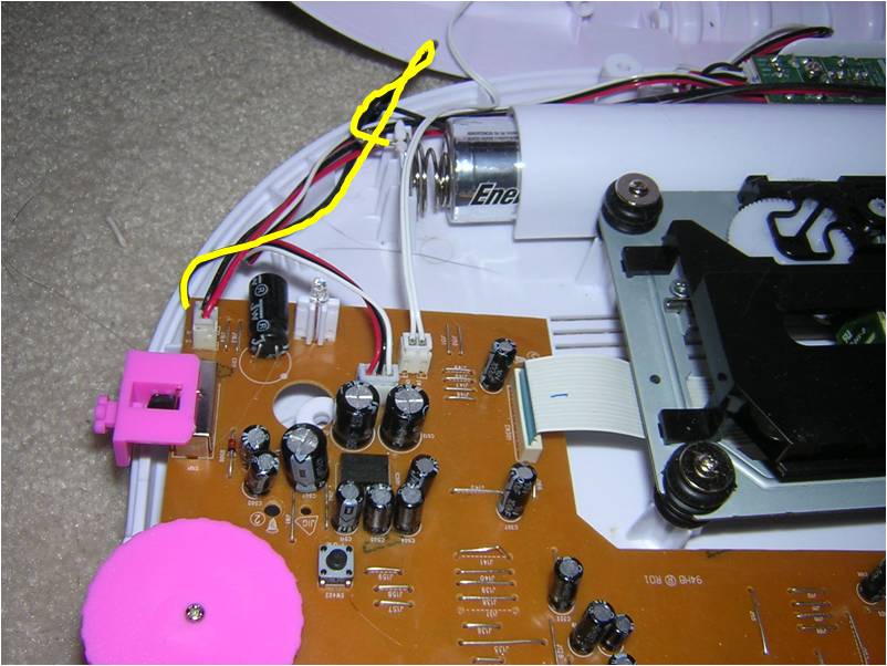

                • Welchs101
                  • Sep 2008
                  • 979
                  #48
                  Re: Dead Hello Kitty Karaoke Sanrio machine
                  ok.... i will give that a try..........
                  • Welchs101
                    • Sep 2008
                    • 979
                    #49
                    SUCESSSSSSSSSSSSSSSSS
                    such a sweet word.............
                    THANKS THANKS THANKS................
                    my daughter thanks you as well...............
                    i think its working...............i did what you said........connected black wire from batter to main board.........i will post pic later............anyway, it plays a cd.........i still have to check other functions............i will let you know what i find..........but looks good thus far.
                    • Welchs101
                      • Sep 2008
                      • 979
                      #50
                      things seem to be working......i am going to post pics of how i soldered wire from black lead of battery to underside of black wire on main board.
