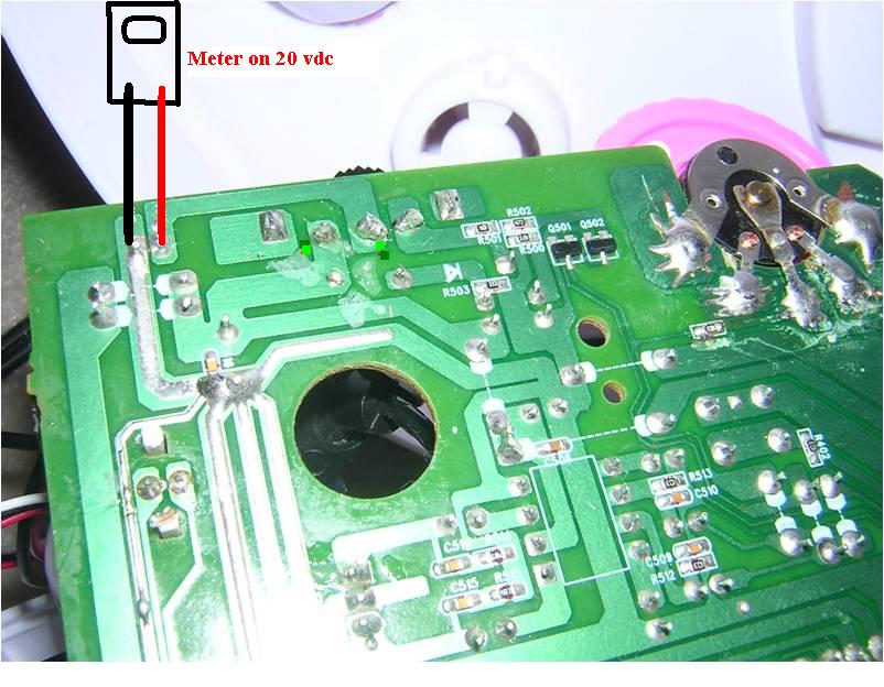

      Look at the picture provided by user selldoor at 9:49am today (there's an arrow indicating where). Check if there's voltage coming into the big board. Leave neg- prove on the batteries and then put pos+ prove on the red wire. If voltage is coming in to the board, your next step will be to check the on/off switch for voltage.
      • vinceroger69
        • Mar 2012
        • 6714
        • uk
        Re: Dead Hello Kitty Karaoke Sanrio machine
        pic in post number 13
        that should tell us if voltage is getting to the switch board.
          ok, so using the suggestion in post#13...........and the picture of the red and black wire.
          With batteries connected.......i place the black lead of the volt-meter to the "neg" terminal of the battery..........then i placed the red probe of the volt-meter to the black wire and red wire.
          Black-wire voltage measurement: 9.39V
          Red-wire voltage measurement: 9.5V
          i guess the next step is to measure the switch......i will do this next.

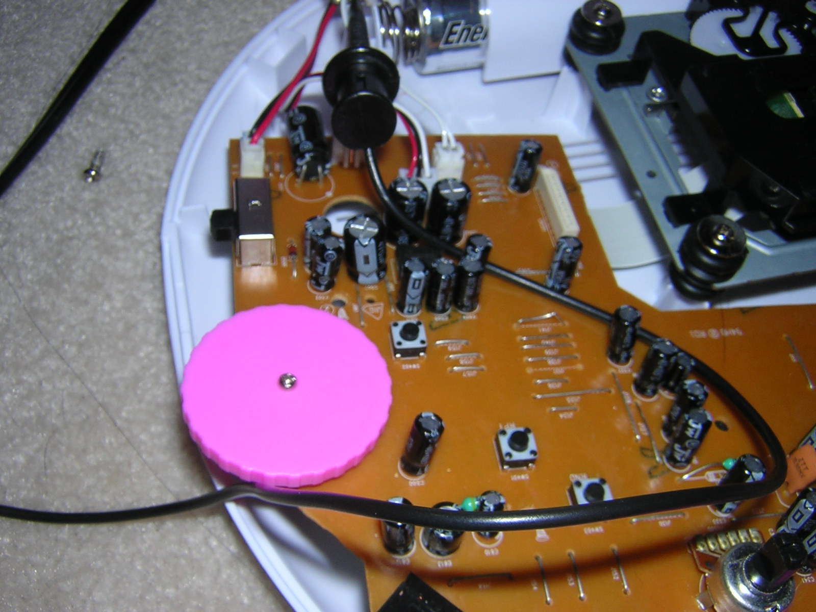

            ok....i measured the voltages across the switch......
            see enclosed pics
            One of the pics show a yellow square around the main power switch
            The other pic shows the backside of the switch ...... in this pic notice the nodes labeled "1" and "2". When the switch is in the "on" position the resistance between nodes "1" and "2" is about 0.4ohms.....
            when i connect the batteries.........i measure 9.5V on node 2 and when switch is in the "on" position i measure 9.5V on node "1"........when the switch is in the off position i measure 9.39V at node "1".....
            note: how i measured voltages is with my black lead from volt meter at the "neg" side of the battery.......
                Its no good giving us one half of two tests. You need to apply some logic to what you are doing.
                I am going to test a switch - what do I need to know?
                When the switch is on what is the resistance going to be?
                When the switch is off what is the resistance going to be?
                When the switch is on what is the voltage going to be?
                When the switch is off what is the voltage going to be?
                You then match what the answer should be, with what you get when you do the test.
                That switch might also have more than one set of poles(contacts)

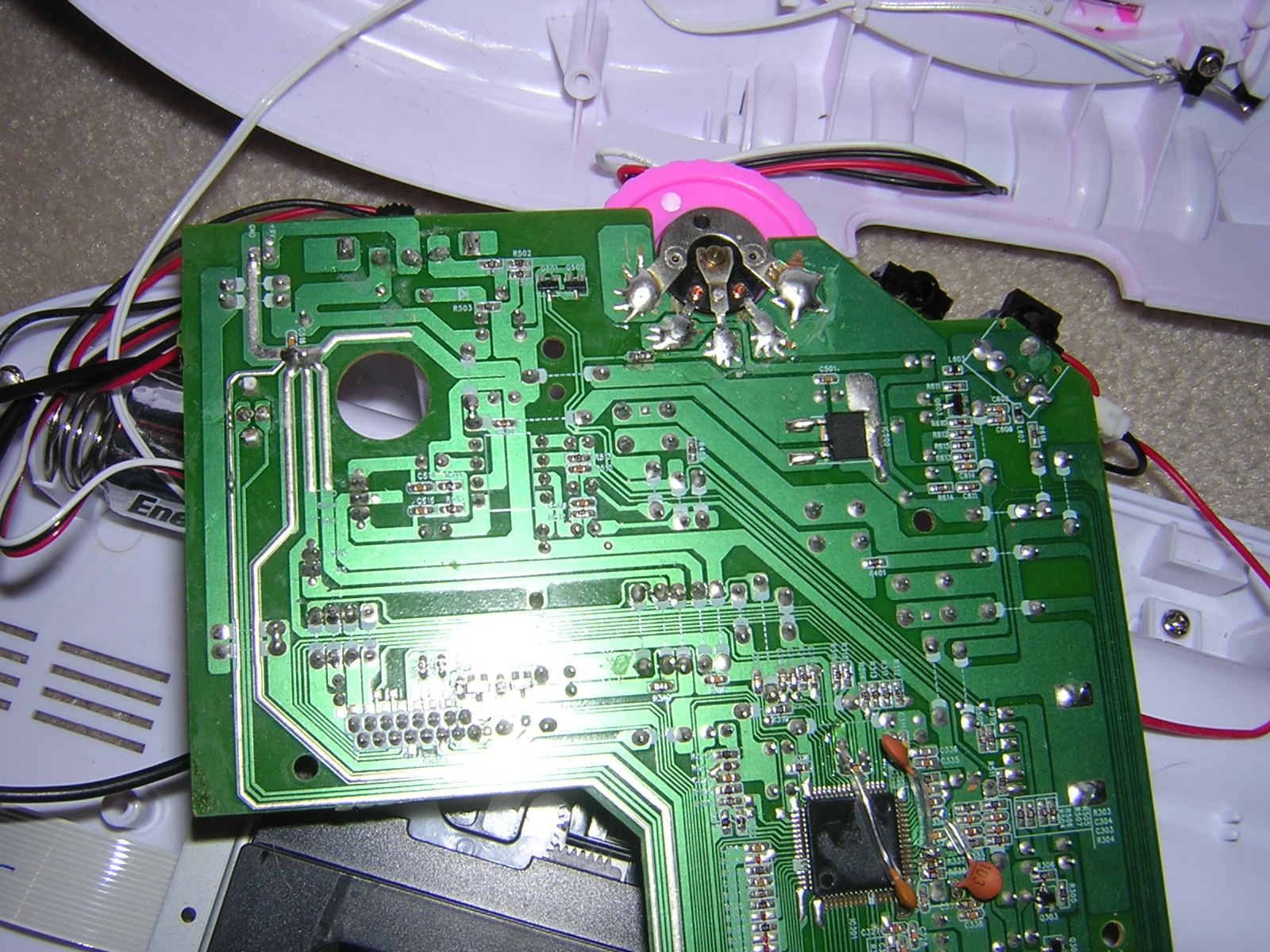

                Anyway we will be here all year at this rate so just do the following.
                In your picture I have marked places to test. The board is marked Gnd=Ground an 9v+ so with your meter on 20vdc
                put the black probe on Gnd then with the red probe test
                1:2;3;4;5;6 then do it again with the switch in the other position If all zero just say "all zero"
                We could do with a "straight on" in focus pictire of the whole of the back of this board and of the front in the same orientation.
                  hi selldoor, sorry that. Hey, i was going to try and make the measurements you requested this morning but i could not find the picture you marked up.
                  • Welchs101
                    • Sep 2008
                    • 979
                    #29
                    i tried to take some better pictures........if there is a specific part of the board you would ike me to shoot.......just let me know.

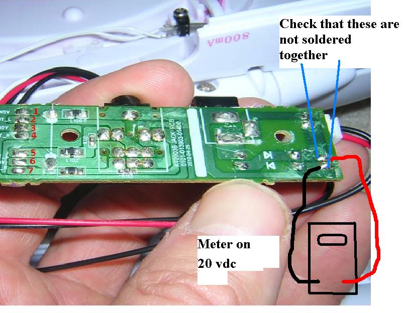

                              Its like snakes and ladders
                              Try this as I asked in post13
                                Actually I think you have answered that - it was zero - yes.
                                Try this one instead
                                  I really like the pics with the meter on them.........
                                  I put the battery in the unit. I measured 0Volts between the two nodes as you showed in the pic.
                                  I measured the resistance between the two nodes and ....well....it was hard to get a reading but it varied and it was around 120Kohms........kinda jumped all around. but i think this is what the avg value would be.
                                    Ok - i think we are right back at the beginning. I cant quite make out all the traces on that little board - can you do a straight on picture of the right hand side.
                                    I still think the problem is inside the barrel power connector there is a switch. When you plug in the power supply in it cuts off the battery supply. When you unplug the power supply it reconnects the battery supply - I think it is not working.

                                        #39
                                        The little one with the power socket on - I willl want you to get a short piece of wire and
                                        connect the black lead from the battery to the black lead that goes to the big board
                                        and possibly another piece to join the red lead from the battery to the red lead that goes to the big board. In effect cutting out that board all together. You dont need to solder
                                        just hold in position and see if it comes on try the black to black first then the red to red.
                                        Then if nothing both at the same time. I am just not sure if the switch is on the black side or the red side - that is why I wanted the picture.
                                          selldoor,
                                          you might be on to something. I added a wire from the "grn" side of the battery and shorted this wire to the black wire on the "main" board..........things kinda came to life. I just did a quick test to see if anything would happen and much to my surprise the cd player laser head moved and the lcd come on. Tomorrow i will try a more stringent test.......but i wanted to let you know.
