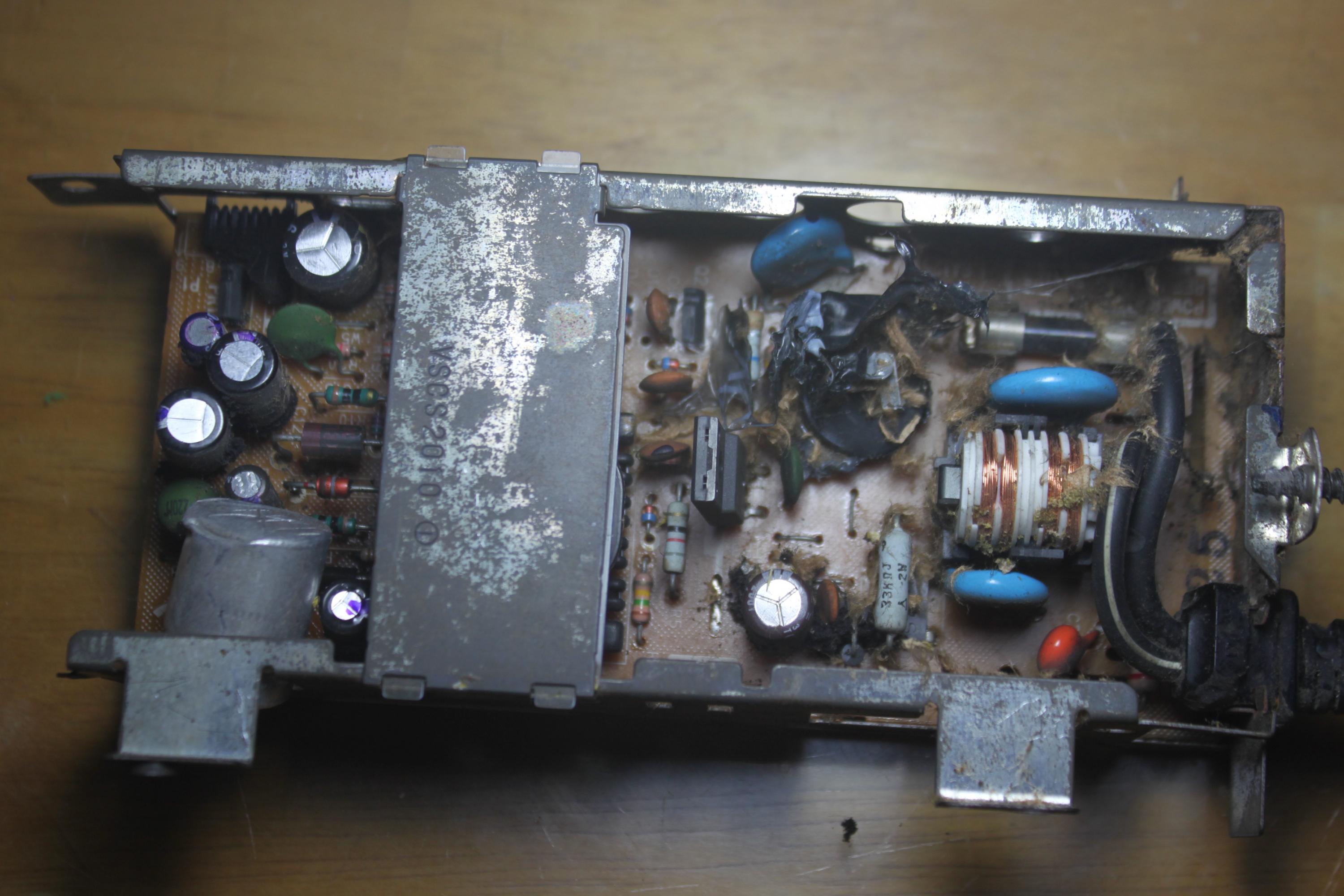

    Does anybody knows what is the value of C4 of the power supply module of RCA VCR Model number VR501? This unit was plugged to 220VAC and the big capacitor exploded.

    Looks like C4 was what went off in there It'd be pretty hard to tell...that cap evaporated.

      I'd guess 330 or 470 microfarads 400 volt.. But it's only a guess. It will probably work with a 470 to be safe but I think the 330 probably will work too.
      I'm only guessing based on the facts:
      this appears to be a switching power supply
      this appears to be the mains filter capacitor
      only one mains capacitor
      220VAC
      estimate around 100 W PSU
      Does not look like like a heavy duty power supply like a PC
      not a tiny supply like a phone charger
      But this is merely a guess...

        I would say that it is an 82uF 400v cap, or maybe 100uF 400v.
        Check the bridge rectifier for shorts, and also the fuse will need replacing.
        Did you find the covering of the capacitor? that may give us a clue to it's ratings.
        Looks like ther was something blocking the top vent of it, and it just built up pressure. Must have been very loud!!!

          I forgot to inform everybody that this unit for 110volts AC was plugged to 220VAC. Yes indeed, it was a very loud explosion! Somebody forgot to use step-up transformer. Unfortunately, the covering was totally unrecognizable.

            The fuse seems to be gone as well.
            If it blew up from plugging at 220v, then the capacitor was probably only rated for 180-250v
            Based on the size of it, I would guess 200-330uF

                In my old Panasonic VCR, designed for 120VAC, it was 120uF, 200V.

                    I bet you that the vent was too close to the lid of the PSU, and it couldn't vent. So it exploded
                    Try a 120uF 200v cap in there, replace fuse, and see what happens

                      being that this is a panasonic built unit the 120@200v is spot on.
