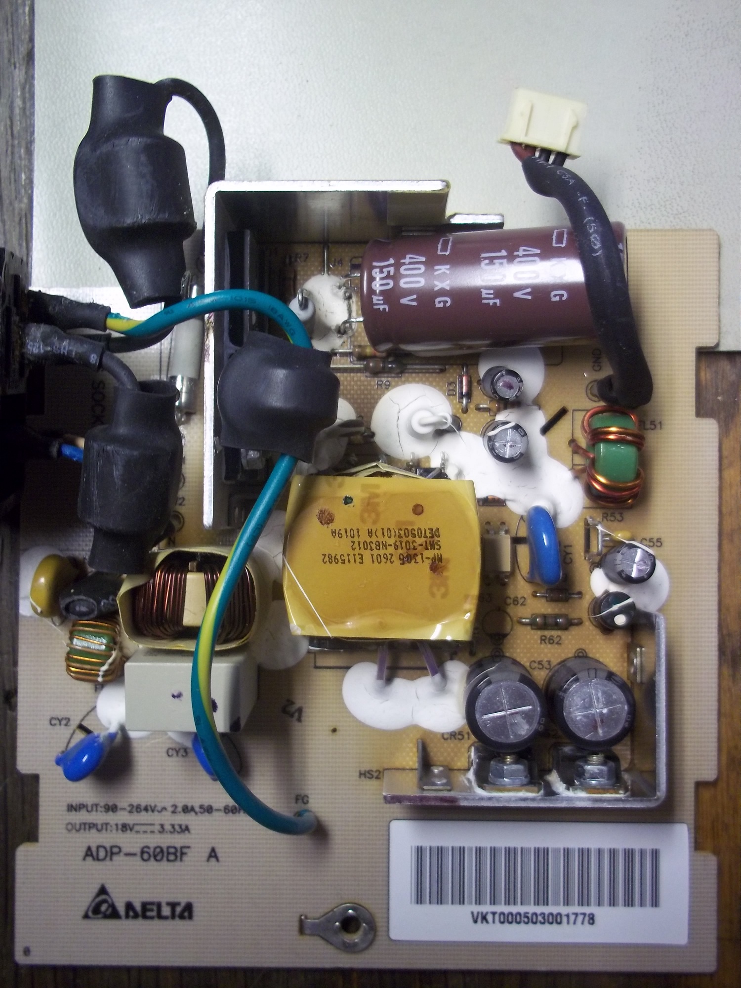

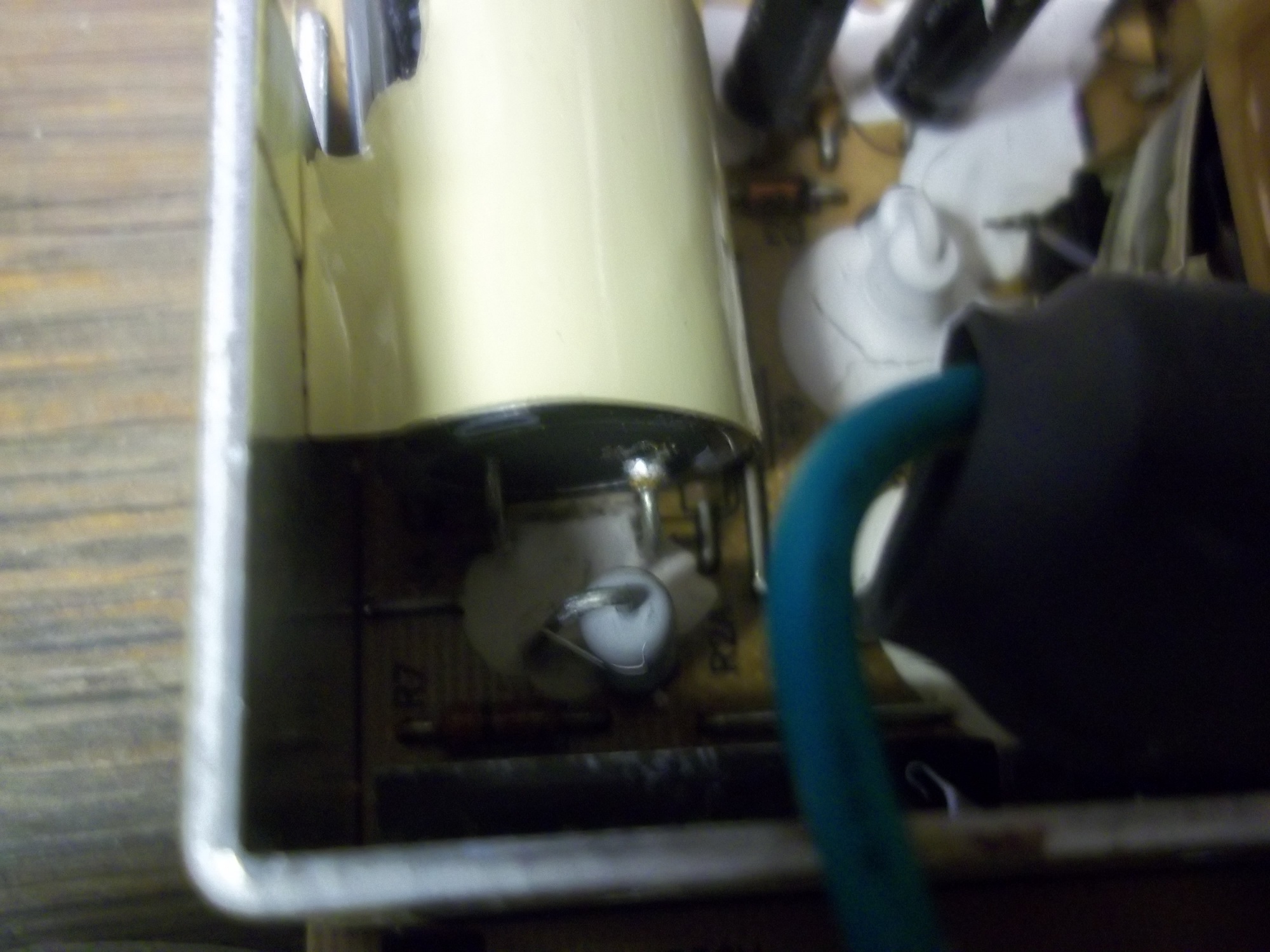

I got a VP211B monitor, completely dead. I took it apart and it has all nichicon PW wet lytic caps on PSU and and dry lytics on the signal board except for the main filtering cap. It's bulged on the vent and the cathode lead is pushed out. It's got some sort of yellow paper tape stuck on the cap, it's hard to remove. I managed to scrap enough of it away to see it's a 400v 150uf cap but I don't know what series it is.
What cap should I replace it with?
