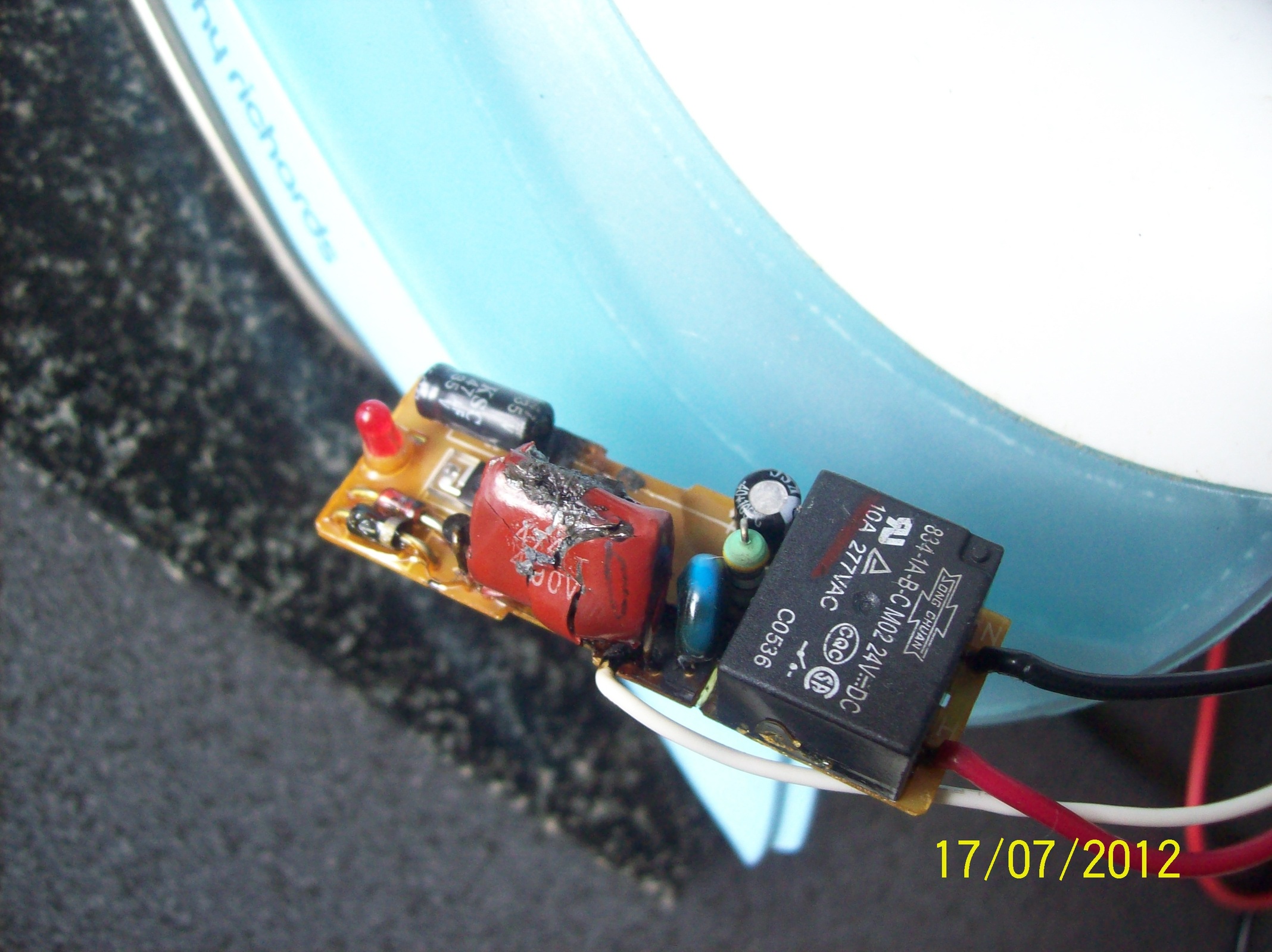

    My Iron just went bang. Pic of internals.
    Is it worth fixing or just buy a new one?
    And what is it that went bang? Is that a cap, I'm only used to radials at the moment.

    thats a polyester cap,cheap to replace

      From what i can make out is that its a 474j 400v cap. How on earth has it exploded rated at 400v?
      Think i may just buy another iron.

        Maybe the cap is not the only problem, but electronics characteristics are falling with ages

          Ok, deffo a new iron then

            I would try replacing the cap and check the Diode and the Zener diode, the cap is used as a voltage drop to supply power to the relay, more likely the relay is used for controlling the temperartue of the soldering Iron by cycling the power on/off, it gets the signal from temperature sensor to control relay. It should be simple to fix.

              If the cap is subject to voltage spikes, it may occasionally have spikes that punch through the film dielectric. With a metalized film part - e.g. polyester or polypropylene - this isn't fatal to the part in the immediate sense. The arc-over usually clears the metalization from the arc site, leaving a hole with residue from the plastic film but the metal cleared from around the site. But the residue does allow a small amount of leakage, and over time, as such arc sites accumulate with voltage spikes, the leakage current and the power dissipated becomes significant, eventually destroying the part (usually catastrophically). If your local power is clean and normal operation of the iron doesn't generate spikes, the failure point might never be reached; OTOH, if local power is not clean, or if that relay's operation generates spikes the cap sees, well, it should take several years, but eventually the cap will fail.
              The cap is a .47uF, 400V part. If a 630V part can fit, it could be more robust. Or, if you repair your soldering iron, replacing that cap every 3-5 years could be done as preventive maintenance.

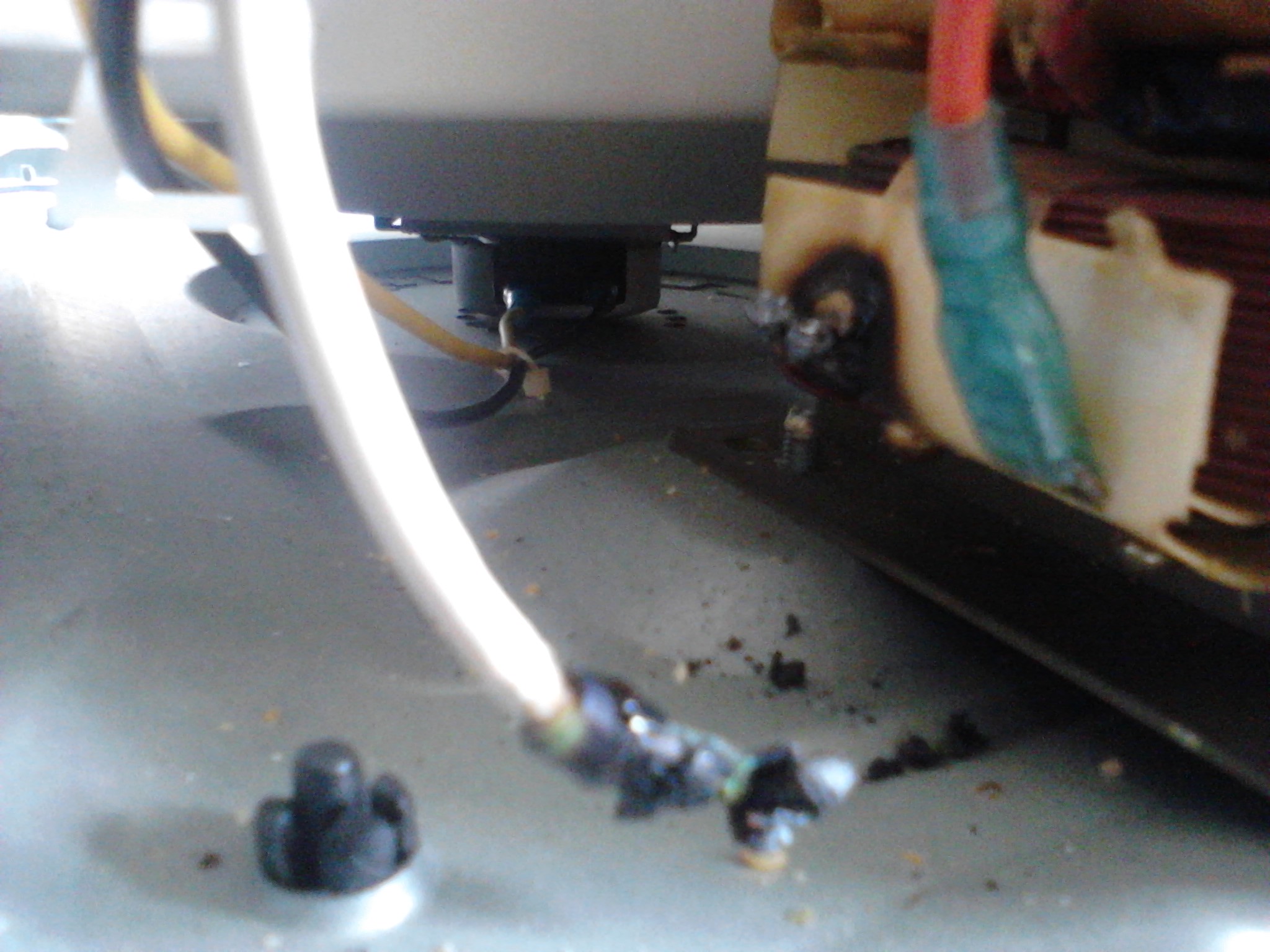

                And now my microwave has gone?
                It does everything it used to do but my food doesnt get warm?
                Bad day.

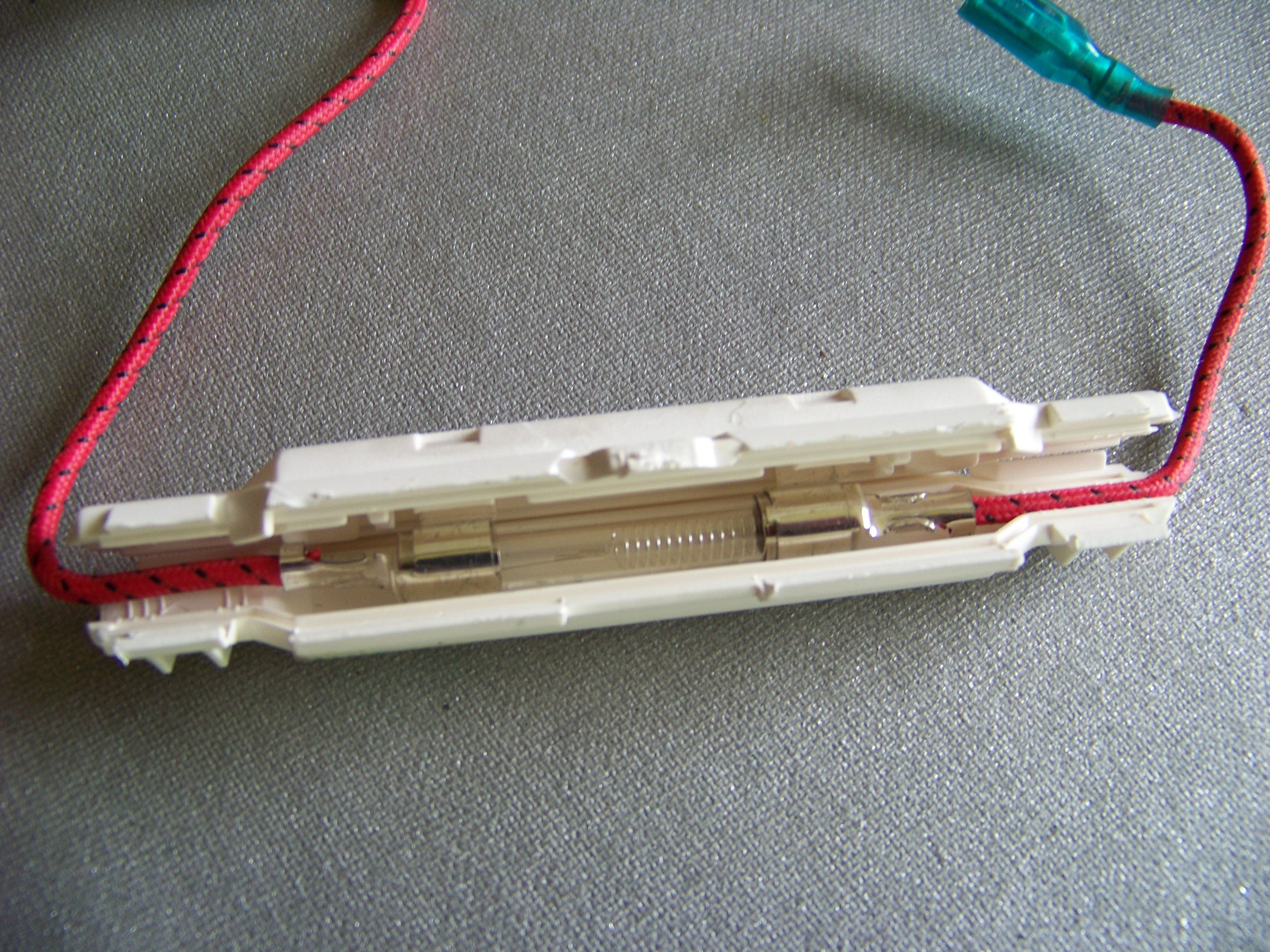

                  I have just fixed a microwave - perhaps the same fault?
                  Inside there are more fuses - I ended up getting mine from China
                  it is a 5kv 750ma. 40mm x 6mm - didnt realise it was a fuse at first as
                  it was inside an unmarked plastic case about 3 inches x .5 inch.
                  Wrongly is suppose , I jumped it first with an ordinary 1 amp fuse and heated
                  a small amount of water so I knew it would work before ordering anything.
                  Got it for free so didnt really want to spend a lot on it if the magnetron had gone.
                  Very careful if you go inside capacitor holds VERY VERY HIGH Voltage.

                      i have never seen a fuse on the hv side of a nuker.
                      that is more likely the rectifier.
                        Not sure what you are saying? its definitely a fuse.

                          90% of the microwave ovens I have come across have a cap, diode and fuse on the hv side.

                            selldoor posted before me and has proof of the fuse.

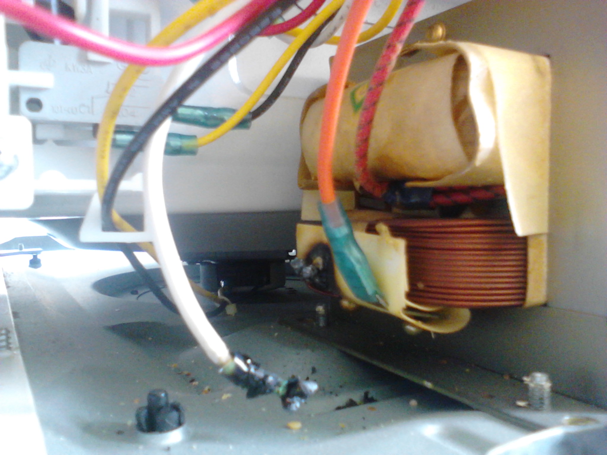

                              Pics of my poor microwave.
                              A connection has melted off the transformer?
                              This was a metal connection so solder isn't going to work.
                              Fixable or electronic heaven with the iron?

                                Well you have nothing to lose by trying. If it had been soldered in the first place
                                it wouldnt have come slack and burnt through.
                                What I would try is dependant on what you have left when you clean it up.
                                On the good connector is the spade connected to the wire by whatever the blob is underneath the insulation card?. If so and the blob on the faulty connector is still connected to the transformer winding in some way, then you could perhaps solder the wire onto that blob.
                                If there is enough of the spade left just solder it onto that.
