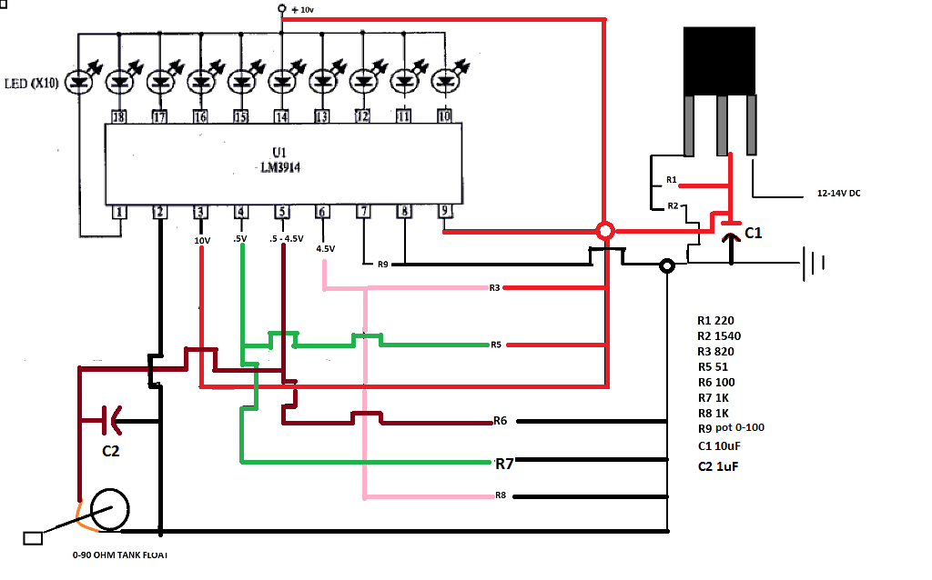

smoothing out voltage spikes and dips?
  • scampo77
    • Dec 2010
    • 233
    Re: smoothing out voltage spikes and dips?
    before this gets to far along it needs to be said that i will need to build a second one of these things that operates identically to the first. i was hoping to steal ref voltages and power supply voltages,

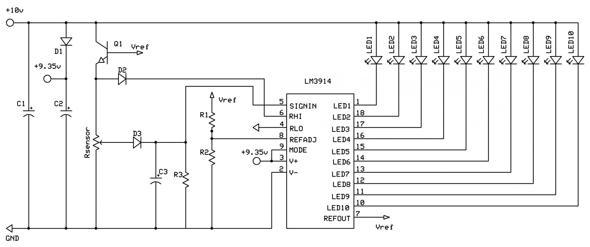

      I added a transistor into the circuit to amplify the Vref current capability, and added a diode so C3 won't discharge through the potentiometer.
      R3 is what discharges the capacitor, but the capacitor still could charge up almost right away, so it only solves half of the problem.
      I don't know if there should be a resistor to limit the base current on Q1, but I am thinking you could use a 2N3904 as Q1.
      The voltage across the potentiometer equals Vref-Q1vbe (I think)
      Could someone point out if I am going in the right direction or not?
        i have worked on this and to no avail. i am slowly adding caps and changing things but im still not 100% clear what i should be changing and doing.
        the diode?
        the 9.35v?
        do i change all my resistor values to match up with Ben7's diagram even though i cant change the 100 ohm float?
        i have re done my schematic (please be kind its my first time) it is easier to see what i have done and what i was thinking, with the colors.
            Originally posted by scampo77
            is this new diagram based on me keeping the Rsensor as a 0-100ohm float? and it is empty (one bulb lit up) at 5 ohm? and full (all 10 bulbs) at 85 ohm?
            Yes it is based on the 100ohm potentiometer. it should be like this: 1 bar-10ohm, 2 bar-20ohm, etc... the display is a 10 bar display so the readout shows approx. 10ohm per bar
            D1-D3 can be 1N4148, 1N4001, etc... just any regular diode
            D1 drops about 0.65v from the 10v source, making roughly 9.35v, that connects to the Vdd of the LM3914. The 9.35v is smoothed out by filter cap C2.
            For C3, use a 100uF capacitor, and for R3, use a 10k resistor, and see how it works.
              Hi Ben, what is the calculated Vref? 6V?
                Yeah, its still ~6v. I haven't changed the values of R1 and R2 yet
                  The transistor is hooked up as an Emitter follower, that means the Ib will be about 60mA if it does not have Base current limiter, just think of the Vref of the IC is a 6V regulator, if you have the Base connected directly to the out put of the regulator, the E-B junction and the 100 Ohms pot will be the load.
                  The pot that he is using based on the way his diagram is drawn, it looks like 2-pin pot, if that is the case, it means that the load will be varying from 0 ohm to 100 Ohms if it is not the 3-pin pot that allow you to tap the output at the wiper.
                  I am still not convinced on the accuracy of his wiring diagram to the actual unit.

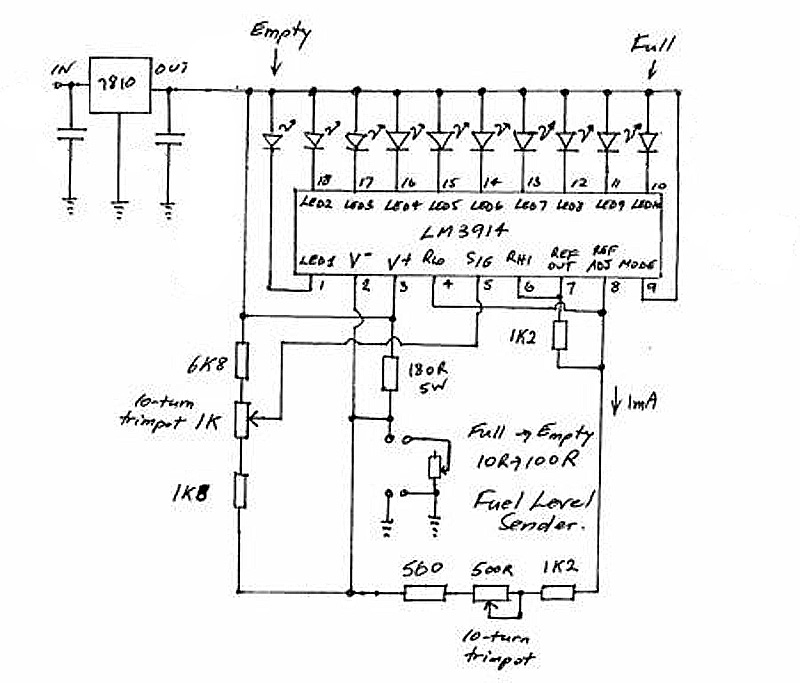

                    I would like to point out that the 100 ohm sender used is also the value used in a lot of automobile fuel tanks.
                    Gauges of this style are available from $10 - http://www.ebay.com/itm/200773320938
                    There are also plenty of circuits on the net showing how to use a LM3914 with a 100 ohm sender for a fuel gauge. The one below includes trimmers for setting the high & low readings.
                      It does not make sense to have PIN2 (Ground) IC tied to B+ with 180 Ohms 5W resistor (wasted power, that 180 Ohms will have 10V on it when pot is at 0 ohm) and return to ground through ground through the variable 100 Ohm pots (the pot will dissipate power also), all the LED return current will also be flowing through pin2 of the IC. The SIG input pin is just looking for the Voltage input to compare it the the resistor string of the comparator ICs. Using the 100 Ohms or any value is not the problem.
                      I wonder if that circuit was actually built and tested.
                      When ALL LEDs are on, there will be about 100mA flowing out pin 2, and there will be voltage drop on that pot which will vary and depends on how many LEDs are on so the the Rhi value will keep on changing so as the the trip points of each comparator, it looks like a mess with pin2 ground connection like that.
                      The SIGNAL pin is also being fed by voltage that is set by the TRIM POT instead of sensing the variable voltage from the sensor signal.

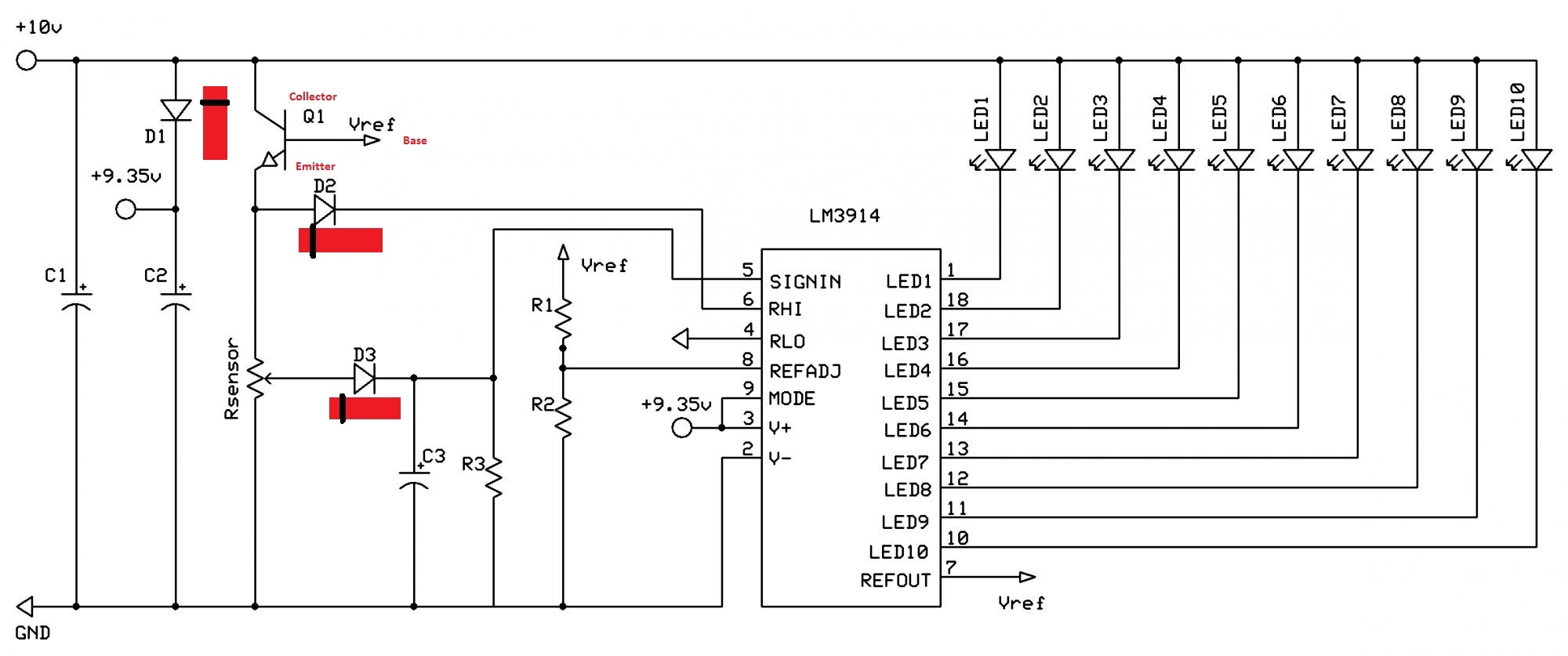

                                      again i am very very new to this and would like just a bit of reassurance that what im not putting the diodes in the wrong direction or the transistor in upside down
                                      i drew on this picture the way i understood it
                                          Well that circuit will not work with your Rsensor since it is just a variable resistor not a 3-pin voltage divider type. Pin 4 Rlo is connected to ground.
                                          That is why I ask if the Rsensor is 2-pin or 3-pin type.
                                          May I ask what kind of setup you have before, before you want to use this LM3914 circuit.
