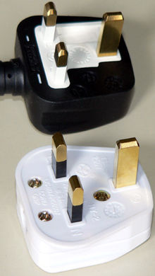

            For the record, I once saw a circuit board labelled "RoHS" that was soldered with ordinary leaded solder. It was in a cheapo PSU with a seized fan though so fake RoHS was the only good thing about it.
            Oh yeah, health and safety. Despite being in Australia, I stumbled across a North American type IEC cable. They really need to get rid of that too since on the plug I'm looking at, there's all of 3.5mm from the outside edge to the pins. Which aren't insulated even today. Nice job, NEMA .
            For the record, my favourite plug design is BS 1363 with massive pins (a prime example of overengineering), mandatory shutters, and built-in fuses. In case you're wondering, I do have (multiple) BS 1363 cords too. Which plug is your favourite???

                      Yeah, it is a very good standard, the plugs/sockets are polarized and are very safe especially compared to the basic plugs used in most of Europe.
                      The only drawback is the size/shape of the plug - it's very awkward and makes it hard work when packing in a small case for a portable device.

                        Re: Overengineering
                        Since the UK plug has built-in fuse, do they install the Time-delay, or fast-blow type fuse, current rating?
                        Is the Neutral also bonded to Ground at the panel?

                                    Re: Overengineering
                                    There are five current ratings for the fuse: 1A, 3A, 5A, 10A and 13A; but the most common are 3A, 5A and 13A. The fuse is intended to stop a ring circuit overload or a plug overload which would not be stopped by a breaker.
                                    Nope, but it is bonded at the substation or sometimes the electrical pole. In our house earth measures 6VAC relative to neutral, so the bonding is probably very close.
