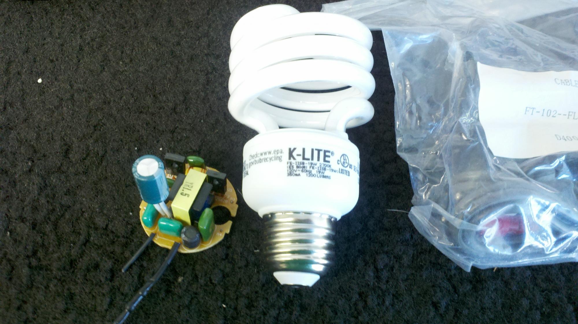

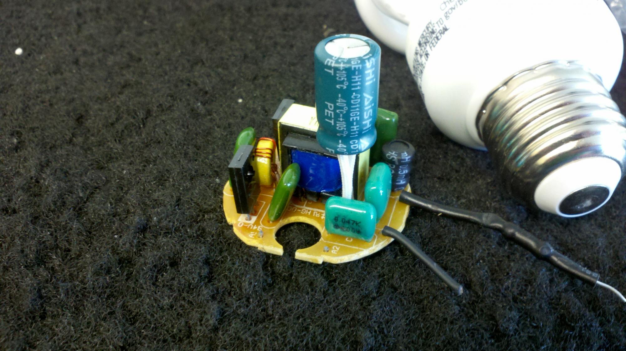

      had a cheapie at the shop start singing and flickering yesterday.tried to open it up but broke the tube.its 2 months old and the lytic read 17 ohms esr.
      the board is brown around the transistors.i expect the others to die soon.
      i cannot take flicker or buzzing/squeeling so they will come out as soon as they start.
      if i hadnt broke it the other may have been ok with a new cap.
      the original is an aishi.

        Re: Cheap CFL teardown after failure
        My dad recently got a cheapie one too, and put it in, it takes like 4-5 seconds to start up, and it buzzes quite a lot. Its very dim at startup too. I wonder what quality parts are in this one...
        Have any pics?
        PS - use a small saw to cut open the plastic base, instead of trying to pry it open.
        -Ben
          mine is a k-lite.
          the other one in the fixture had a hard time starting this morning.
          got frost last night and we shut down the furnace for the season.about 60f in here.
          high esr cap most likely.
                  fuse resistor in shrink tube in power lead.
                  have a ton of rubycon ssp? 33@250v on hand so i tried one in the one i got apart.
                  it worked fine.not enough room for it but it proved the cap is the problem.the second ones cap was 15ohm esr.
                  junk cfl like these set folks against them all after this sort of failure.
                  methinks these 2 shop bathrooms are going to get old 3' preheat fluorescents in place of these cheesey 3 bulb fixtures.
                  thats the only reason we used cfl's.
                  i am finding most are pure junk.

                    Aishi CD11GE datasheet:
                    Specified life 12,000 hours
