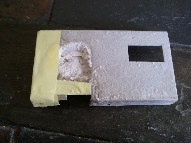

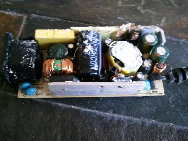

    As some of you may know, I work at a burger king. Today one of our credit card machines went down as the power supply sat in a puddle of water on the ground for an extended period of time and stopped working. We replaced it with a unused power supply from an unused credit card machine and everything worked fine. I took home this power supply to see if I could get it working again, and this is the horror I was confronted with when opening it:
    Holy.
    Butt.
    Nuggets.
    I sprayed down the PCB front and back with Simple Green and soaked the case in vinegar and wire wheeled the corrosion off of anywhere that had it, and it starts up now.

        Most of it looks like mineral deposits from hard water or water with chemicals (cleaners) in it.
        If the casing is aluminum it might be aluminum oxide.

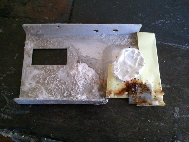

          Yeah it's all just corrosion. The brown stuff is the aluminum corrosion mixing with the rust from that little bolt that holds a diode to one of the heatsinks. I just thought it was funny that this came out of a burger king. Kind of impossible for it to get grease in it, as it sits on the other side of a huge stainless steel wall that keeps the fryers out of view.
