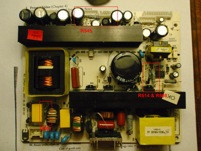

    Hey folks, been reading on the forums for a couple months now. Thanks for all the helpful posts. Now I have a question...
    I recapped an Insignia 667-32HA37-20 power supply. The power supply has a heat issue and I found 4 resistors out of spec.
    How do I determine the correct type of replacement resistor to order? Should I order wirewound, metal film, ceramic, etc? Also, I don't know the current drop so how can I figure out the correct wattage? Do I just measure the resistor width?
    The resistor locations and proper values are:
    R545 0.27 Ohms +/- 5%
    R508 91.4 Ohms +/- 0.25%
    R514 42 Ohms +/- 5%
    R501 22.5 Ohms +/- 5%
    Thanks for your help.

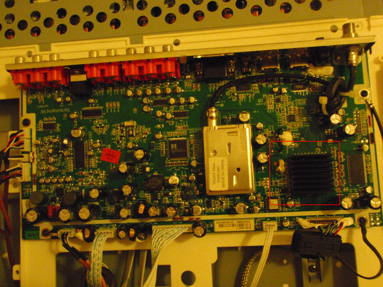

      The issue:
      The tv powers on and works fine for an hour or two then it shuts off. It has to cool down then you can repeat the process. Two of the resistors measure out of spec by 5 orders of magnitude (MegaOhms instead of Ohms)...
      R508 - white/brown/yellow/gold/blue - 91.4 Ohms 0.25%
      R501 - red/red/green/gold/blue - 22.5 Ohms 0.25%
      The other two (0.27 and 42Ohm) might be okay, but at least the 42 Ohm resistor measured 45.5 Ohms - slightly above the 5% upper limit.
      What's the best approach to determine a suitable replacement resistor (both type and power rating)?
      I will hit it with freeze spray and measure the output voltage as it heats up. My hunch is that the voltage varies inversely with temperature - but I'll take some readings to verify.

        Are R508 and R501 reading that low out of circuit? Just looked and those are correct values. http://samengstrom.com/15924820/en/r...or_Color_Codes This works great. Just start clicking the color bar.
        • daimoku
          • Feb 2011
          • 85
          Re: Suitable resistor replacements?
          Yes, R508 and R501 are giving MegaOhm readings instead of Ohm with one leg of each resistor removed from the circuit.

              I think there's something wrong with your reading of the color codes.
              Going by the old(er) codes:
              white-brown-yellow-gold is 910kΩ ±5%
              red-red-green-gold is 2.2MΩ ±5%
              I know that they present as 5 band, but 4 band with those readings makes sense.
              If those 2 -supposedly- low ohm resistors had gone that high, I don't think the supply would be working at all.

                Thanks Toast - you're exactly right.
                I didn't suspect the power supply would be working if that was the case either that's part of the reason I was confused. The resistors are within spec using those values.
                Guess I'm back at square one haha
                    +1
                    Moreover, the value for R501 makes perfect sense, since R501 is in parallel with the two safety X caps (yellow square blocks). Many power supplies use a resistor in the MegaOhm range for that spot.
                    As for the 5-band color codes on the resistors of your power supply - it probably indicates reliability (or something like that).

                        Alright, I spent 30-40 minutes last night tracking down the real source of the overheating problem. The overheating problem is with the GPU/CPU or whatever chip is located under the heatsink on the mainboard (picture attached).
                        I don't have an oscilloscope, but the crystal oscillator is making a scratchy noise. If I hit the oscillator with some freeze spray, it quiets down for a few seconds then starts right back up.
                        Since the heatsink is epoxied on, I don't have a good solution for repairing this problem.
                        Any advice other than sit there with a can of freeze spray? haha If there's not a good solution, I may just part the TV out.

                          • New Zealand
                          Replace the crystal?

                            Would a crystal cause the CPU/GPU to overheat?
                            • Agent24
                              I see dead caps
                              • Oct 2007
                              • 5038
                              • New Zealand
                              If it's making a weird noise it may be broken or running at the wrong speed.
                              If it was running too high it may be overclocking the CPU and causing overheating?
                              I don't really know, but your post seemed to suggest the crystal was faulty.
                              -David VanHorn
                              • daimoku
                                • Feb 2011
                                • 85
                                Good point. That makes sense it would overclock the processor and cause the overheating issues. The scratchy noise does seem to suggest it might be faulty.

                                    Found some bad caps on the main board too. Gonna order some replacement caps and an oscillator.
                                    The oscillator says H25.000M. Does that mean 25Mhz and are there any other specs I need to keep in mind?
                                    Also, is orientation important for crystals? I forgot to denote the orientation before I removed it. I know I probably should have replaced the caps first then tested the board, but I wasn't thinking clearly (cold medicine lol)
                                    • Agent24
                                      I see dead caps
                                      • Oct 2007
                                      • 5038
                                      • New Zealand
                                      Sounds like 25Mhz to me., especially with the M on the end.
                                      Orientation is not important as far as I know.
                                      You may have to worry about load capacitance, if you get this wrong it could throw the value off or prevent oscillation.
                                      The usual load capacitance is 12pF I think...
                                      Other thing may be if the circuit expects a very accurate crystal, like resistors some are more accurate than others.
                                      Best thing is try to get a schematic so you can be sure..
                                      And of course, if clearance is an issue, don't get a tall crystal where only a short one will fit, and done get SMD when you need through-hole or vice-versa.
