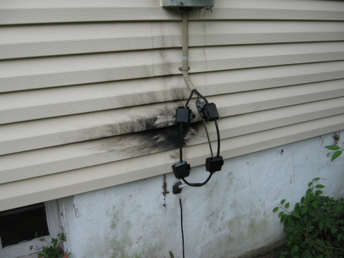

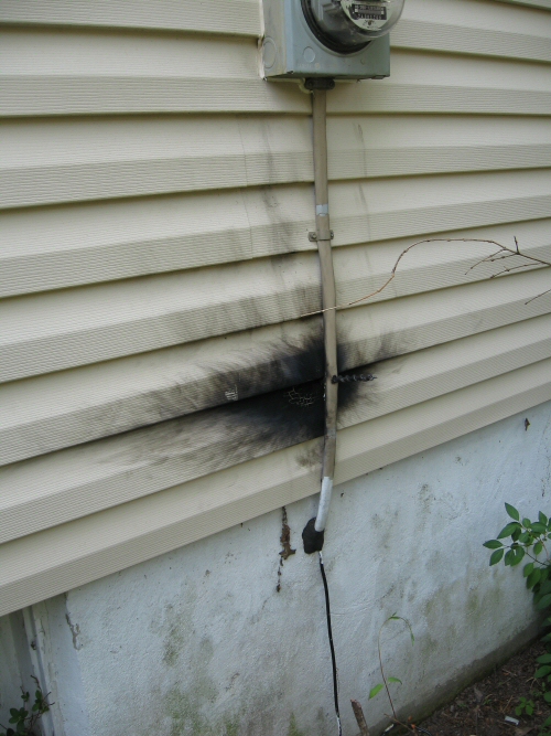

    I'll keep this quick as i forgot to charge my laptop and i had to cut the power.
    We had an alarm system installed some years ago in our apartment. Since a few weeks we've been hearing sparks in the fuse box and called the electrical department. They were supposed to come today. Typical of them, they didn't.
    It started again tonight so i got a chair and climbed to the fuse box to shut some of the stuff down. I flipped the wrong one so i flipped it back, and as soon as i did that i saw the wiring in the wall catch fire.
    Needless to say my reaction was to throw the main breaker instantly and the orange glow faded out. Upon close inspection with flashlight it turns out that the security firm who installed the alarm put it before the main breaker with one of the ugliest wiring jobs i've ever seen. The wiring couldn't cope with the demands of the washing machine and melted over time. And it was damn near catching fire. I wonder, do those security guys also sell fire insurance???
    Also the wiring is before the power meter and fuse box, so if the electrical department doesn't come tomorrow i can fix it myself without losing any warranties.

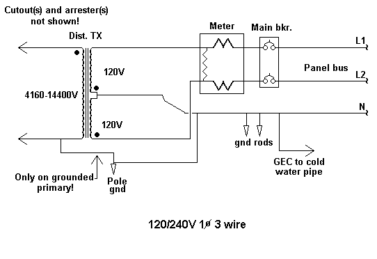

    Your line voltage is 240V, single phase line-to-neutral? Despite what other sources say, we do in fact have 240V here. Resi neighborhoods are usually 120/240 single phase. The 240V secondary of the distribution transfomer has a center tap that is the neutral. Grounded at the first disconnect. In a sub panel, neutral and ground must be separated.
    The baby stuff gets 120 from either end of the transformer to the neutral and things like electric dryers, ranges, large power tools, condensing units go across the whole secondary. An open neutral is bad news
    Diagram does not apply to 120/208Y 'network' service, as used in metro areas, condos, apt. complexes, etc. And the old delta services were neat- the very same single phase service for houses AND three phase for commercial, all off the same transformer bank! Don't try to get 120 off the high leg!
    Just so you know, the POCO will be hesitant to touch anything after the meter. After the meter is your responsibility, at least in the US.

          I'm now back up and running. But it'll be fun so keep reading. The electrical department came and said "it's not our job during program hours" (they probably wanted to be paid for the job). So if we have to pay someone, at least let's pay someone we can trust.
          We called a trusted family friend who did most of our house electrical when we renovated the apartment. He fixed it, and the actual cause will baffle you. I don't remember why but the alarm guys had to move the doorbell. Here's the good part. They had drilled a hole to screw the doorbell. RIGHT THRU THE PLASTIC CONDUIT THAT CARRIES THE POWER WIRING. The screw almost hit a phase wire. The doorbell body is sitting on neutral, and the normally open outside switch closes the phase circuit.
          You know wires can move when a sudden load is applied. Well, it all started when i accidentally shorted the mains a few months ago, and tripped the breaker. I guess that the surge moved the phase wire just enough to touch the screw under certain conditions... And the potential for a short was created. The burning wire i saw was just a side-effect of an intermittent short between phase and neutral! That's gotta be one of the craziest things i've ever heard about mains wiring... and it happened to me.

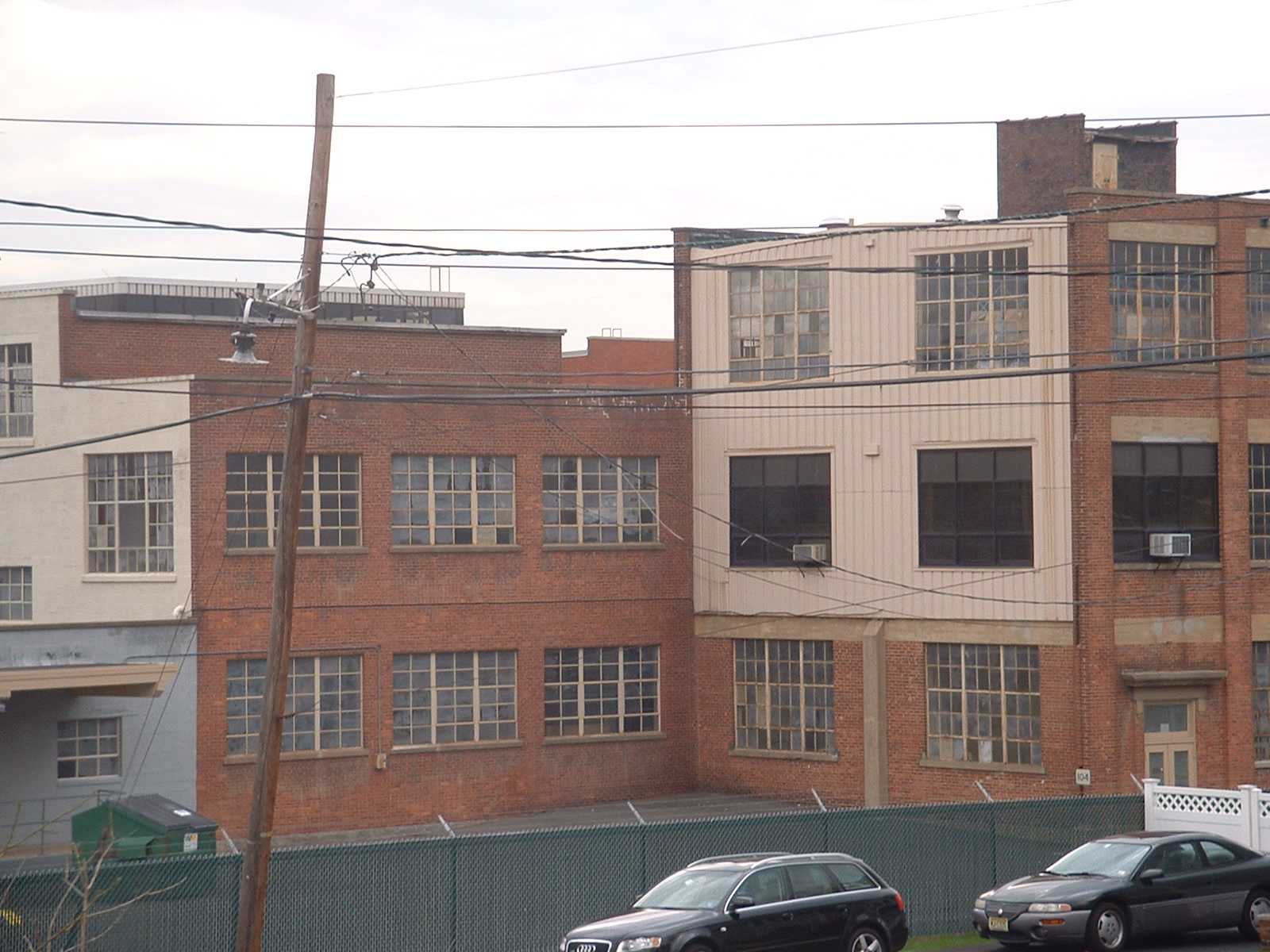

              Reeal niice... unlike some places where you have one 25 or 50kva pole pig for half the block AND the secondary bus is too small/long, like say in Nutley, NJ. The 69/13.2 sub is just a few blocks away...
              What a bit of serendipity I live in Nutley. Sounds like the setup on my block to a T. I always thought transformers were a bit scarce.
              Up until 06 or so we still had old school probably 50s incandescent street lights before they finally upgraded us to low pressure sodium. So I'm not holding my breath about the age of their power distribution infrastructure. At least on my block it probably was designed when people still had 60 amp service panels.

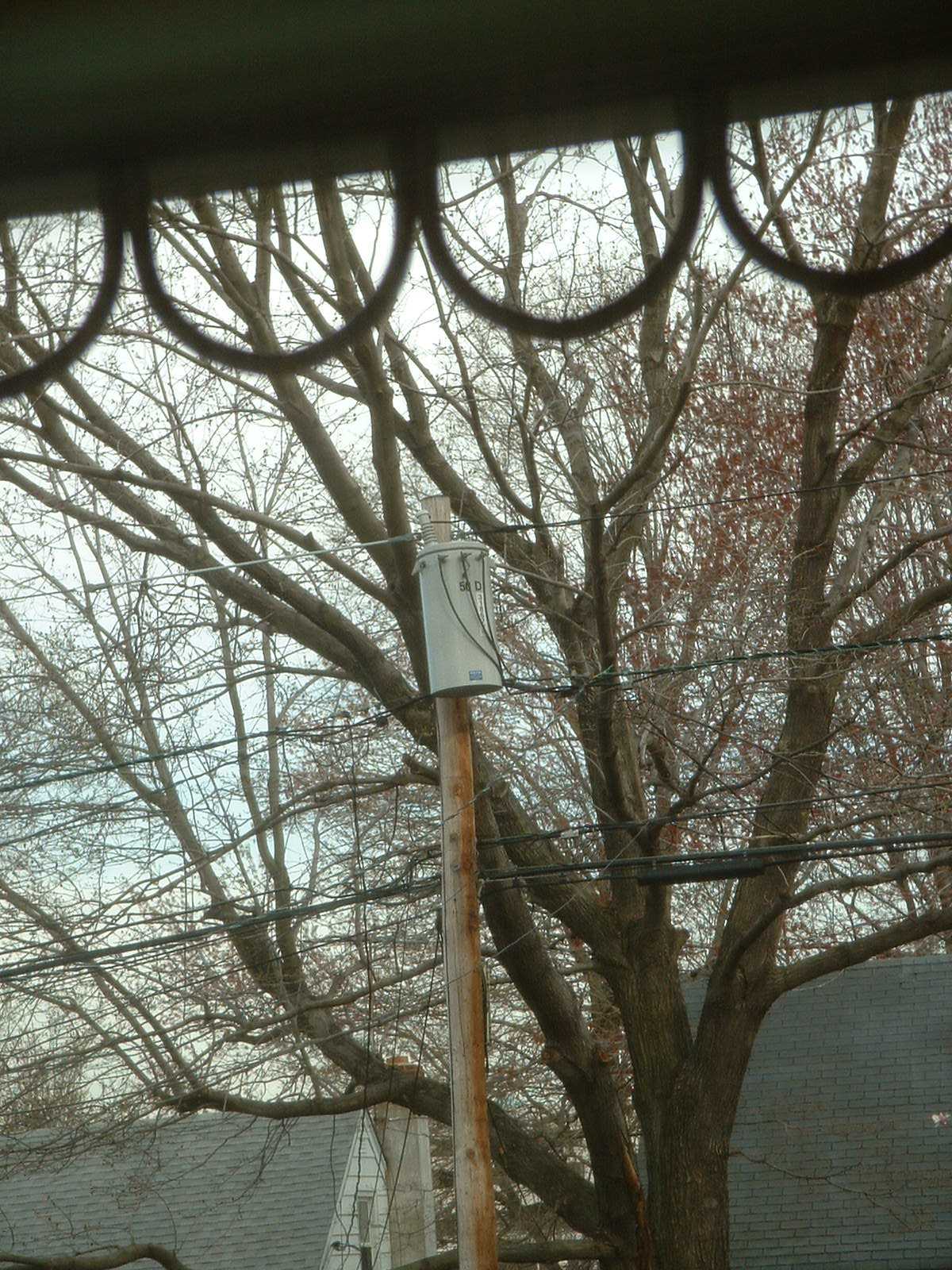

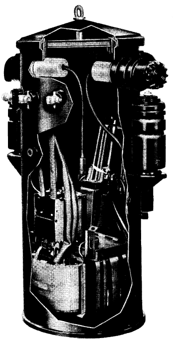

                My grandma and grandpa on my mom's side lived on a block, where there was ONE transformer for the _whole_ block. This was the typical Nutley 50's development. All but two of those ornate streetlights are gone. The one at the end of the block was converted to HPS probably 20 years ago. I think the other one was, but was further up the block and I was too lazy to look at it. Poor old things need a good restoration...
                As people got more appliances, window and central A/Cs, that poor gray Westinghouse pot couldn't take it. Not sure if it was a CSP or what, but we both know that PSEG thinks fused cutouts are 'not necessary.' Anyway, every summer, every few weeks, occasionally days, they'd lose power for as long as 5 hours. "Did you check your breakers," they told grandma when she called. IT'S THE WHOLE BLOCK! And the next block over had power...
                About ten years ago, a 50kVA was put up right in front of the house. All the 'complaints' from old people 'messing with their panels' mysteriously stopped.

                  Actually recently near my school an old transformer blew up, it was maybe like 40 years or so old. I didn't get to see it, but it was underground. Not far from my school too is a cool PSEG substation with these HUGE transformers that can be heard within 300 feet of them humming loudly
                  The fuse panel in my neighbors house shorted, caught fire, and almost burned her house down. The power transformers that supply her house (and like 10 others) are hooked together, one 50kva and one 25kva. Well the 50kva was the second of the same mfg to fail on my street, and it failed under the big short. Poor little 25kva has its red overload light-which is to the left of the LV bushings-on and must be very hot. It still is overloaded and I hope to contact the electric company soon.
                  The other 50kva failed during a big heat wave with temps up to 110F!
                  And it was powering my house. All of a sudden the power went off, and I found the transformer to be dead with a tripped CB. Called PSEG and they came out and couldn't get the transformers CB to reset, so they wired us into another nearby transfo temporarily. They came late at night and put up new 50kva chinese transformer. Can't wait till that one fails lolz.

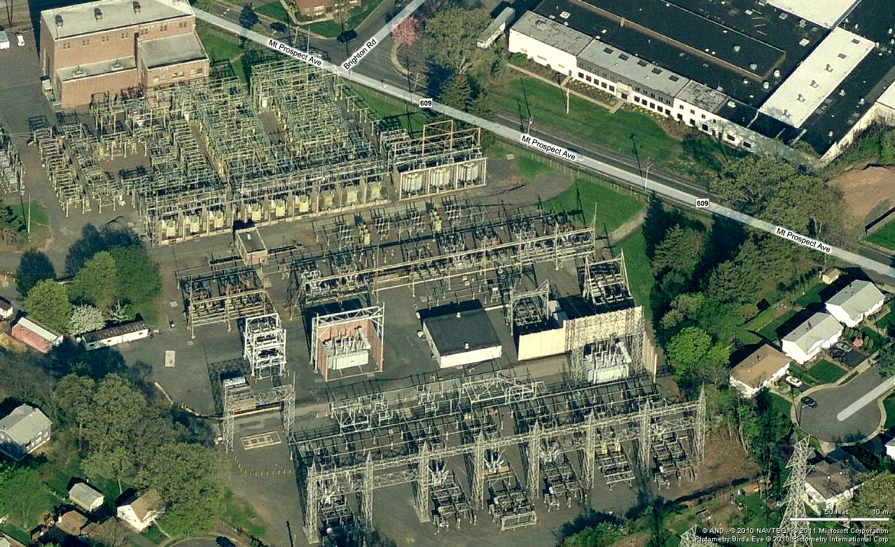

                        The high school here has a hell of a 480/277 service, with CT/PT primary metering. The metal clad switchgear is close to a riser pole, where the primary's taken. Secondary goes underground for ~300 feet. Chillers, etc are 480, air handlers and lighting 277. Contactors for MH lights in gym. Multiple step-downs for the 208/120. 'Puters and receps 120, of course. Steamer/warmer trays 208 3ph. Dimmers in the auditorium are a hefty 120 load. Not sure what size the service is.
                        Have you seen the sub at Van Houten and Mt Prospect, Ben? Old enough to use groups of 3 single phase pots instead of ones with all three phases in one tank. Looks like it was generation, too. Old Westinghouse stuff fo' sure!
