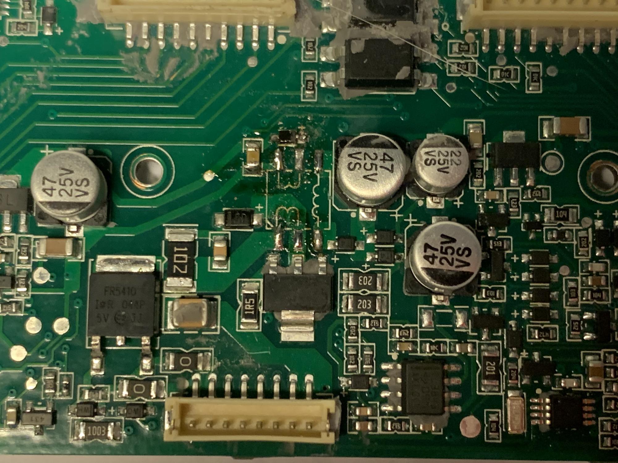

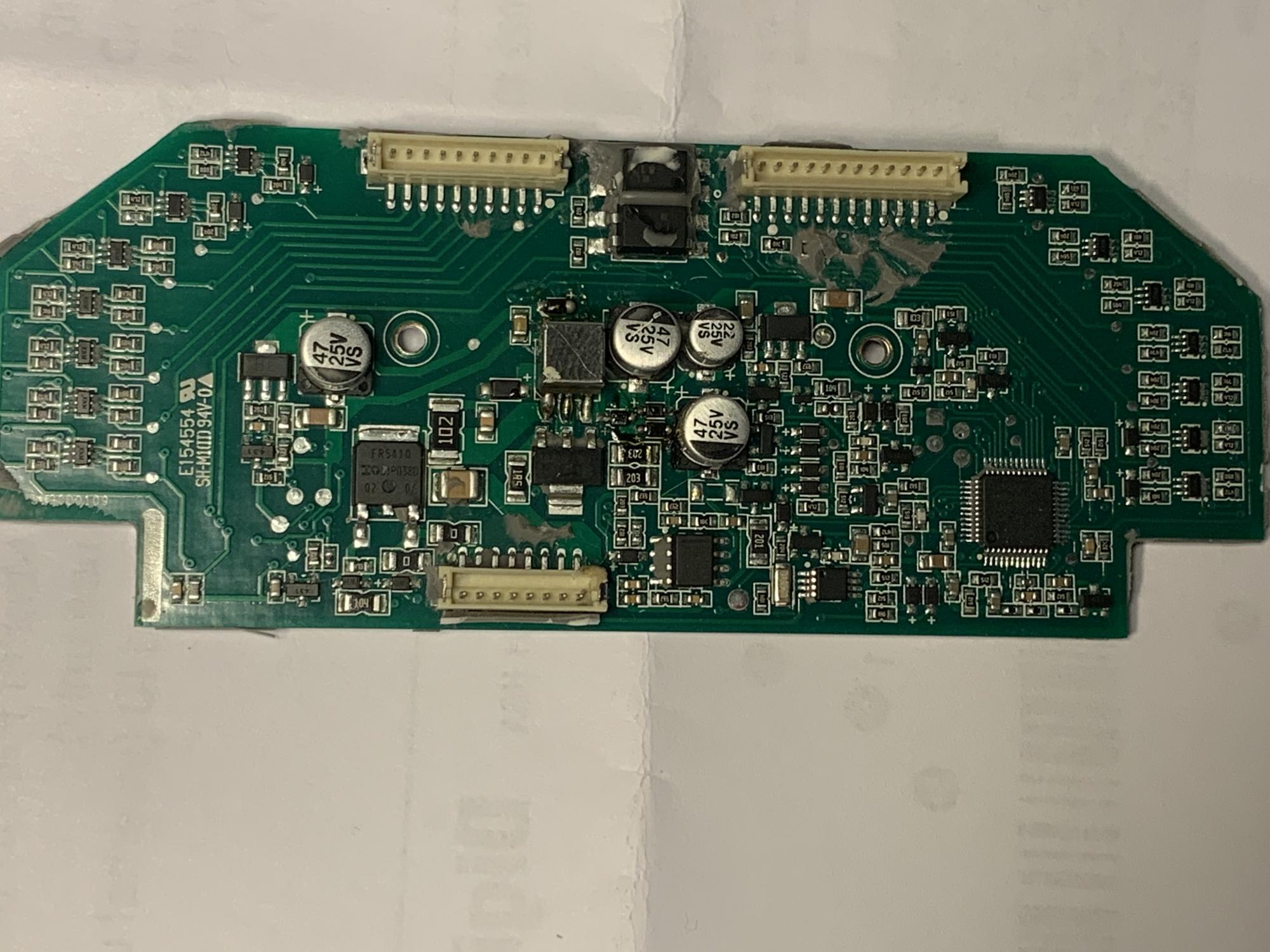

    Hi
    I have 4 ego 56v power tool batteries where the BMS battery management board is dead. I believe I have narrowed down the problem on all 4 to a transformer coil on the board. There are no markings whatsoever on this coil. How would I go about trying to identify it? Thanks.
    I'm attaching a couple of photos for starters. The first shows the entire board with the component in question (silver square 6pin device next to caps).
    The second photo shows the board with the transformer coil removed.
    Any help is greatly appreciated.

      Re: Help me identify this BMS component
      The two top connectors attach to the 14 cell packs (individual cell monitoring) plus wiring for two thermistors.
      The bottom connector attaches to the battery contacts (negative and positive leads plus T terminal plus D terminal.
      The coil in question is involved in the circuitry that drops 56v to lower voltages to drive the BMS (12v, 3.3V etc).
      I can also attach another image of an older version of this BMS, which has more labels on the board.
        Here is an image of an older version of the BMS board with more labels:
          I took a chance and ordered this coil from digikey:
          https://www.digikey.ca/en/products/d...0926NL/2265652
          It looked similar and dimensions were correct. It had a slightly different pin out, but long story short, it did not work in this application.
              Originally posted by R_J
              What was wrong with the original transformer? it is unlikely it was bad unless it was physically damaged.
              For some reason this coil component is a common failure, especially in the newest ego batteries with the fuel gauge. One of the 3 coils tends to short or open up.
              In my case, the 3 coils do not appear to be shorted or open, but resistance values differ slightly from working coils.
              If I install a coil removed from a working BMS, it restores functionality.
                  bms transformer by the looks of it .
                  see if you can match it .. https://www.digikey.bg/en/product-hi...t-transformers

                      Based on my second photo in the 1st post, I can see that pin 1 (bottom left) has a coil connecting to pin 2 next to it. Pin 3 has a coil connecting to pin 4 across from it. Pin 5 has a coil connecting to pin 6 (top left and middle pins).
                      I'm not sure how to interpret coil schematics in the datasheets to find a similar profile.Closest I could find was the pulse electronics device i linked to above, but it didn't work...
                        measure the inductances of a good one . a schematic would help but i know with these things its not going to be available .

                                    I noticed that, on the BMS board, the 3 coil symbols each has a (-) designation at one end, which would seem to indicate a polarity. How does this factor into identifying a suitable replacement part and installing that part?
                                    • braxton
                                      • Nov 2009
                                      • 146
                                      I guess a more general question is:
                                      What is this transformer exactly doing in this configuration? What is it’s purpose in this BMS?
                                      In a working BMS, the low voltage circuit turns on when the battery gauge button is pressed, or when the battery is used in a tool or charged on the charger. When this circuit is activated, pin 1 of the transformer (bottom left in first photo) reads approx 55v, pin 2 reads approx 54v, pin 5 reads approx 3-5v and pin 6 approximately 3-5v. Pins 3-4 measure in the mVs.
