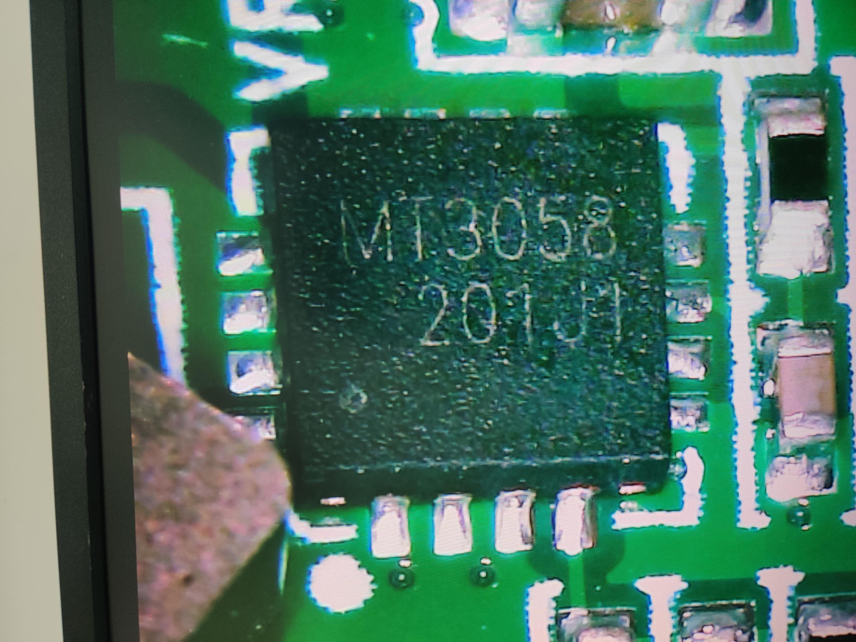

    Hi guys.
    I need to source an IC made by M3Tek (I believe its part of MetiaTek), IC number is MT3058.
    It's a step-down converter for a Ubiquiti U6-LR.
    There is literally zero info on the internet about this, nor any datasheets.
    Probably an NDA has been signed.
    Or if any of you know if a pin-to-pin direct compatible IC.
    Thanks.

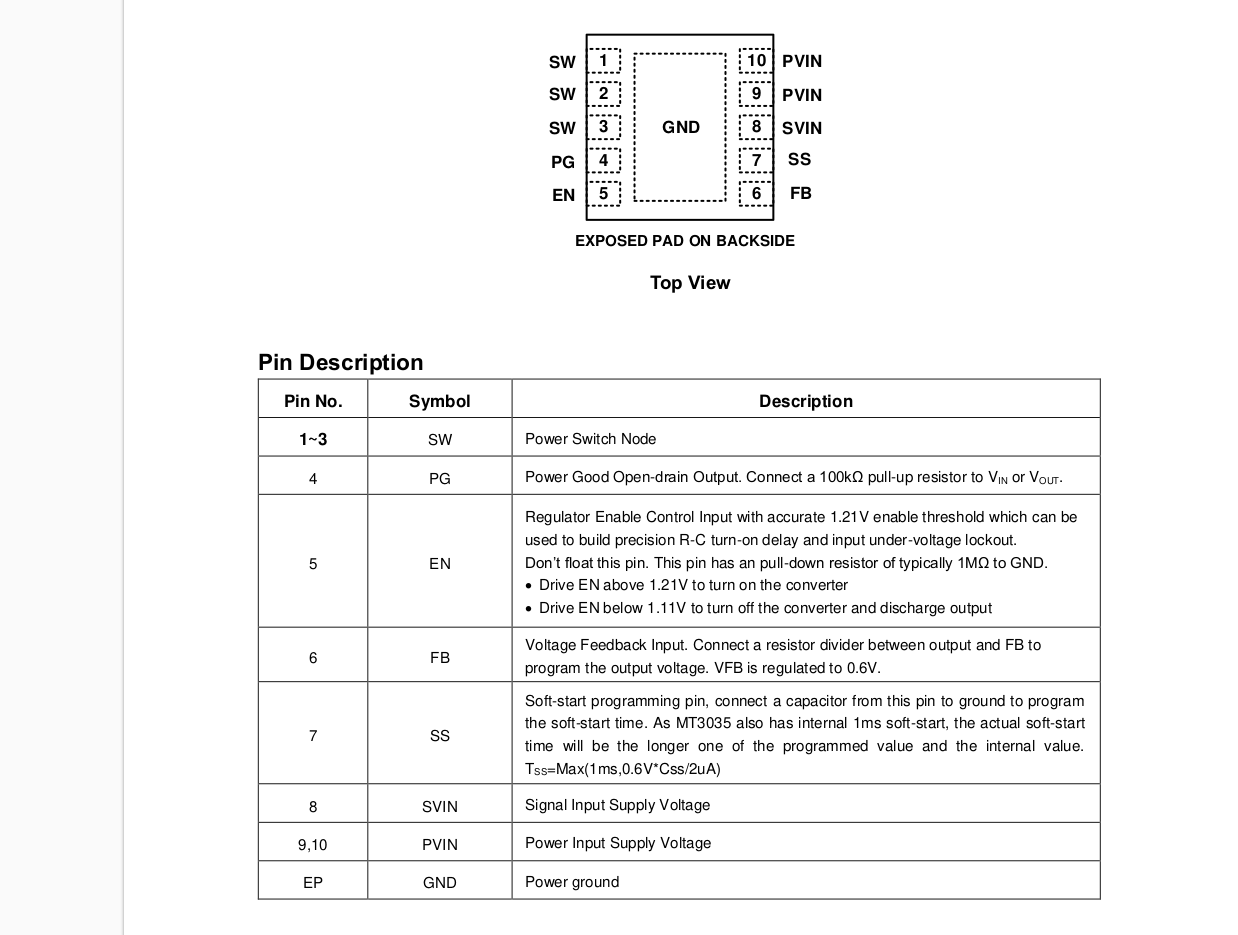

                Re: Help sourcing an IC number is MT3058
                Thanks guys.
                Datasheet has no pinouts.
                I'll see what I can do.
                  pinouts are there on page 2 of datasheet
                        That doesn't match the actual item pinout. See picture I have attached.
                          shit sorry my eyes saw 3058 but its 3035 i downloaded .
                              Looking at the footprint, voltage, amps, MHz etc, the next best thing I found is this. But I doubt the pin functionality is a match. Make or break LOL.
                              RT8058
                              https://cdn.badcaps-static.com/pdfs/...da256f890a.pdf
                              What you reckon guys ?

                                There is a MT3125 which might be similar, it is a qfn 3x3 16 pin the only other similar one they list is a MT3123 but has no pinout.

                                  There is a MT3123 which might be similar, it is a qfn 3x3 16 pin
                                  Thanks. It the footprint pins is different than what's on the PCB.

                                      Looking at the pad connections, this actually looks like a compatible one. Very nice find. I'll try it and let you guys know. Thanks!!
