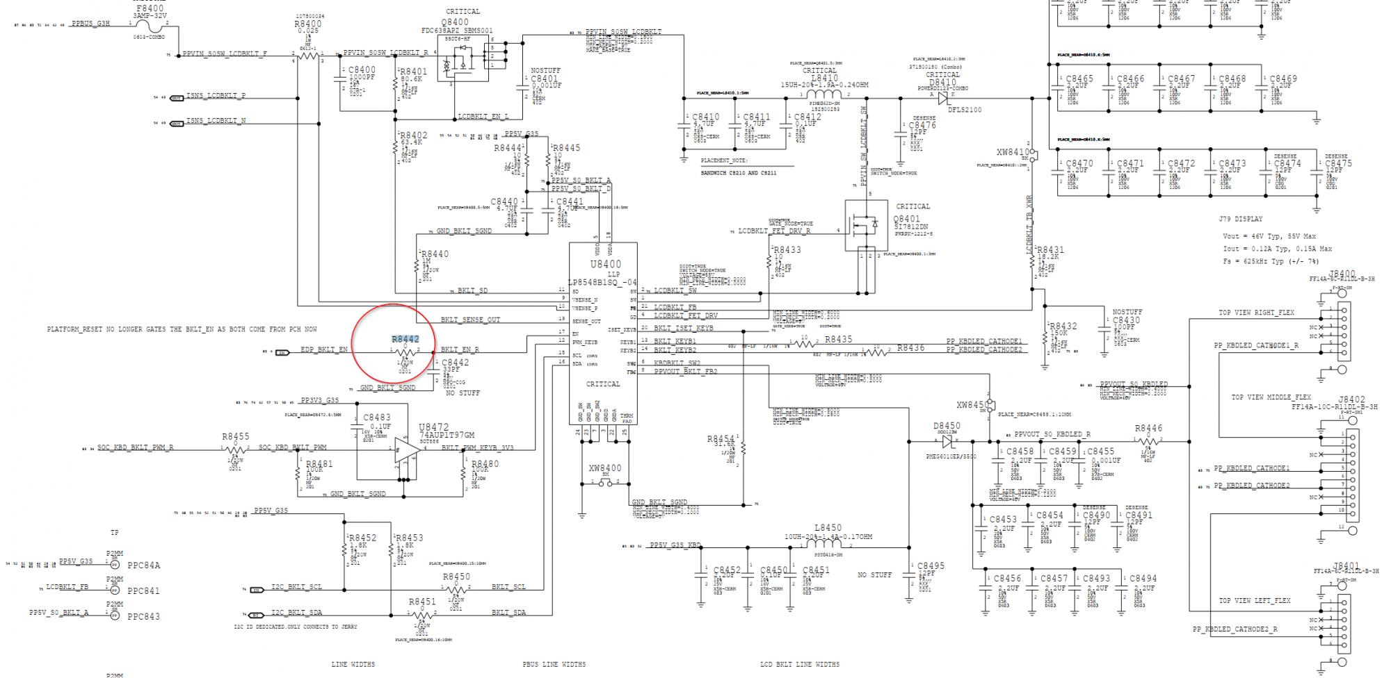

    What size is this resistor?
    I'm used to seeing impedance specs which I understand, but I'm not understanding anything about this resistor besides the package, 0201. For reference, this is beside the backlight driver on A2289 macbook, board 820-01987.

      You need to show context in the schematic. I think it's just a 0Ω dummy shunt/jumper.
      • survivalbloke
        • Aug 2021
        • 309
        Re: What size is this resistor?

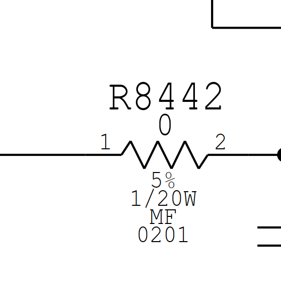

        Sorry - here you are!

          It's a 0Ω resistor. LP8548 boost converter for LED backlight requires at least 1.2V on the EN pin to turn on.

            it's pretty clear to me.
            0 ohms
            1/20th of a watt - would of been nicer in decimal, fucking apple!
            5% tolerence - cheapest variant, fucking apple!
            MF Metal Film - none of that carbon bullshit
            0201 = too small to work with unless you have a microscope!
