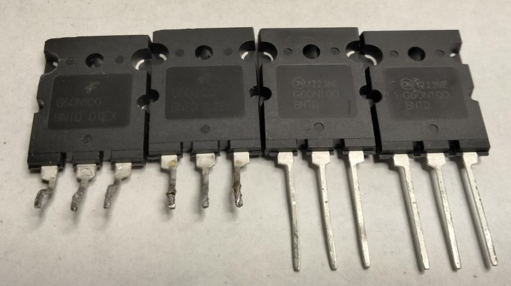

                                        Finally got replacements from China.
                                        I was a bit suspicious about the picture of the IGBTs that I bought off of fleabay but now I know why the photos were suspicious. I thought I was buying Fairchild branded units (which were the originals) but I got post merger On Semi units...
                                        I think they look good enough... at least I hope I didn't get fakes.
                                        Going to wait for a rainy day to put them in, the FDPF18N50's are still working however. But I think I'd rather have the G60N100 IGBTs installed instead of the tiny MOSFETs (or the tiny IGBTs), even better when the G60N100s at least have a metal back plate whereas the FDPF18N50s are plastic all around. I hope that the noise emission also goes down with the slower IGBTs, not to mention that they will be balanced with the two remaining working IGBTs.
                                        Just so suspicious the old IGBTs had no failure marks on them, Still look fine, just shorted all the way.
                                        While we're at it, MOSFETs are easy to parallel unlike BJTs. However, how about IGBTs? On the datasheet it says IGBTs are "easy to parallel" but is it?
                                        (as an aside, I happened to have gotten the FDPF18N50s from the same seller as the G60N100s.... probably by coincidence. Hoping that if the 18N50's lasted these few days as temporary fixes, the G60N100s should also last a while...)
