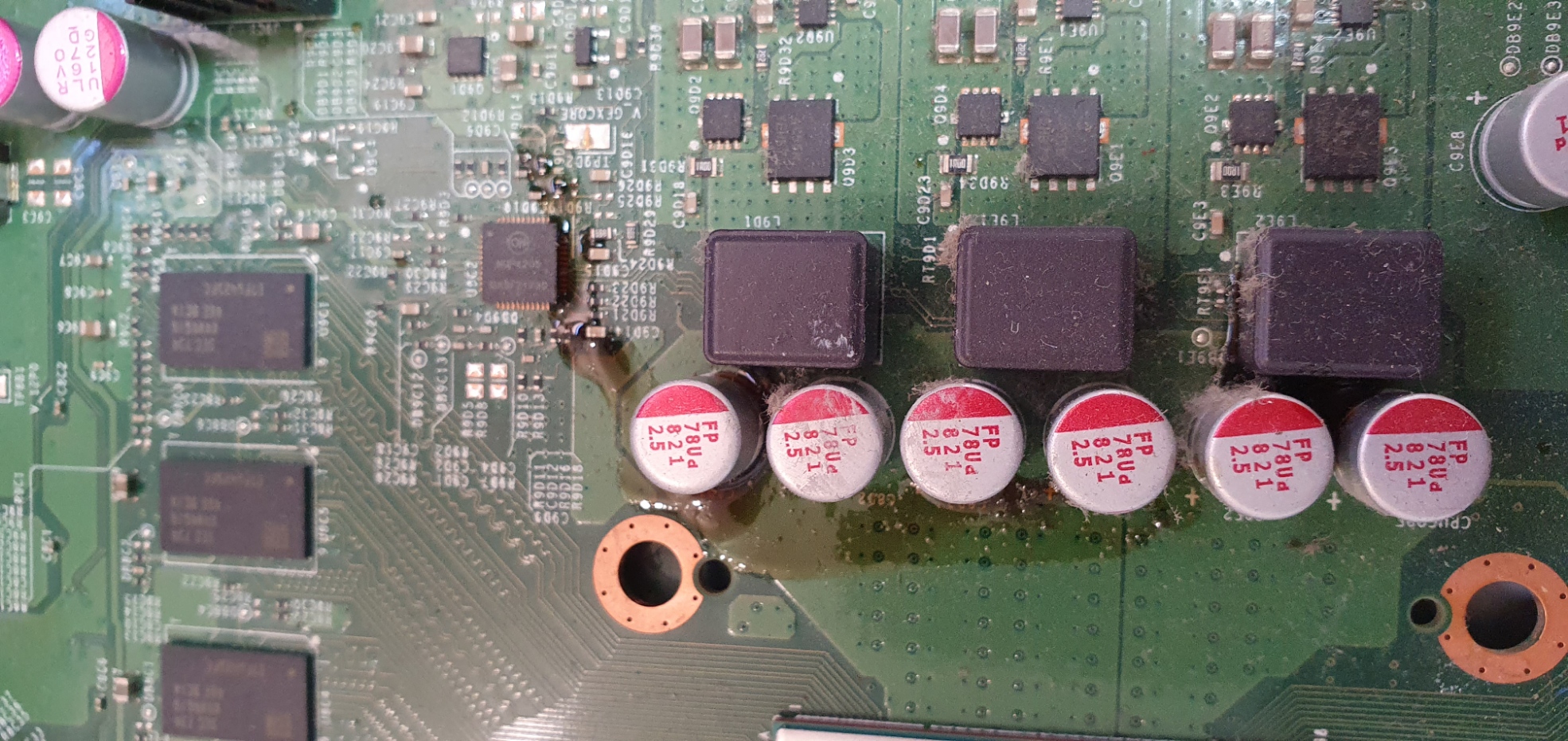

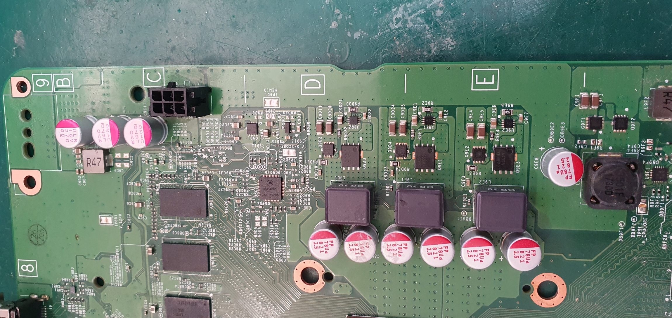

    Got an Xbox that had coke spilt in it, must not have been there long but it was sticky and my normal solvents were not making it budge so on a time budget I hit it with some Ajax spray and wipe glass cleaner and it brushed off within 20 seconds.
    Whatever's in that bottle is some nasty stuff but it worked a treat!
    P.S. I gave it ISO bath, ultrasonic then ISO bath again after these photos as I thought if it cleans up that well so fast it would very likely corrode if anything was left on the PCB.

    I had an old PC motherboard that likewise had cola spilled on it, it came right off with ... plain water, no solvents needed. I suppose it depends on the brand of soda, but sorry I don't know what soda it was.

      Just wanted to say… a mixture between warm water and a little bit of Dawn dish detergent does the same thing. I even tried that combined with my ultrasonic cleaner and the heater on 60C and shit comes out like new! No scrubbing and IPA bath required!

        yea, it's a water based beverage so treat it like washing the dishes.

                      When you have clean sticky/sugar liquid from the pcb:
                      1. soak in water, then brush
                      water mix and dissolve sugar and salt, alcohol (ipa) does not
                      Water is solvent in this case
                      2. rinse with ipa or 96% ethanol
                      alcohol mix and dissolve water in any ratio, so it helps to dry (usefull especialy under bga)
                      3. Hit with compressed air if you can
                      4. Eventuali repeat from 1. till end result is fine
