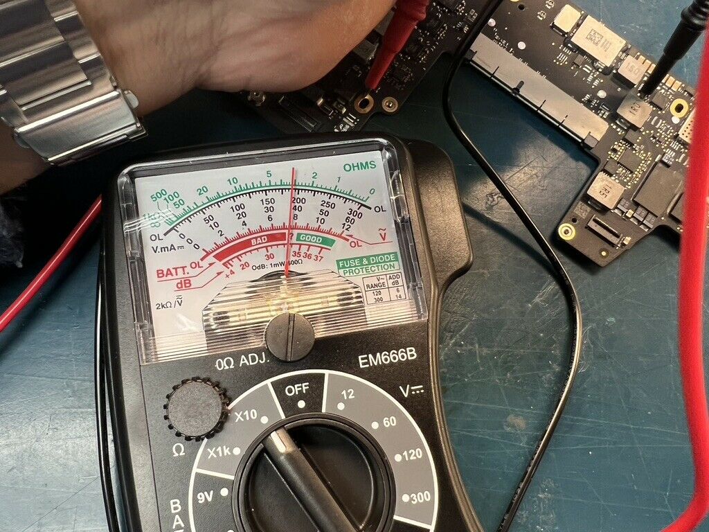

    Hi guys I asked a friend of mine to give me the resistance measurements on a 3V Rail on a Macbook Pro 2017. He doesn't have any digital multimeter at the moment. Do any of you have experience with this analog multimeter and can be able to tell me what is the reading in ohms being displayed ? Just need to know if this line is shorted.Thanks
  • R_J
    • Jun 2012
    • 9535
    Re: Analog Multimeter Readings
    Resistance X10 range should be about 32Ω, if it was zeroed correctly and omitting any lead resistance
      Okay thanks a lot for this information. Definitely helped.

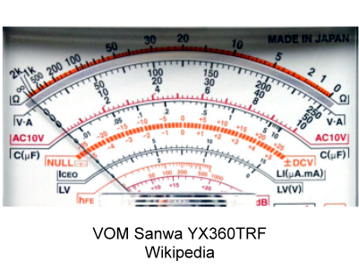

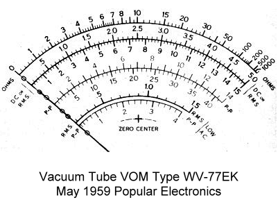

                BTW, if reading the 1/(X+1) scale is hard enough on battery powered VOMs, anyone use VTVOMs where the scale is reversed where the full scale reading is infinite ohms... the natural way someone would read a meter?
                I learned using battery powered VOMs so the 0 as full scale is "normal" for me, but I suppose the VTVOMs would look more "natural" to people who've used DMMs forever...
                    How come...? Take an example where the test leads are unconnected: both VOMs and DMMs will read 0 in V & A and 'infinite' or 'OL' in Ohm > Correct.
                    Unlike Vacuum Tube VOMs (VTVOMs) that will read 0 in Ohms > Incorrect

                      No... If you short the leads on a VTVOM, VOM, and DMM, they will all say 0 ohms... Likewise leave them open, it will say infinite. However:
                      VOM:
                      0Ω -- Full scale deflection (meter points to the right)
                      ∞Ω -- No deflection (meter points to the left at rest location)
                      VTVOM:
                      0Ω -- deflects back to 0 (meter points to the left)
                      ∞Ω -- full scale deflection pointing to ∞ - circuit passes current to make default location pointing to the right
                      DMM:
                      0Ω -- Displays 0
                      ∞Ω -- Displays overload (OL or 1)
                      So the VTVOM (at least the Heathkits and a lot of other VTVOMs) the behavior sort of matches DMM operation whereas battery VOMs it looks kind of reversed...
                        No... Likewise leave them open, it will say infinite.
                        The pictures may help...
                        Test leads are unconnected (Needle in rest position):
                        • VOM: ∞Ω -> Correct
                        • VTCOM: 0Ω -> Incorrect
                        • DMM: 'OL' = ∞Ω -> Correct
                          Not sure what you're trying to help here, but the key aspect of some VTVOMs is that they pass current to swing the meter "full scale" and point to infinity ohms when you're in resistance mode and have nothing connected to the probes.
                          The only reason why they do this is for people who must have 0 on the left hand of the scale for volts, amps, AND ohms. Having 0 ohms on the same side of the scale as 0 volts is of course impossible without requiring current to pass through at all times to support ∞Ω on the right hand of the scale with the other full scale readings. For battery operation this would kill batteries in no time, but with wall powered VTVOMs this is not as serious of an issue when vacuum tube heaters will use up many more watts anyway.

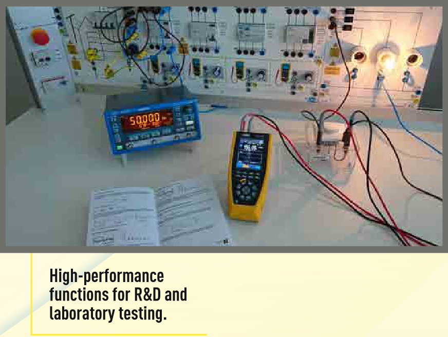

                            I really wanted to make a DMM with an LED display, some 14-seg alphanumerics but that is too hard to support menus etc.
                            Have to augment it with an OLED or maybe LCD is mature enough now. LCD are used on every phone, tablet, monitor, TV so going to stay cheap.
                            The Chauvin Arnoux is 320x240 (and $750 ouch) and look how meh it is, next to an LED meter in the flyer. They're using a small font and the screen layout is poor.
                            Character LCD's are crap, especially if there is a bar-graph the mux ratio is too much. I am fixing an old handheld DMM with huge 3/4" 21mm LCD 9V direct-drive display. I was going to bin it but the display has great contrast and you can easily read it outdoors, in the sun etc. An AN8008 looks washed out and faded in comparison.

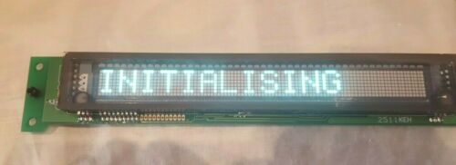

                              i have a collection of interesting displays,
                              maybe i'll put an arduino between my uni-t 61e and a 14digit BIG vfd from a gambling machine - to see how it looks
                              i'd like to use a graphic vfd, but i have not managed to write functioning code for those yet
                              the industrial displays from gambling/vending gear are dirt cheap on ebay, but there are no datasheets public
                              i also have 4inch 7segment red led displays!!

                                      • 30965
                                      the vfd's arent multiplexed, they have onboard microcontrollers that handle ASCII conversion and mapping from a syncronous serial interface.
