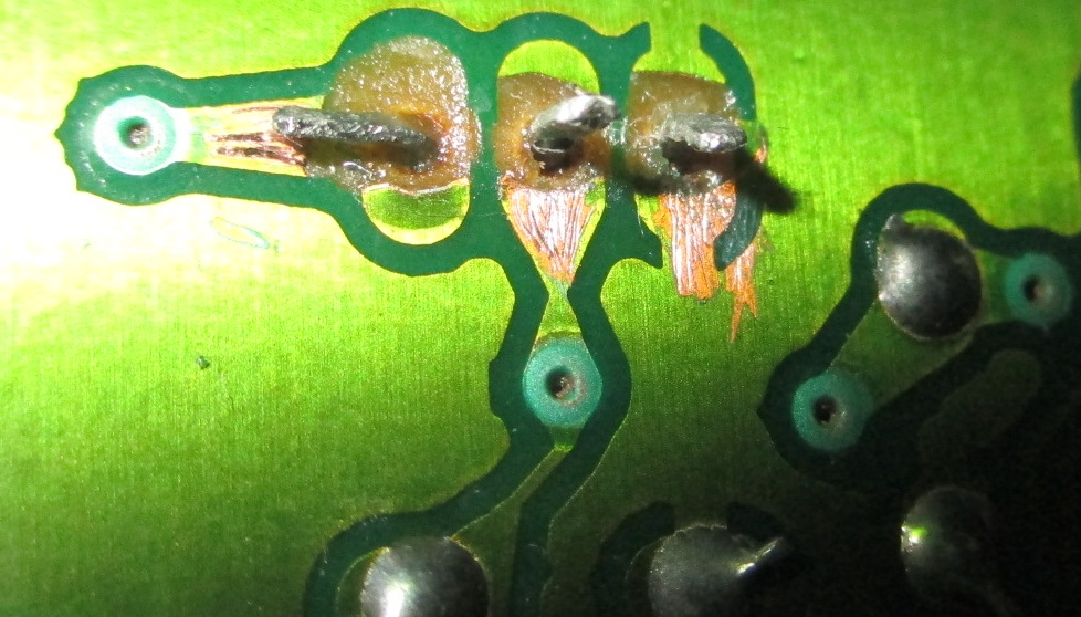

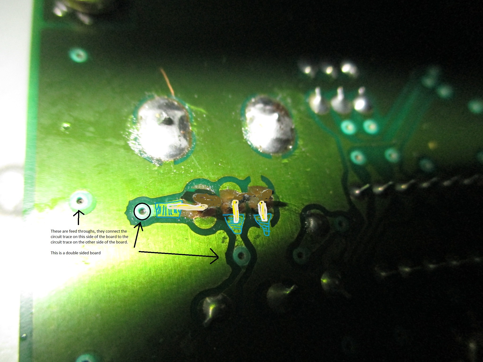

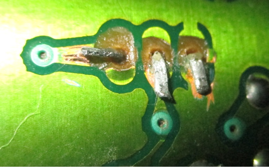

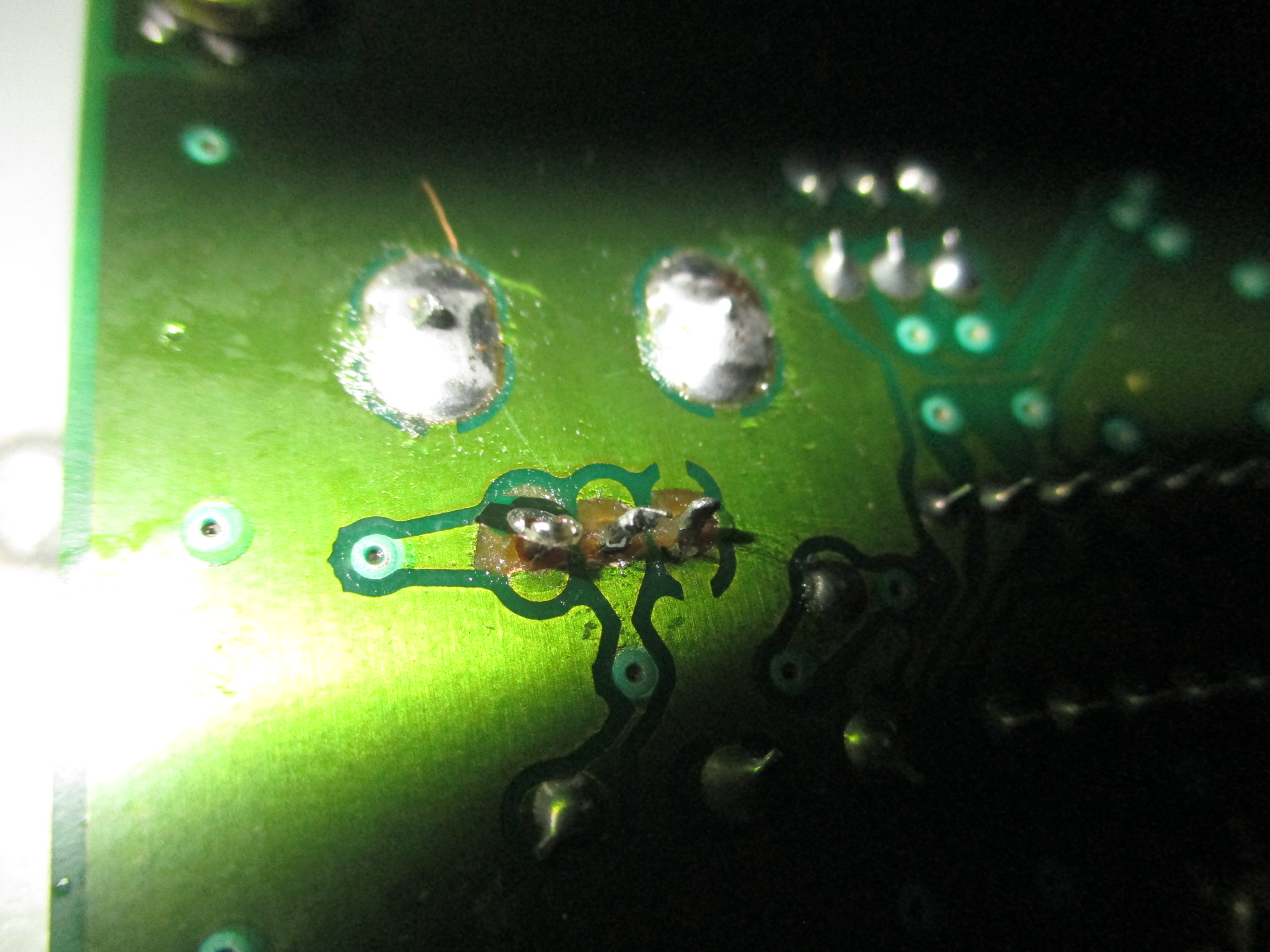

    This is a Roland MC-505 synthesizer I bought used years ago and 1 of the knobs was bent.
    Eventually it started 'ghost editing' by changing the parameter of this knob on its own.
    I resoldered the 5 pins on this knob (the two larger solder spots above these 3 smaller ones is for the same knob).
    Then it started happening again, or maybe the knob stopped working totally (I set it aside months ago and forgot about it).
    I bought a replacement knob/Potentiometer but when I recently opened it up, it seems the previous repair I did didn't 'stick' and wasn't making good contact. So I'm trying to use the same Potentiometer.
    The previous repair was atrocious. I used a $5.50 harbor freight 30W non-adjustable pen-style iron and it was tricky to get the 3 small prongs soldered, I'm surprised it even worked and didn't short from solder touching eachother.
    I got decent at soldering recently repaired headphones and learned I was doing it wrong before by trying to basically transfer globs of solder from the iron to the work instead of heating the work for a couple seconds and touching solder to it. I also didn't use flux or anything before. I'm using a digital ~$14 80W Chinese eBay pen-style iron with various tips and it seems to be ok.
    I just did the 2 larger solder spots and then noticed the circle pads on 2 of the 3 smaller pins are detached!, and one seems to have vanished but I think it was working like that. I guess I added too much heat previously or that there was some wobble from using the knob on the synthesizer.

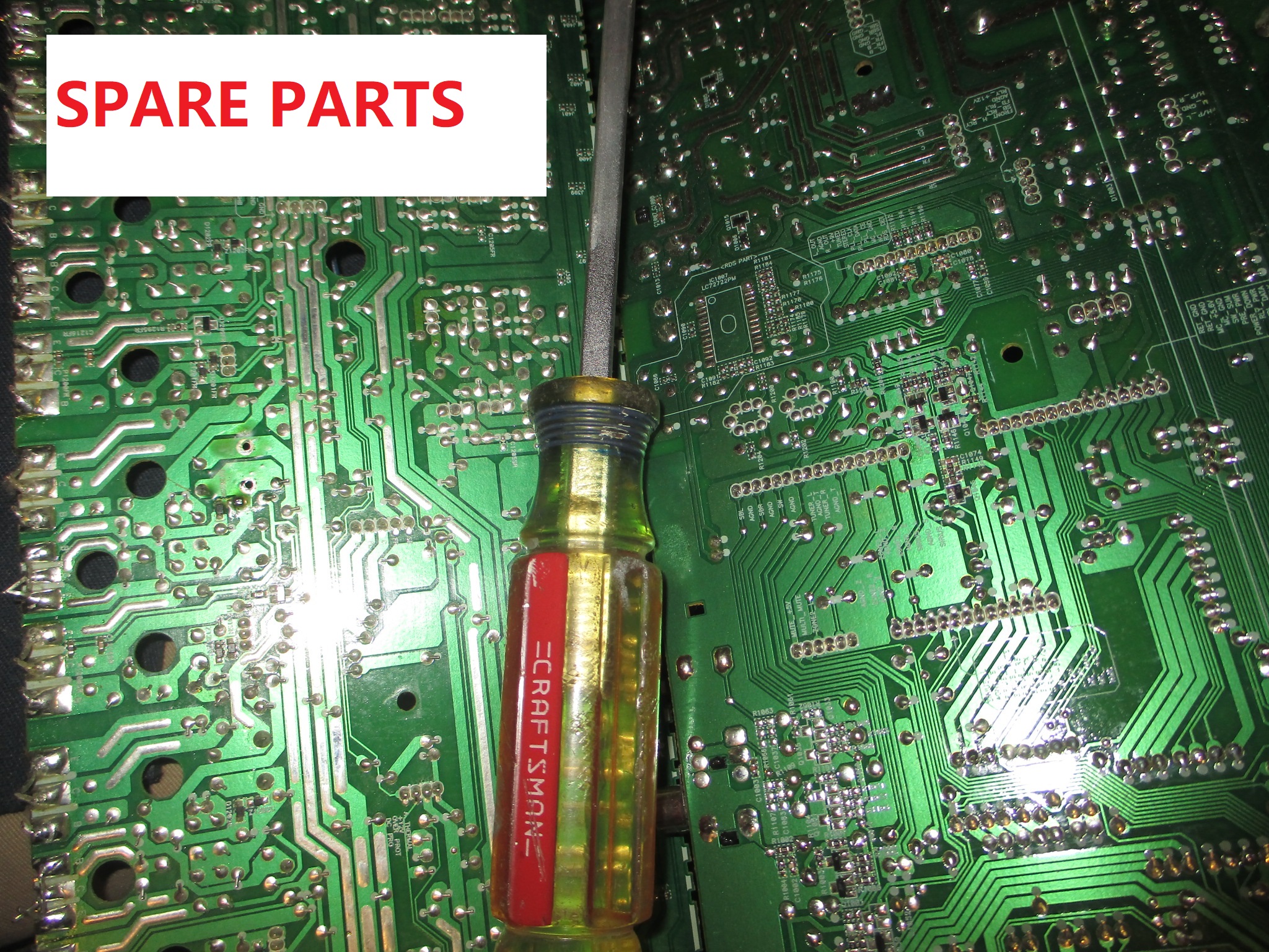

    The pic with the screwdriver is spare parts of a stereo I took from the curb to practice on so maybe I can use something from that? The circle pads are really tiny like 2mm diameter.
    What do these pads even do? They transfer electricity to the darker green lines/tracks on the board? The solder is supposed to touch the dark green surrounding tracks, or no? I don't get why these pads are even there, are they supposed to insulate/isolate electricity from the board (light green).
    any help greatly appreciated. thank you

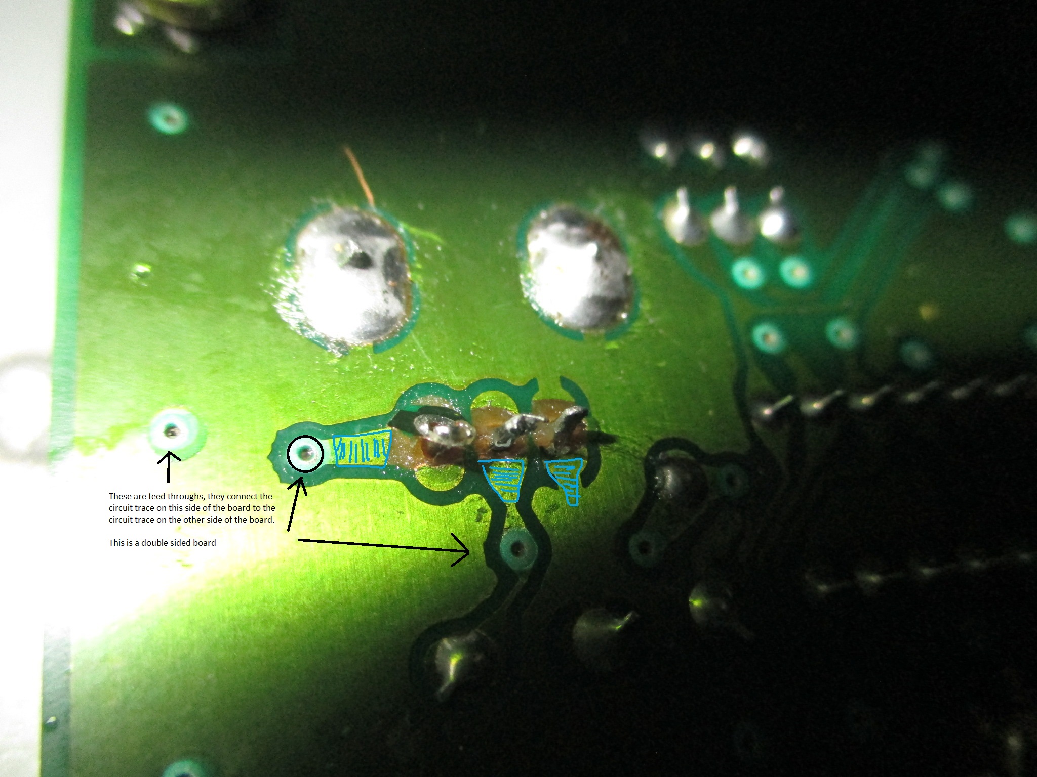

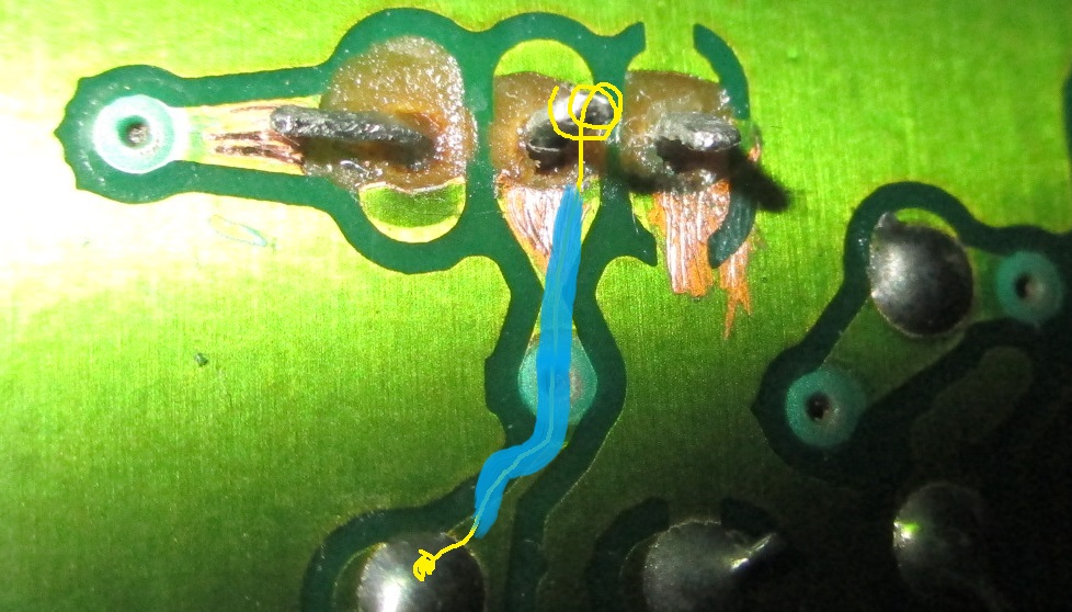

    The component has been ripped away from the circuit traces (solder pads)
    Carefully scrape the green paint from the places I indicated in blue, then tin the copper with new solder and solder the component leads to the trace (or solder pad)
    You can remove the leftover solder pad from the components lead, then bend the lead so it comes in close contact to the circuit trace, then solder the lead to the trace.

      AH ok, I think I get it,
      The dark green lines on a circuit board aren't what carries the electricity like I thought, the entire lighter green part DOES.
      For this 3 pin example the pin to the right I guess is grounded or something because it conducts to the entire board which many other pins also connect to the same copper, but the two on the left are meant to only conduct to whatever is surrounded by darker green isolating lines, in this case they conduct to the light green circle that someone pointed out this is a double sided board and the green circle 'feed throughs' go to components on the other side.
      I still don't understand pads though, why don't they just omit pads and keep that spot bare copper? That'd cause too much risk of something metal like a loose screw shorting it out?
      Pads are paper thin, so the paper thin edge is the only thing transferring electricity to the thin copper layer.
      Also, thanks so much for the replies this should be easier than I thought.

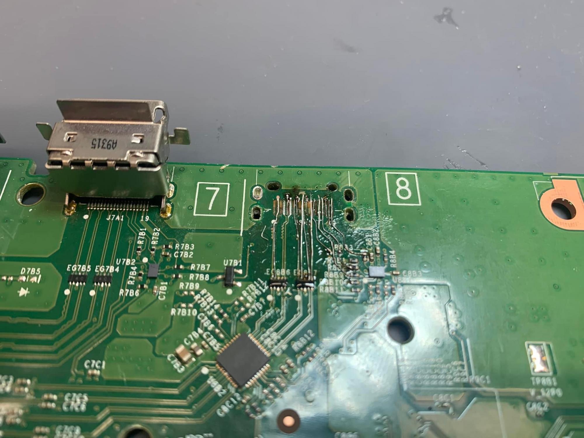

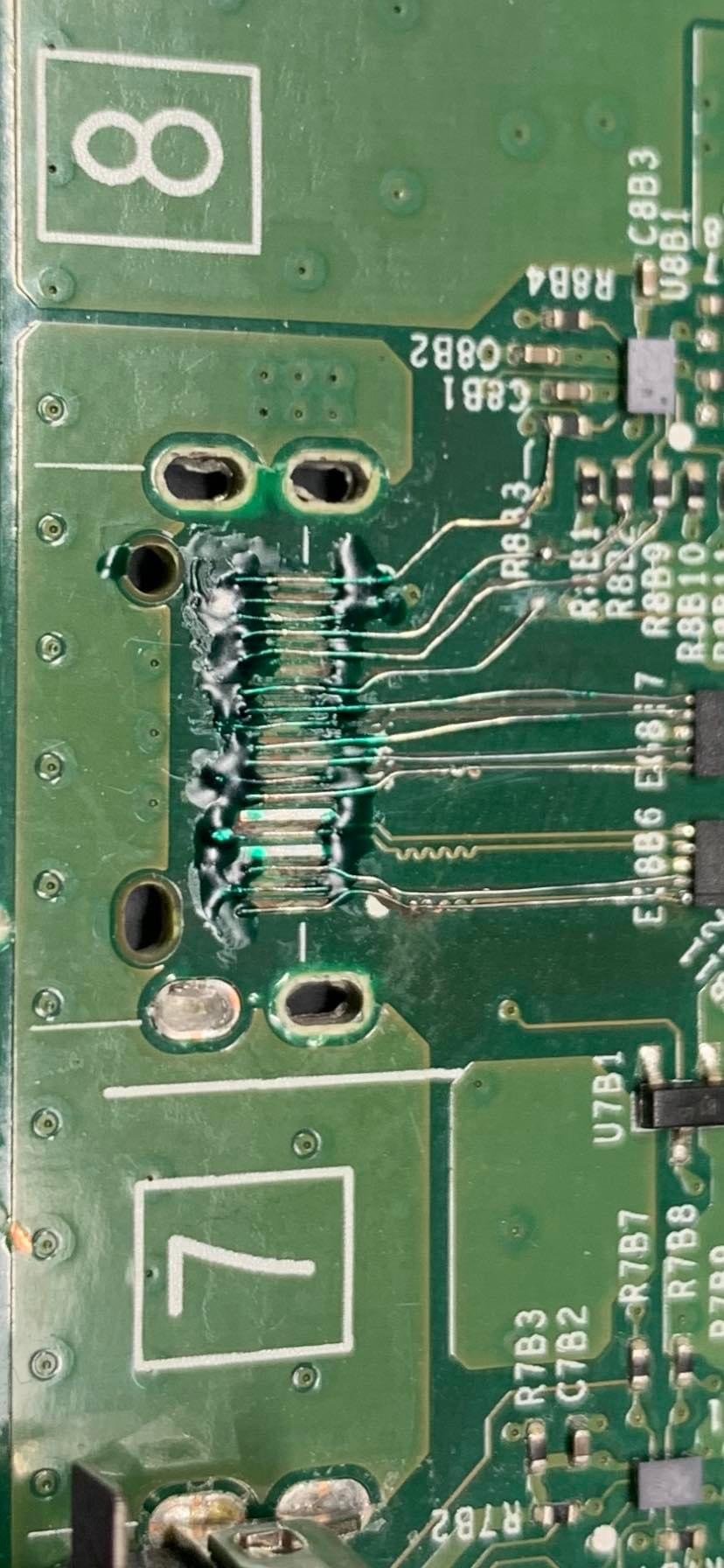

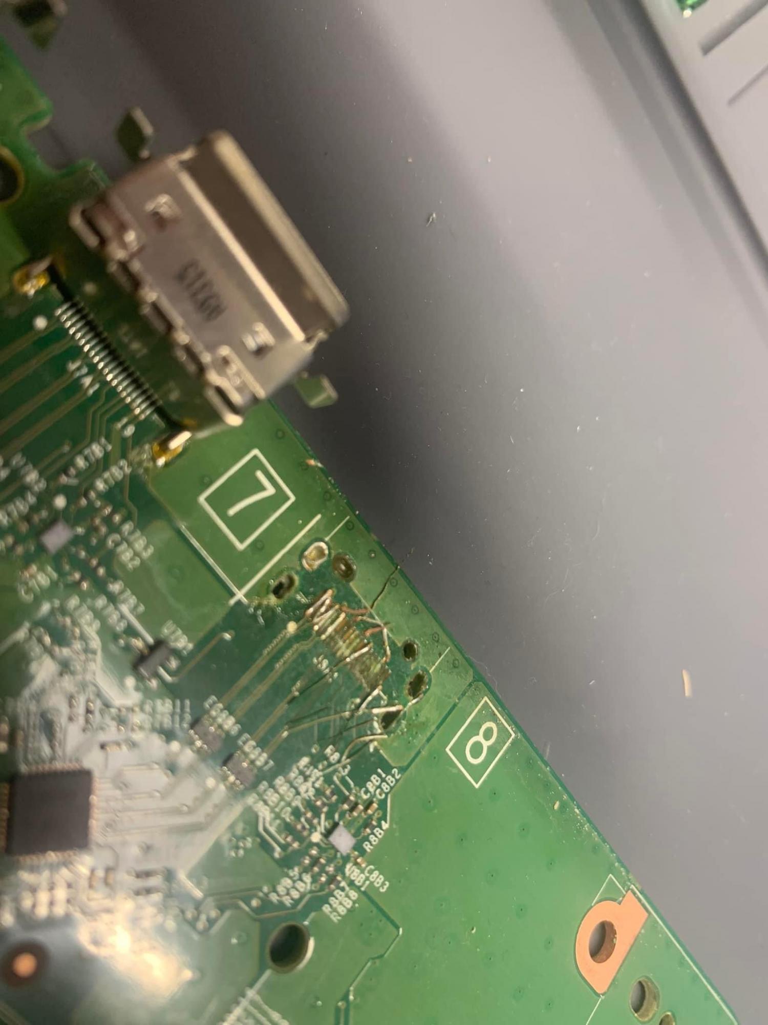

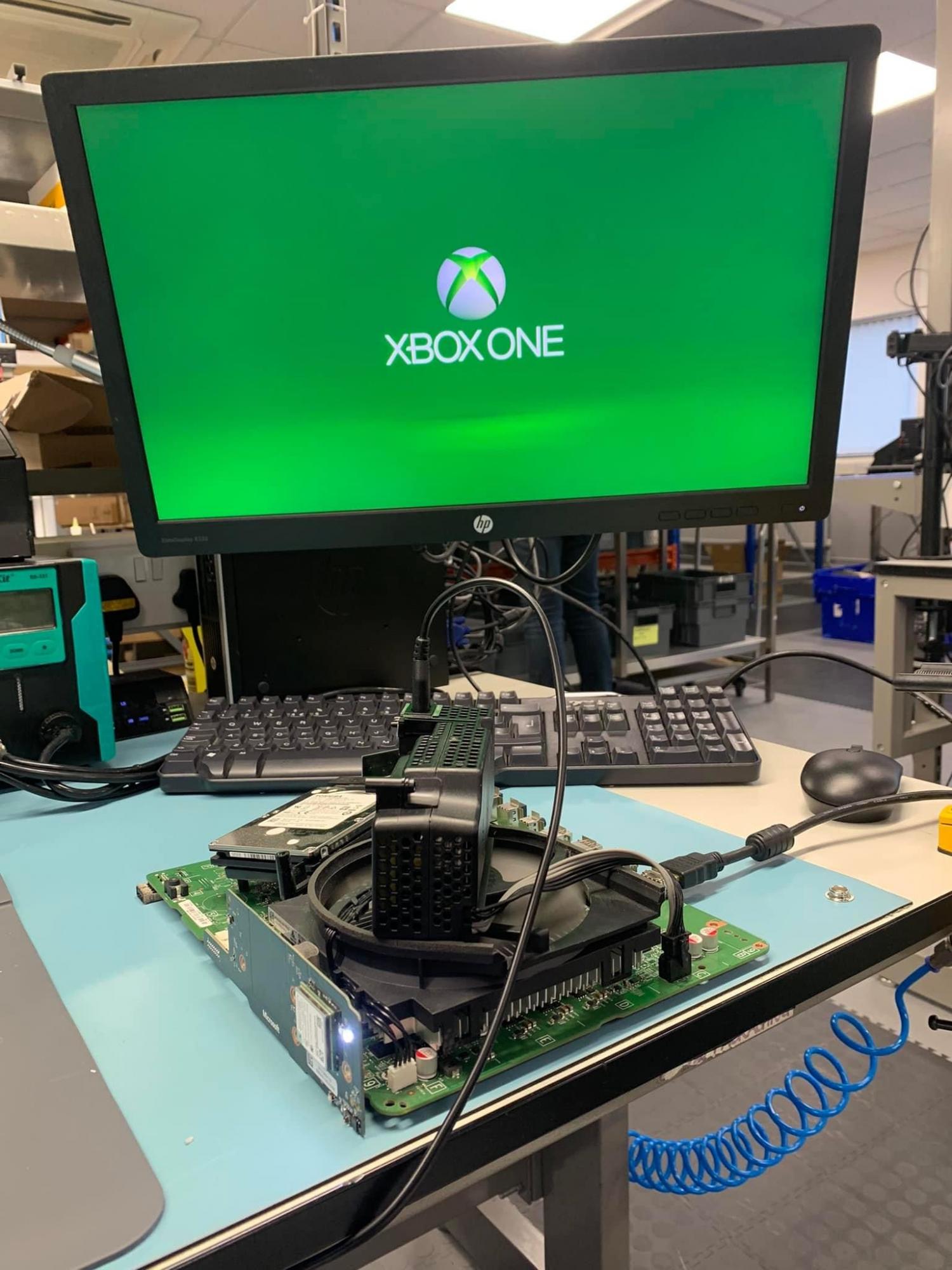

        I've got a nice one I did for you. Xbox one S hdmi pads.

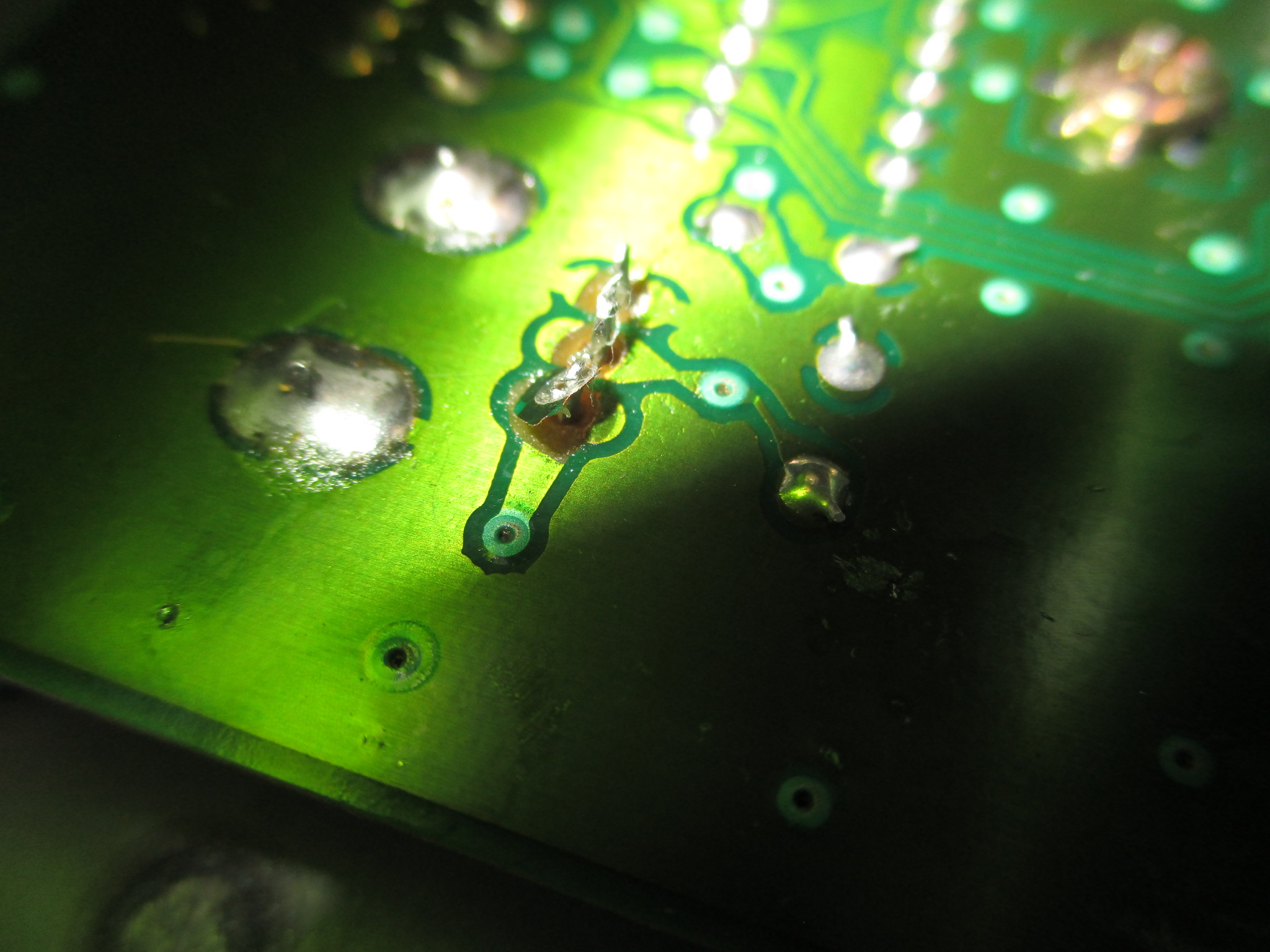

          I scraped the areas to clean copper and bent the pins down but I'm hesitant to solder.
          The left pin, right below where the pin comes through the hole, there looks to be some exposed copper.
          When I solder the middle pin I'm afraid the solder might contact the left pin's zone, keep in mind this is a really small repair and the dark green non-copper isolation lines are like only 1mm thick, so everything is super close.
          Is there some sort of non conductive heat resistant epoxy or something I can put over the area right below where the left pin sticks out?
          I have superglue but think that'll melt from soldering. Unsure if I want to buy and wait for a special product but definitely will if bridging these two zones as an error would destroy the whole board or something.

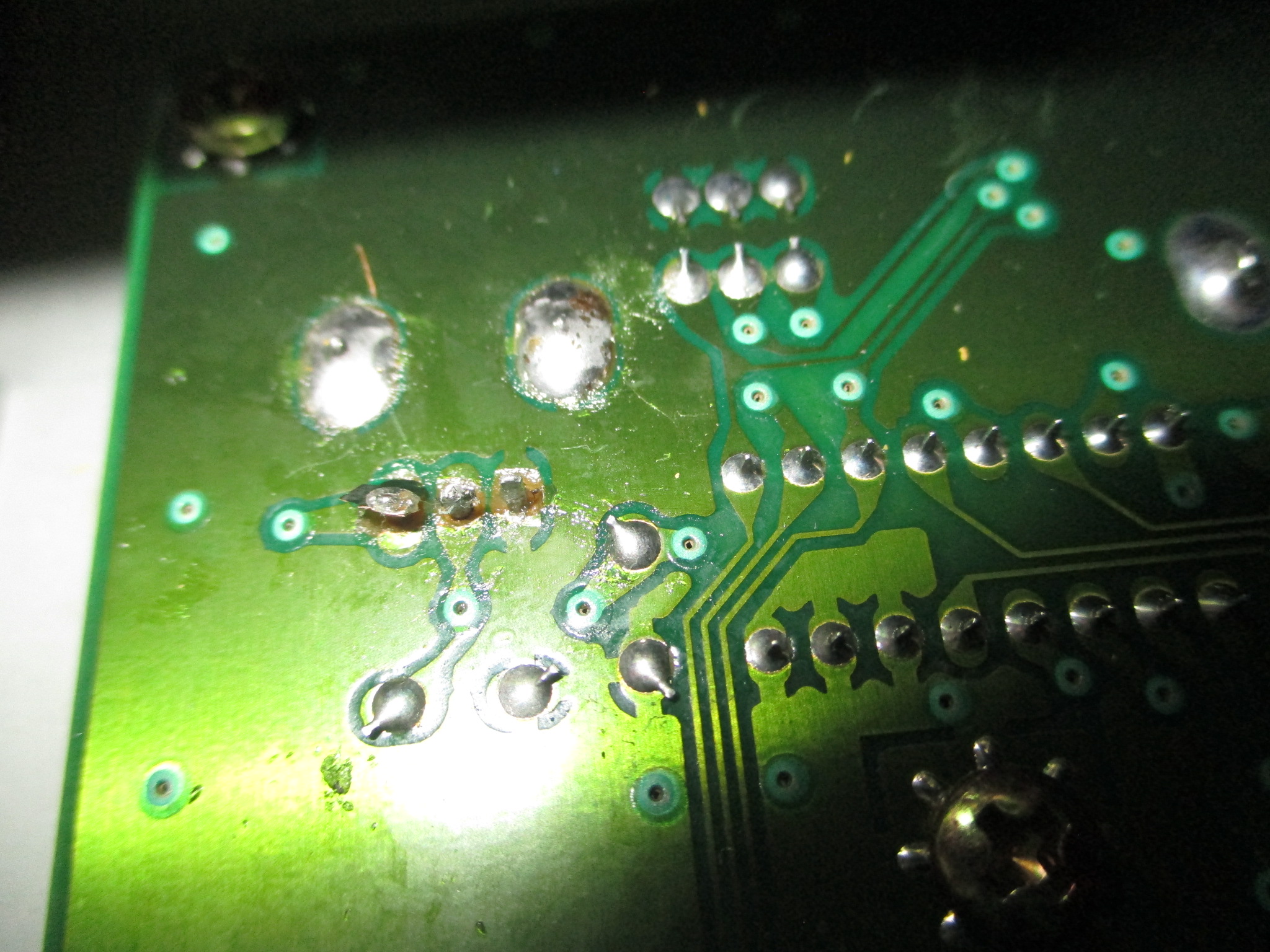

            Just be careful and don't put a big blob of solder. An alternative is to solder one end of a thin wire to the center lead, and the other end to the solder point just below the feedthrough.
            If you get any glue on the copper trace the solder won't stick.

              is the pin in the far right able to use the area scraped above it ? Looks like the far right 3rd is to a ground plane just solder that one up , middle pin down ?

                Mission accomplished! Everything fixed now. Thanks again!
                I didn't branch a wire for the center pin, it ended working out and not touching the pin to the left of it.

                      Originally posted by ReeceyBurger123
                      Re: PAD repair? What are pads?
                      This was a very nice repair I have had to repair soldering traces an eyelid for components before but not to the extent that you had to do this one WOW
                      How long did it take you to do that repair

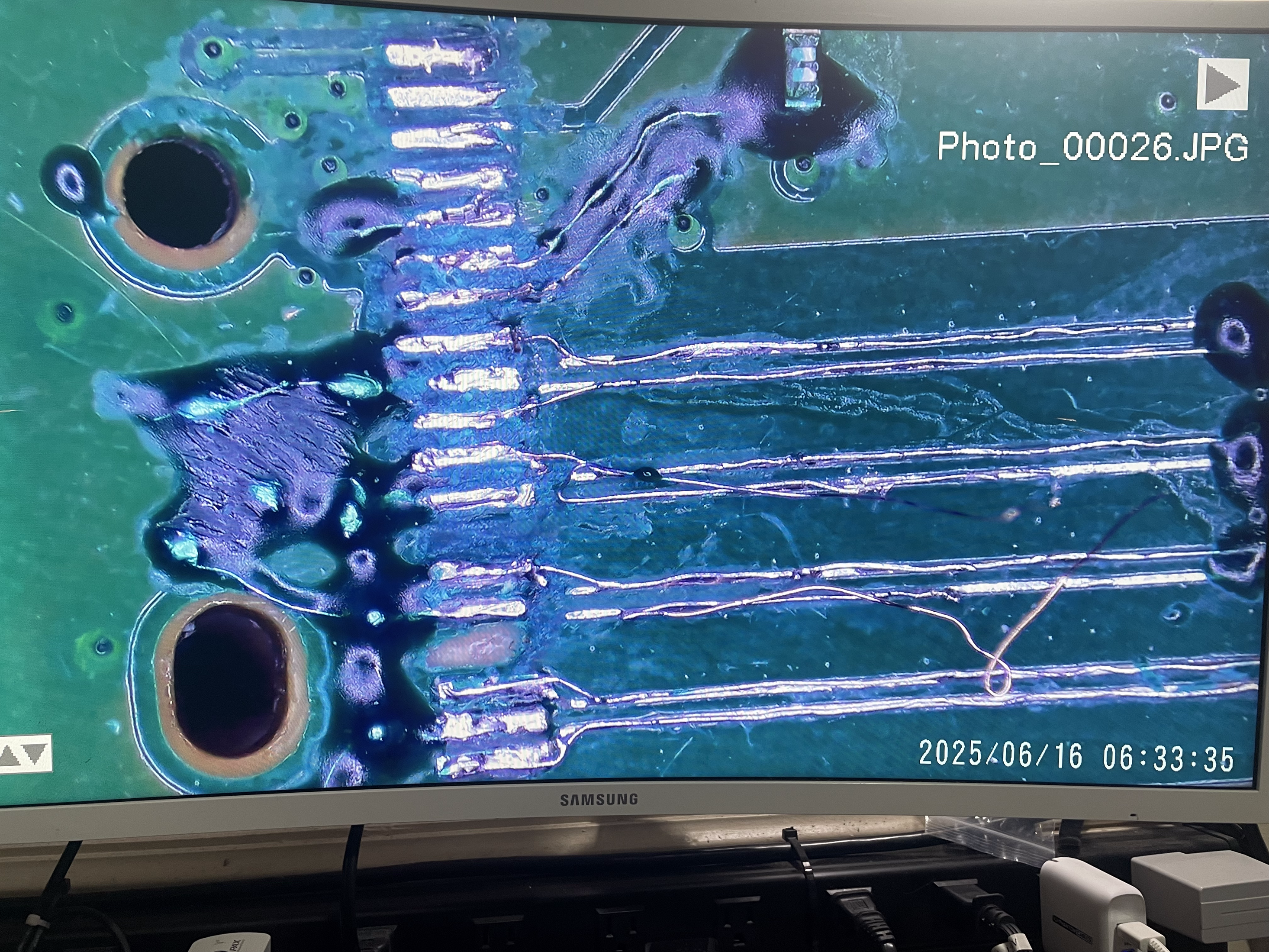

                                Pads are really just landing spots for components. When I compare the size of the actual board trace to the contact point my takeaway is that 'good contact is more important than replacing the pad'. The difficult part, like what your photos describe, is when a pad is also a passthrough point. On certain components, like the corner post of an HDMI, the pass through is a mounting point that secures the part to the board. Depending on how frequently that knob gets used the solder joints will eventually weaken. It's difficult, but not impossible to repair these kinds of pass throughs. More than likely however is that enough force on a component that damages these pass throughs are catastrophic enough to damage the PCB as well, so I generally never see these kinds of repairs unless it's an older board like your synthesizer.
                                Good idea to bend those potentiometer pins over! I would make sure those get soldered well to the board. As long as you don't bridge the pins, a good amount of solder and adequate heat will help that part stay put. The pins being bent as they are will mechanically assist the part against future strain. Don't be surprised if you have to touch up your solder in a few years.
                                Just like your bent pins, crimping parts to make things fit and then running jumpers is always viable. The only guideline is your conscience.

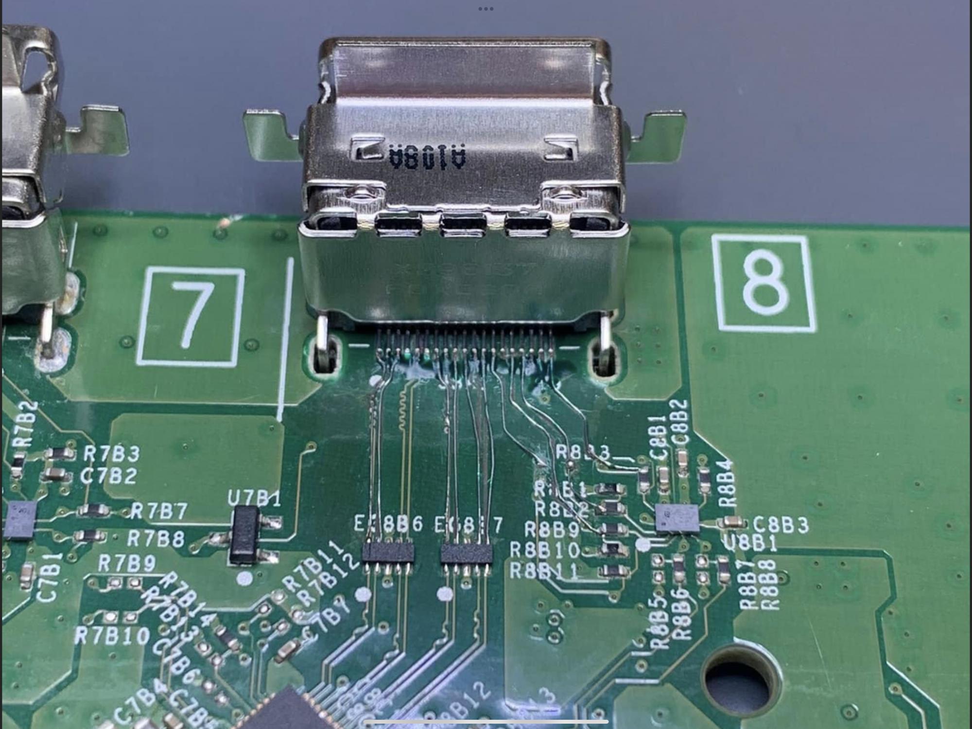

                                Those are some clean jumpers! this series X was a pain, as you can see all the pads were taken off by the hdmi Port. This HDMI repair was unique in the sense that the reason the port failed was because this was a replacement done by another shop wherein the soldering tech did not completely flow the solder on the anchor points causing cold solder joint to form. I have another photo somewhere that shows cavitation and layering of the leaded and unleaded solder.
