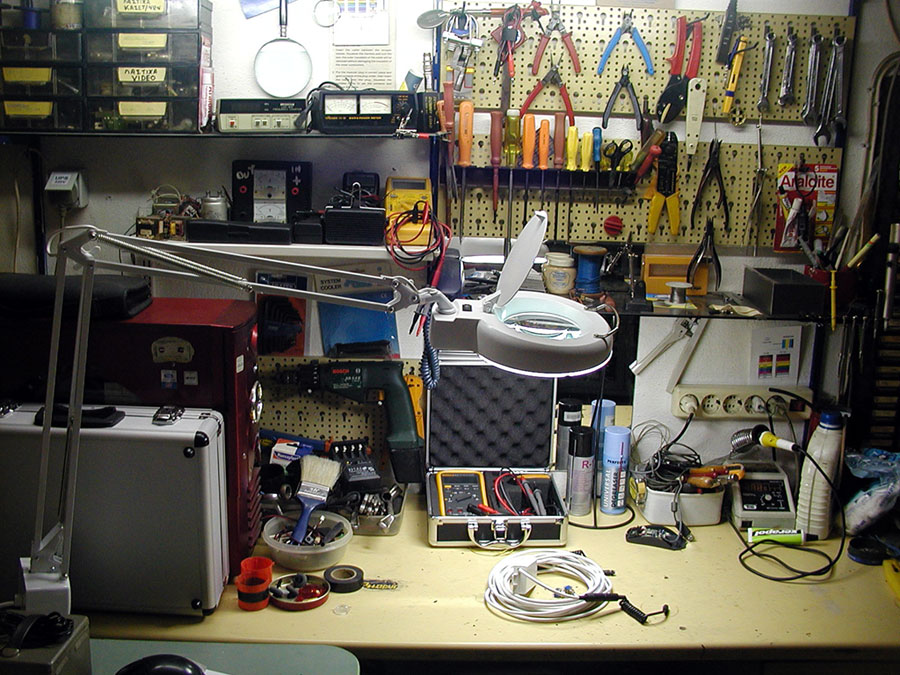

                                        Re: A Good Bench Magnifying Lamp
                                        Originally posted by CadBaps
                                        I found this site is a pretty good resource for reviews of magnifying lamp.
                                        This looks more as commercial front cover that reviews.
                                        I agree that the clamp on models are pretty much a no-brainer for sturdiness,
                                        100% correct
                                        but the issue I have is whether to get an LED one of a fluorescent one.
                                        Any thoughts?
                                        My vote goes to fluorescent, the light is bright white and uniform.
                                        With a usual 3X lens which has a bit less magnification but still is 1000 times better regarding parts inspection / PCB traces inspection and a bit friendly er about soldering.
                                        At 5X or more its like trying to solder with a binocular on your head.
                                        The focused area is very small, and the LED are incapable to send uniform light at the center of the lens.
                                        Lens made by true glass offer a clearer view, and they do not collect scratches, most lens at the cheap models are common plastic, which will fill up with lots of scratches even by just cleaning it.
                                        Last and important detail is the mechanical strength of the metallic crane.
                                        You will find quality only in solutions which cost 40-60 pounds.
                                        Bellow is what I have and I did inspect it in a local shop before getting it.
