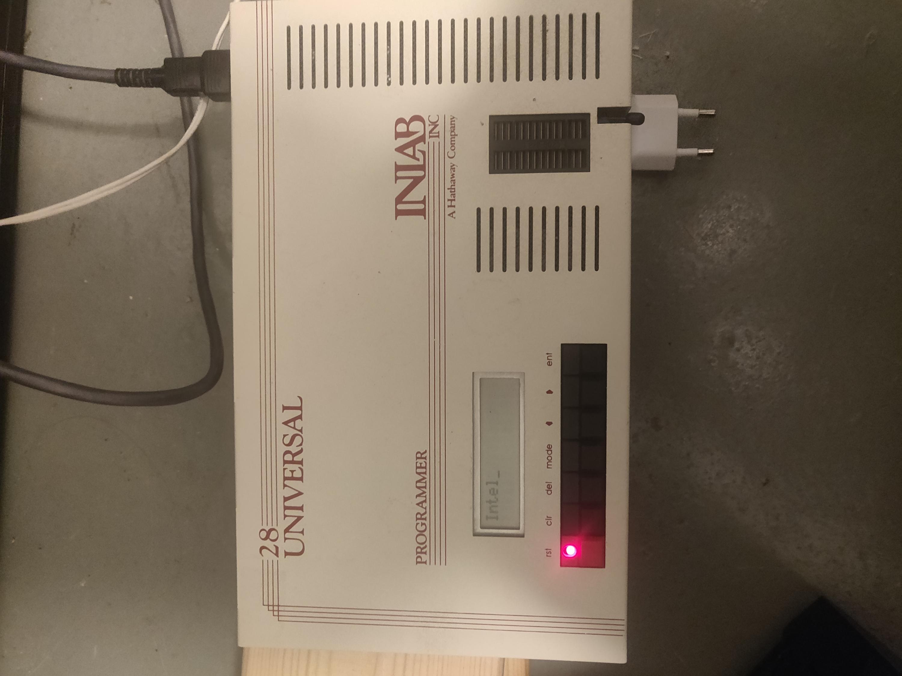

    Hello does any one know what this programmer is for?
    Re: Old programmer
    Some info after a bit of googling
    http://www.retrotechnology.com/herbs_stuff/testeq.html
    "I have a InLab Inc. model 28A Universal Progammer. It's a PROM and PAL programmer from about 1989. I got manuals and software, but no power supply for it. The power supply is a wall-wart of some sort with a DB-9 female connector to the programmer. Anyone who needs, or has, information on this MOdel 28 or 28A programmer - please contact me! "
    EDIT: https://avaluer.com/to/7186839-inlab...e__manuel.html

        okay can you do something else fun with it? for example programming pic? or is it just junk?
          Re: Old programmer
          it's not junk,
          old programmers can read and write stuff the modern ones cant - people doing retro-repair use these type of things.
          i use 2 old programmers myself - the modern usb junk wont read pal's or old microcontrollers!

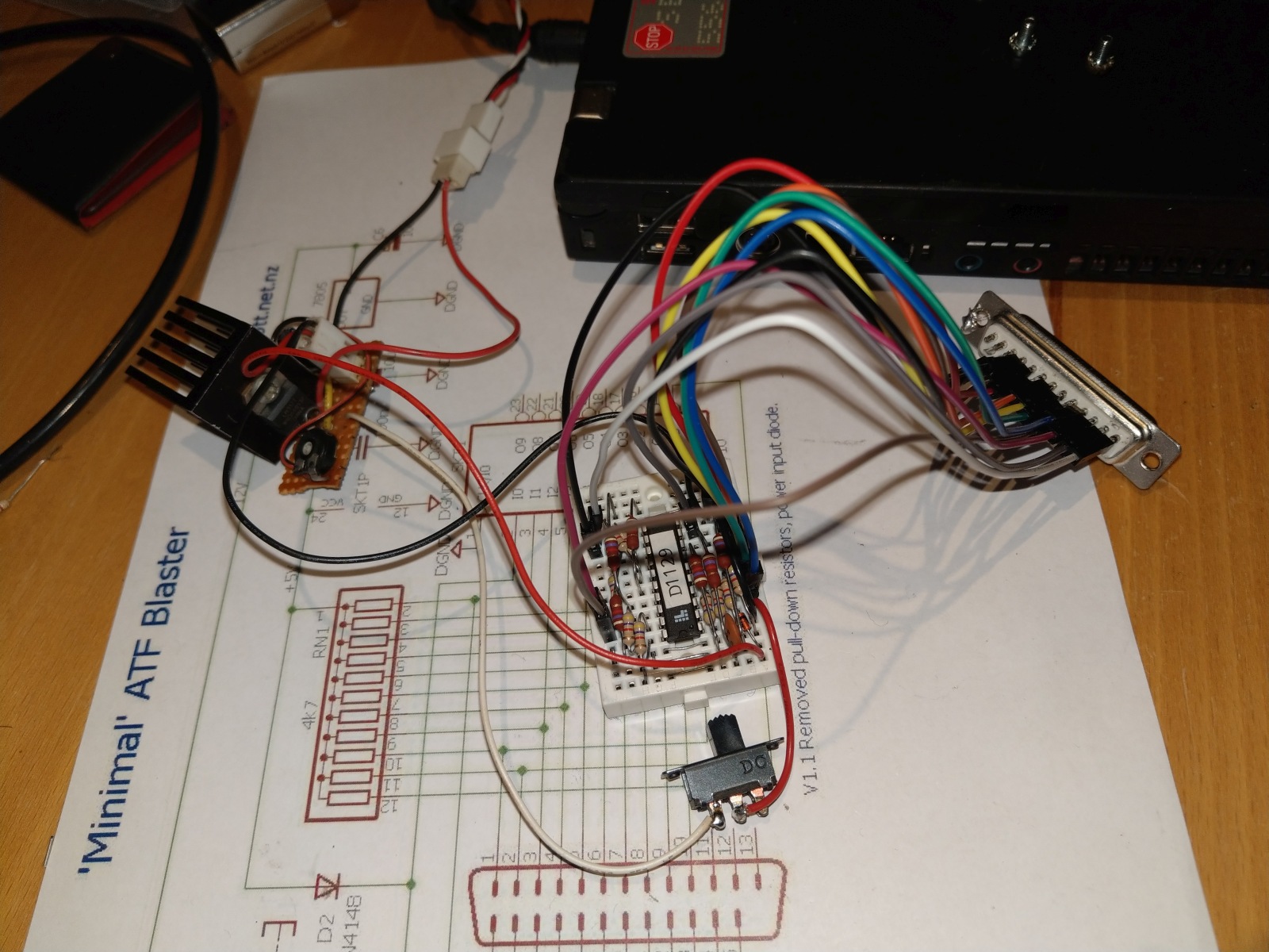

            Yep, as stj says, I sure could have used one a year ago right before Christmas.
            In the end I had to wire up a crazy contraption on a breadboard that got me through it.
            I actually found a picture of it and attached it here for your amusement.
            More details in this eevblog thread, might give you an idea what it is useful for...
            https://www.eevblog.com/forum/microc...00/#msg2113300
