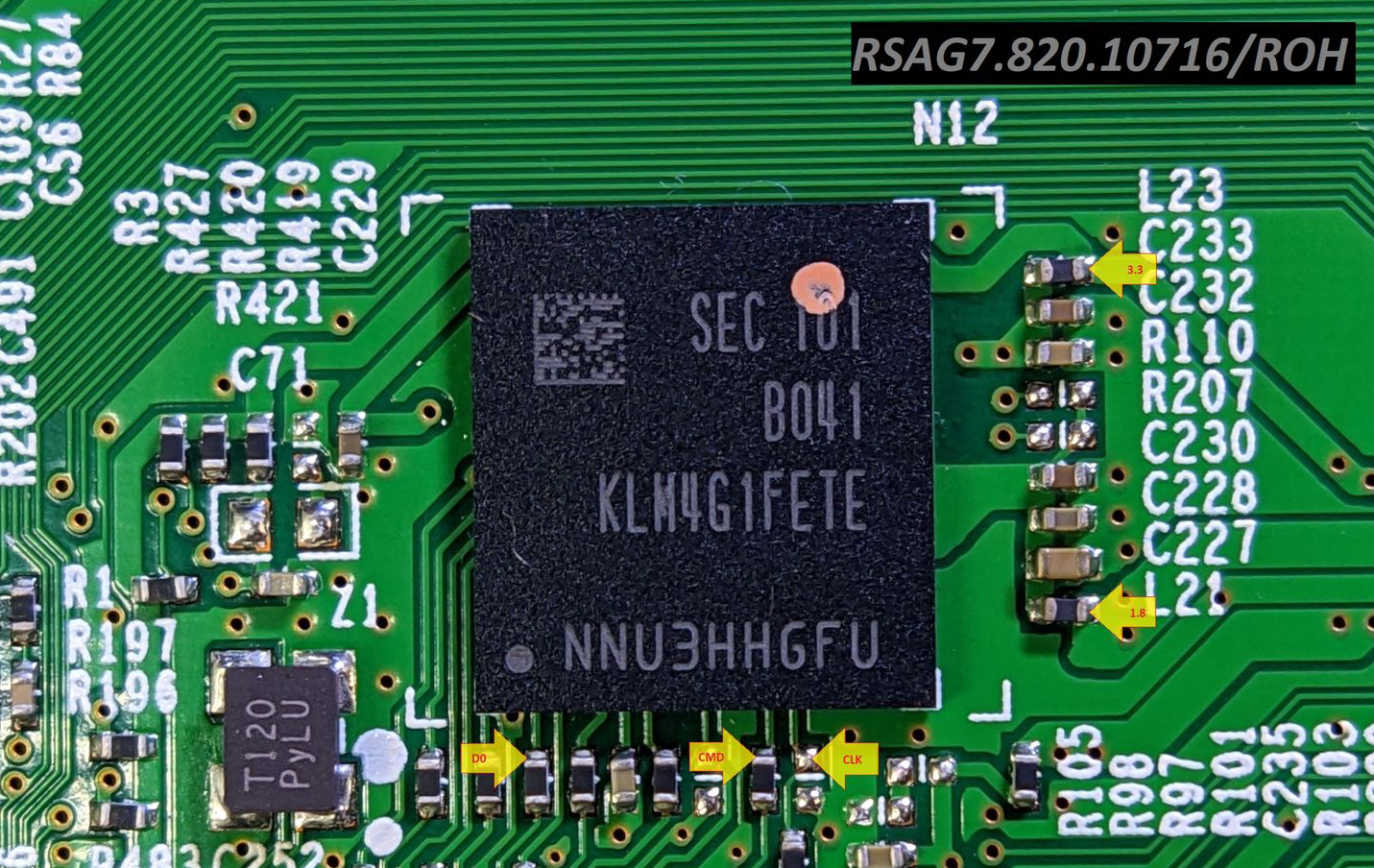

                              There are 2 methods by which the EMMC device can be programmed. One is the method in Nick's video above where you desolder the whole BGA chip and place inside of the dedicated programming tool. This method uses the SDIO interface to R/W the contents.
                              The other method is using the JTAG interface where the device remains soldered on the target PCB and you will use a mix of interface lines to send out commands and expect a response. Using this mode, you can do the same - erase / read / write the contents. Being that the Hisense TVs have worn out EMMC memory - the old EMMC must be desoldered and a blank one placed onboard - just like Nick did in the video(s). Sometimes, you can purchase the EMMC pre-flashed and ready to solder and use OR often, you must do this externally with the programming tool.
                              I do believe that it is possible to fix these boards but still confirming the final details before throwing more effort into this nasty project. Locally, Hisense owners are giving away their defective TVs. So sad.

                                This is not called JTAG, but an ISP connection, ISP connection points (Pinout) to eMMC, example in the photo.

                                  Thanks for the clarification. Are there software tools available to R/W/E the eMMC using this ISP method? Are they in the public domain or commercial?
                                  Alternatively, need to consider the RT809H or another that can R/W/E the eMMC with a zero force socket. This project is now getting interesting. We still have access to a Hisense 55Q9G main board that is 99% ok but is boot looping. That is, if we read out the contents of that eMMC and apply onto a blank eMMC, we should be able to fix this main board. Would you agree?
                                  From reading, the contents we need to dump and apply onto a fresh eMMC are: boot1, boot2 and userfile.

                                    wait... ISP are just the tool for SoC to handle the eMMC... this is only on MT SoC the interface communication are still the only one is JTAG,by SoC
