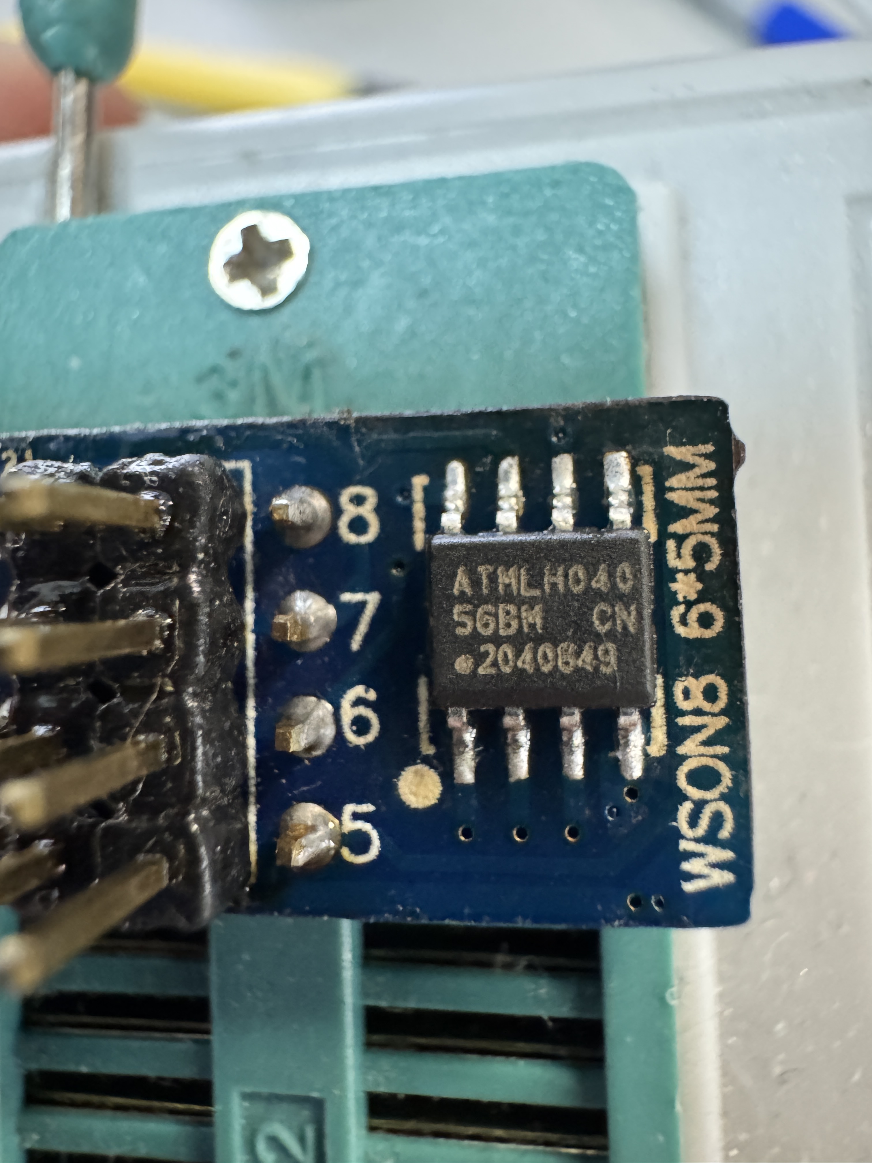

    This is a shot in the dark, but I was just using my RT809H programmer and it got stuck in a certain state so I power cycled it. Now, the device LED just flashes quickly and does not connect to the software. I've tried to update the BIOS of it and it fails. I went so far as to remove the ROM from the programmer itself but it's some weird chip (I believe ATMEL, but I can't find any datasheet on it) so I've been unable to read the BIN from it w/ my other programmer. Chip has ATMLHC4C56BM CN written on it (I think). I'll upload an image. I have the programmer's BIN ready to program it manually. Anyone else have any idea on how to get this working? I'd contact iFix themselves but everything is in Chinese and I don't have WeChat.
    Thank you for your time!

    AT93C56B

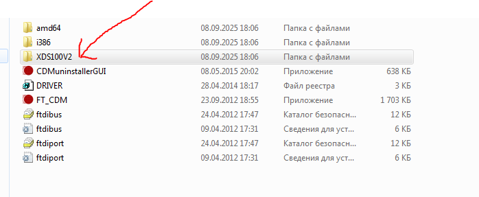

      You install the driver in compatibility mode from the XDS100V2 folder from the already installed program. Put everything clearly. Only install in compatibility mode. You can't install it in WIN 10 that easily. Two Texas Instrument devices disappear. Ports appear.
      Install driver (on two Texas in turn) from the folder: D/ RT809UH/ DRIVER/ XDS100V2,
      two devices appeared "TIXDS100 Channel A and TIXDS100 Channel B"
      then you launch the program, click the "Restore firmware" button. The firmware will be restored and stop flashing.

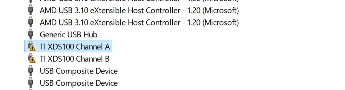

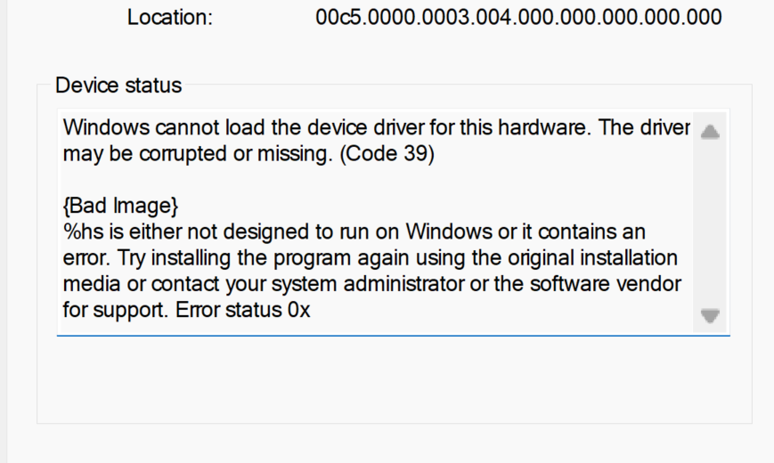

                  HI,
                  thankyou for the tutorial, but i got confuse ,can you guide me here?
                  Click image for larger version  Name:	image.png Views:	0 Size:	85.5 KB ID:	3723353
                  Click image for larger version  Name:	image.png Views:	0 Size:	145.6 KB ID:	3723352
                  2 Port IXDS100 Channel A and TIXDS100 Channel B appear like you said after installing drriver, but what program do i run next?
                  Thankyou

                    The driver is located on disk D, there will be a folder RT809H, in this folder look for the DRIVER folder and in it there will be a folder with XDS100V2 drivers.
