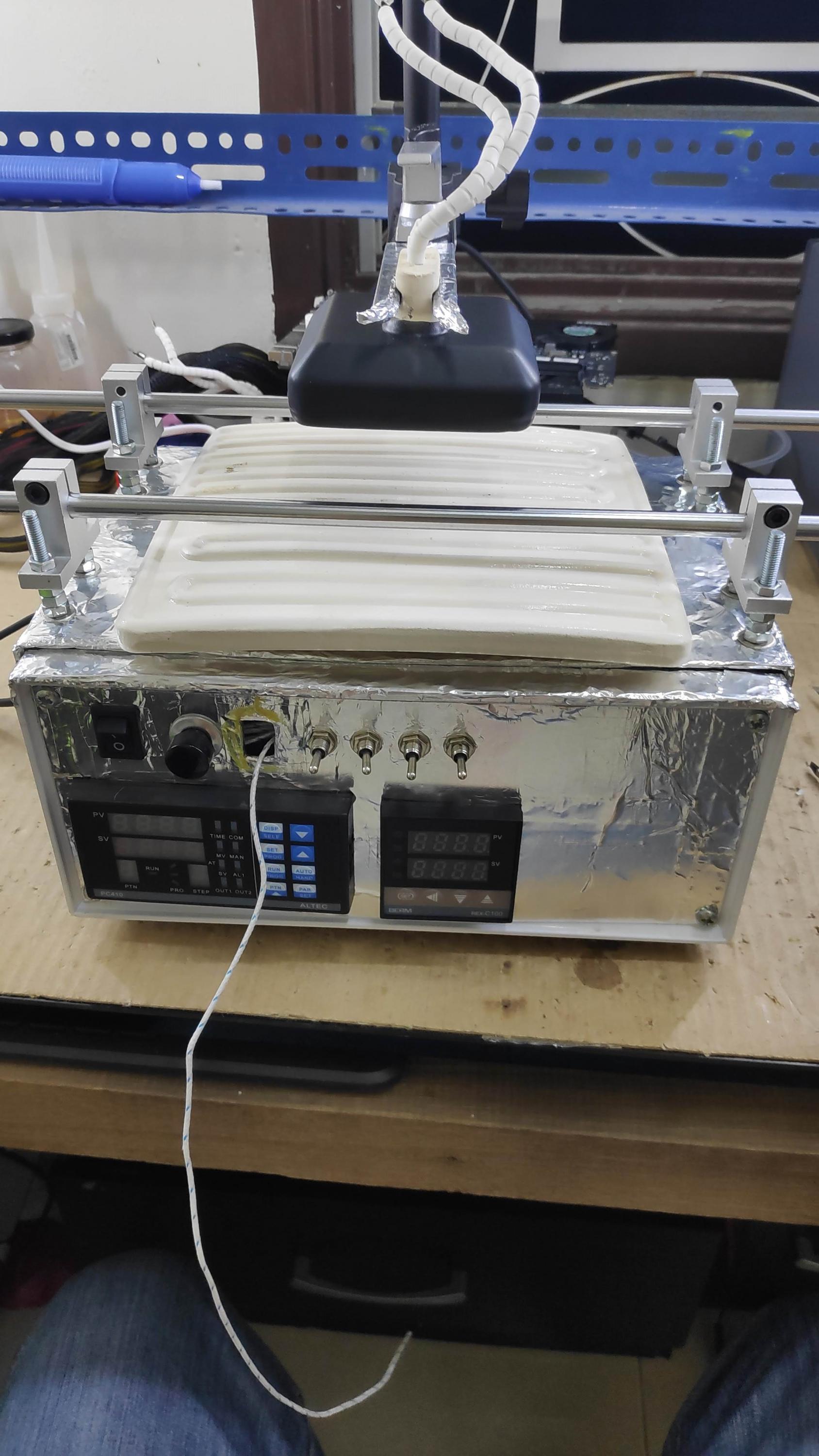

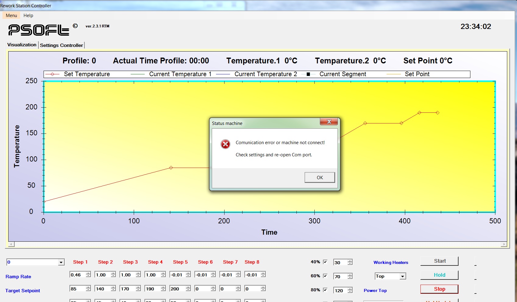

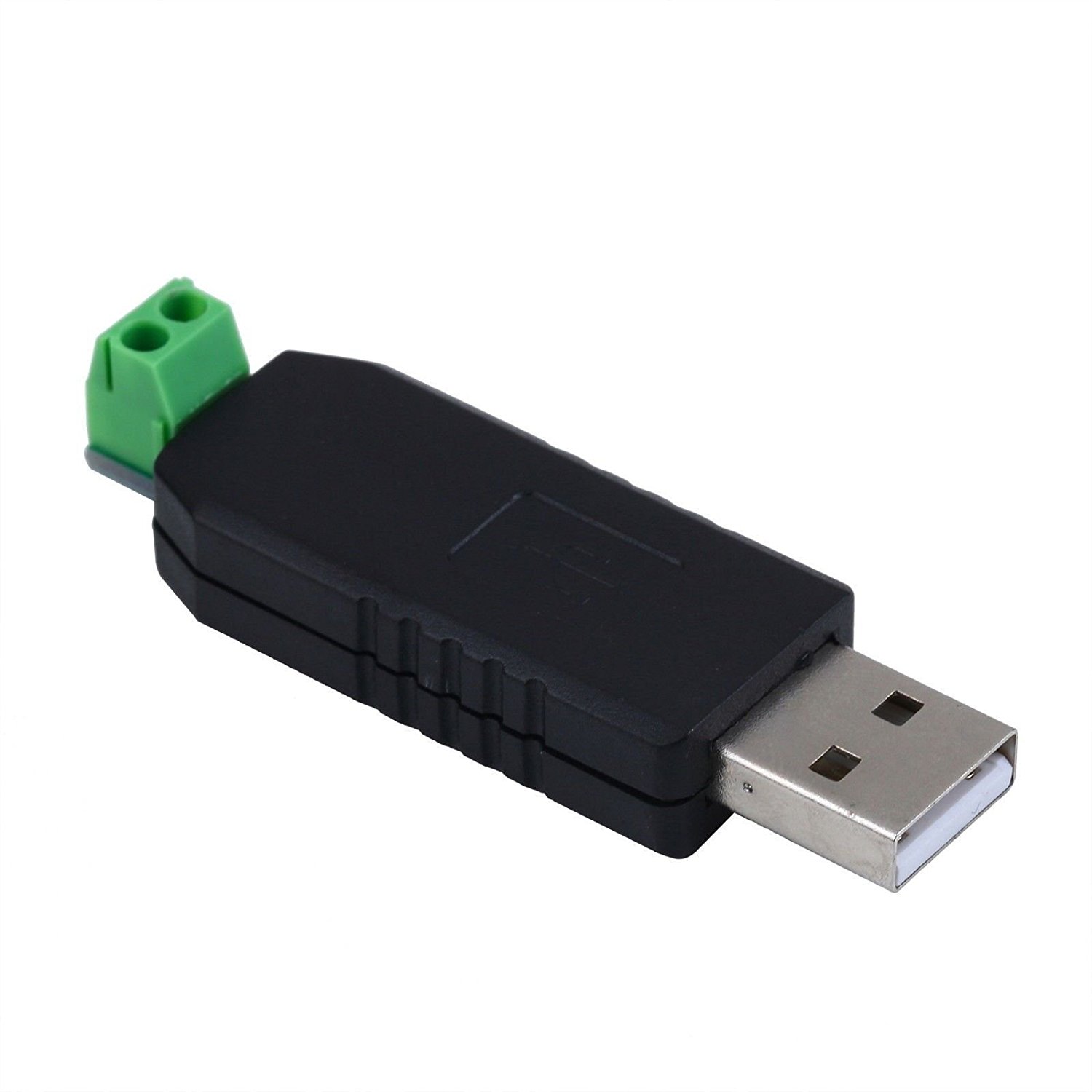

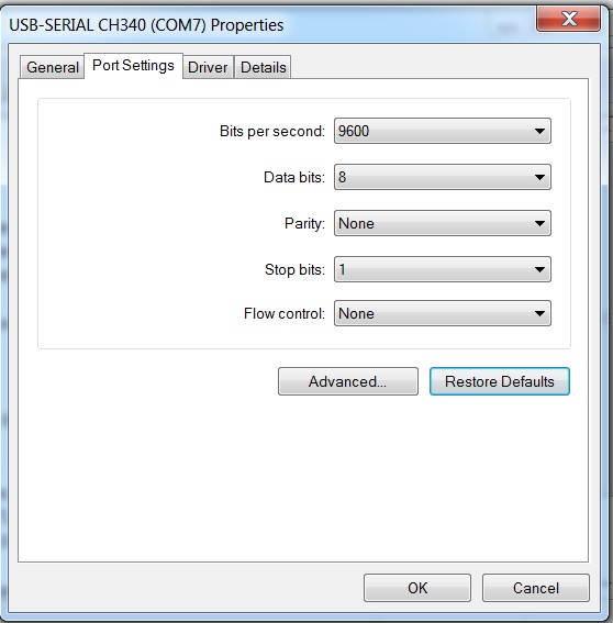

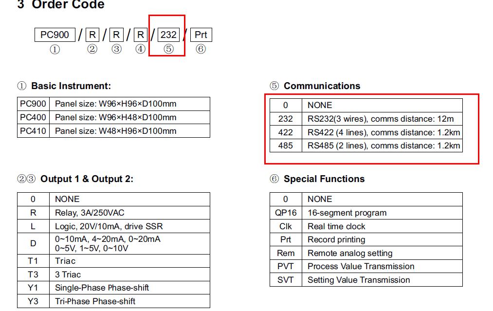

Altec PC410 (BGA Rework) to communicate with PC
  • pronester
    • Oct 2019
    • 49
    • Malaysia
    Altec PC410 (BGA Rework) to communicate with PC
    hello guys,
    I am trying to control my homemade BGA rework with RS485 (USB) using a desktop PC, but a dialog box keep pop up saying communication error - cant establish connection between the BGA machine and the PC (refer pic).
    Some information:
    - using windows desktop PC
    - the software - PSoft Rework v 2.3.1
    - the RS485 and the PC410 are properly connected i.e wired to the right pins
    - trying other IR6000 software but require a password for installation
    Appreciate your suggestion on how to rectify the problem.
    Thanks.
    • 31284
    Re: Altec PC410 (BGA Rework) to communicate with PC
    first run a terminal program to make sure the usb interface and it's driver work.
    99% of serial problems are down to the drivers or interface.
    • pronester
      • Oct 2019
      • 49
      • Malaysia
      Re: Altec PC410 (BGA Rework) to communicate with PC
      Originally posted by stj
      first run a terminal program to make sure the usb interface and it's driver work.
      99% of serial problems are down to the drivers or interface.
      how do i do that sir?
      thank you for the response tho
      • R_J
        • Jun 2012
        • 9623
        Re: Altec PC410 (BGA Rework) to communicate with PC
        Did you install the driver for the usb to rs485 adaptor? If that is a CH340 adaptor I believe there is a program CH341SER.exe that will install the driver
        • pronester
          • Oct 2019
          • 49
          • Malaysia
          Re: Altec PC410 (BGA Rework) to communicate with PC
          Originally posted by R_J
          Did you install the driver for the usb to rs485 adaptor? If that is a CH340 adaptor I believe there is a program CH341SER.exe that will install the driver
          i did install the compatible driver and it is recognized by the pc
          Last edited by pronester; 10-12-2019, 09:18 PM. Reason: to add image
          • R_J
            • Jun 2012
            • 9623
            Re: Altec PC410 (BGA Rework) to communicate with PC
            What are your com port settings?, there is some information here: https://www.badcaps.net/forum/showth...t=60723&page=2
            • pronester
              • Oct 2019
              • 49
              • Malaysia
              Re: Altec PC410 (BGA Rework) to communicate with PC
              Originally posted by R_J
              What are your com port settings?, there is some information here: https://www.badcaps.net/forum/showth...t=60723&page=2
              my com port default setting as in the pic attached. BTW should i match the com port setting to the psoft. but still it doesnt worked tho.
              on the thread, i read it earlier but still i get the same result.
              • R_J
                • Jun 2012
                • 9623
                Re: Altec PC410 (BGA Rework) to communicate with PC
                I have read in the ACHI_IR6500 manual which looks like similar software, where the usb to serial needs to be set to com1, I see on another site that the psoft software can be configured to other com ports so make sure it is set to com7 like the serial adaptor
                Last edited by R_J; 10-12-2019, 10:19 PM.
                • pronester
                  • Oct 2019
                  • 49
                  • Malaysia
                  Re: Altec PC410 (BGA Rework) to communicate with PC
                  Originally posted by R_J
                  I have read in the ACHI_IR6500 manual which looks like similar software, where the usb to serial needs to be set to com1, have you tried that?
                  It could be that the psoft software can't operate on com7
                  aha..you got a point..initially i thought it could be connected to any port
                  let me check where is this port 1 located in the motherboard
                  • R_J
                    • Jun 2012
                    • 9623
                    Re: Altec PC410 (BGA Rework) to communicate with PC
                    I edited my post, I also found this site which has a bit of information https://www.antalife.com/2018/10/pro...plate-mod.html
                    • pronester
                      • Oct 2019
                      • 49
                      • Malaysia
                      Re: Altec PC410 (BGA Rework) to communicate with PC
                      Originally posted by R_J
                      I edited my post, I also found this site which has a bit of information https://www.antalife.com/2018/10/pro...plate-mod.html
                      ok thanks..i try to work it out..not sure how to connect to com1 of my pc.. i can see a port here in the motherboard labelled as j_com1
                      but during my test earlier i did match the port from the com port and the psoft i.e i set port 7 for both psoft and pc
                        • 31284
                        Re: Altec PC410 (BGA Rework) to communicate with PC
                        is the controller using rs485?
                        i thought they where rs232 normally.
                        • megaraider
                          • Jul 2015
                          • 307
                          • Portugal
                          Re: Altec PC410 (BGA Rework) to communicate with PC
                          Originally posted by stj
                          is the controller using rs485?
                          i thought they where rs232 normally.
                          From what i see that's precisely his mistake, imho.
                          The CH341 based is an USB to Serial converter, not an USB to RS232 converter!
                          [@pronester see here how Serial and RS232 are different, already mentioned by @R_J]
                          Therefore PC410 won't acknowledge connection.
                          Either use the motherboard COM port or a truly USB to RS232 converter.
                          • R_J
                            • Jun 2012
                            • 9623
                            Re: Altec PC410 (BGA Rework) to communicate with PC
                            If the pc has an rs232 port, just use that instead of a usb to rs485 adaptor, It looks like the PC900 series (PC-410) will work with rs232, rs422 or rs485, One parameter that can be changed on the controller is the baud rate, so check what it is set to and match it.
                            acording to the ORDER CODE it could also be that the pc-410 is preconfigured for a certain communication configuration so check its complete part number
                            Last edited by R_J; 10-13-2019, 03:02 PM.
                            • pronester
                              • Oct 2019
                              • 49
                              • Malaysia
                              Re: Altec PC410 (BGA Rework) to communicate with PC
                              Originally posted by stj
                              is the controller using rs485?
                              i thought they where rs232 normally.
                              yes rs485 usb
                              • pronester
                                • Oct 2019
                                • 49
                                • Malaysia
                                Re: Altec PC410 (BGA Rework) to communicate with PC
                                Originally posted by R_J
                                If the pc has an rs232 port, just use that instead of a usb to rs485 adaptor, It looks like the PC900 series (PC-410) will work with rs232, rs422 or rs485, One parameter that can be changed on the controller is the baud rate, so check what it is set to and match it.
                                acording to the ORDER CODE it could also be that the pc-410 is preconfigured for a certain communication configuration so check its complete part number
                                ok i take note on that..thanks for the reply
                                • pronester
                                  • Oct 2019
                                  • 49
                                  • Malaysia
                                  Re: Altec PC410 (BGA Rework) to communicate with PC
                                  Originally posted by megaraider
                                  From what i see that's precisely his mistake, imho.
                                  The CH341 based is an USB to Serial converter, not an USB to RS232 converter!
                                  [@pronester see here how Serial and RS232 are different, already mentioned by @R_J]
                                  Therefore PC410 won't acknowledge connection.
                                  Either use the motherboard COM port or a truly USB to RS232 converter.
                                  ok thanks on the suggestion man, i will get this converter to test it with the machine and pc
                                  • vinifera
                                    Vinifera
                                    • Aug 2018
                                    • 28
                                    • Belgium
                                    Re: Altec PC410 (BGA Rework) to communicate with PC
                                    Hi Pronester,
                                    i have the same problem and my connection is via RS232 to USB ?
                                    have you found the solution ?
                                    Can you give me feedback
                                    thx
                                    • mon2
                                      • Dec 2019
                                      • 14725
                                      Re: Altec PC410 (BGA Rework) to communicate with PC
                                      Originally posted by vinifera
                                      Hi Pronester,
                                      i have the same problem and my connection is via RS232 to USB ?
                                      have you found the solution ?
                                      Can you give me feedback
                                      thx
                                      Hi. Are you still working on this? Cool projects
                                      Perhaps we can help.
                                      We have been designing I/O adapters with 232/422/485 for the past 30+ years.
                                      • mon2
                                        • Dec 2019
                                        • 14725
                                        Re: Altec PC410 (BGA Rework) to communicate with PC
                                        The landing page for these modules:
                                        http://altec.cc/english/products/tem...c900/PC900.htm
                                        • VaNDAL_UK
                                          Altec PC410 Auto PID Tune
                                          by VaNDAL_UK
                                          Anyone know how to get the Altech PC410 to initiate a P.I.D Tune?
                                          I can see the option, turn it on and it just flashed "tune" but nothing happens. Even tried running a profile after selecting tune.
                                          I remember doing it years ago on another machine but for the life of me I can't work it out this time.
                                          TIA.
                                          11-13-2024, 02:58 PM
                                        • mr.Data
                                          ACHI IR6500 getting it to work
                                          by mr.Data
                                          I tried installing the software that came with this new IR6500 but I get a C++ undefined error so I am stuck with non working software.
                                          Tried downloading this software:
                                          https://www.badcaps.net/forum/troubl...nicate-with-pc
                                          It did not open as well.
                                          Anybody with an IR6500 that can help me out a little bit?...
                                          04-02-2024, 04:52 AM
                                          Multifix 425-01 and 450-01 Rework Flux Datasheet
                                          REWORK FLUXES Multifix 425-01 and 450-01 are tacky fluxes designed for use in a wide range of electronics assembly and rework processes. They represent a range of activities and residue levels to meet different customer requirements.
                                          - No Clean Formulations
                                          - Low residue
                                          - Range of activity to deal with different component solderability
                                          - Halide free
                                          - Suitable for dispensing
                                          - Compatible with solder coatings and/or No Clean flux cored solder wire product range
                                          Both products are supplied in syringes or cartridges for application by dispensing....
                                          10-07-2024, 06:02 AM
                                        • learnmore
                                          Recommended BGA Rework Stations
                                          by learnmore
                                          Hello Community,
                                          Based on your experiences and knowledge, which BGA Rework stations would you recommend for general use for an enthusiast at the low-mid-to-high price range? Based on what I've seen, £6000 may be considered high. I particularly like those with adjustable focus, built-in suction and ball alignment features, but I appreciate that they may be on the high end.
                                          Also any thoughts on the PUHUI T-862++ IR Rework Station, LY GXX models, WDS-XXX models?
                                          01-22-2024, 04:53 AM
                                        • yuzupatogik
                                          Help with replacing Capacitors on Altec Lansing ATP 3
                                          by yuzupatogik
                                          I have this old (2004?) Altec Lansing ATP3 and i would like to replace the capacitors. I have identified 34 out of the 36 of them as Samxon GR of various capacities and voltages.
                                          I can't find datasheets for the Samxon in any of the following variants:
                                          10000uF 25 v - this one i really want to replace because i suspect it is what causes a dull hum regardless of the volume knob position or if the source is plugged in. I am eyeballing the Rubycon 25PK10000MEFCGC18X35.5 for this purpose. So if i pay a 10x the price part for shipping i might as well go ahead and...
                                          02-14-2025, 04:11 PM
