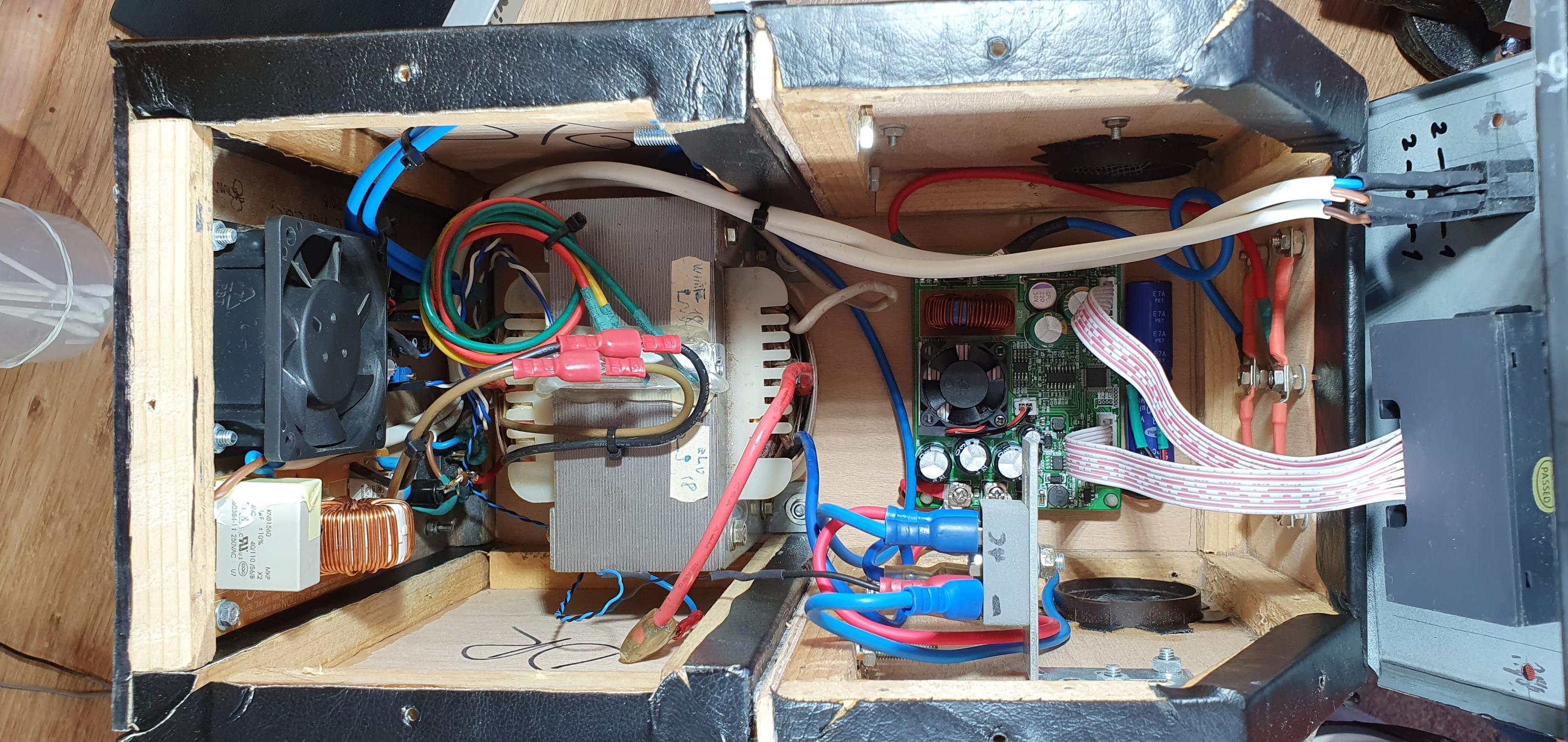

                                          #120
                                          Re: DPS5020 dual power supply build
                                          Just thought I'd share with you guys some pics of my first DPS supply build.
                                          The case work belongs entirely to my old man, so I take no credit for that
                                          The IEC 13 inlet I used on the back has 2 Y caps going between each of the "live" wires and PE (which is useless ATM, because there's no earth on most outlets around here). The PCB on the back where the choke is, is an EMI filter I pulled out of an ATX supply or something, already assembled like that: mains comes in, mains comes out. I thought I'd install it just for the sake of it, though I have no idea if it actually helps in any way or not. It's got some Y caps of its own there, plus some resistors, an X cap and that choke. I actually took some close-ups of this board and discussed it someplace else, but can't remember where right now, unless I start searching around my older threads...
                                          What it's lacking is X caps across the two-pole main power switch on the front panel (right of picture) and Y caps+resistors between secondary GND and PE like we've discussed and debated over...
                                          Wattevah...
