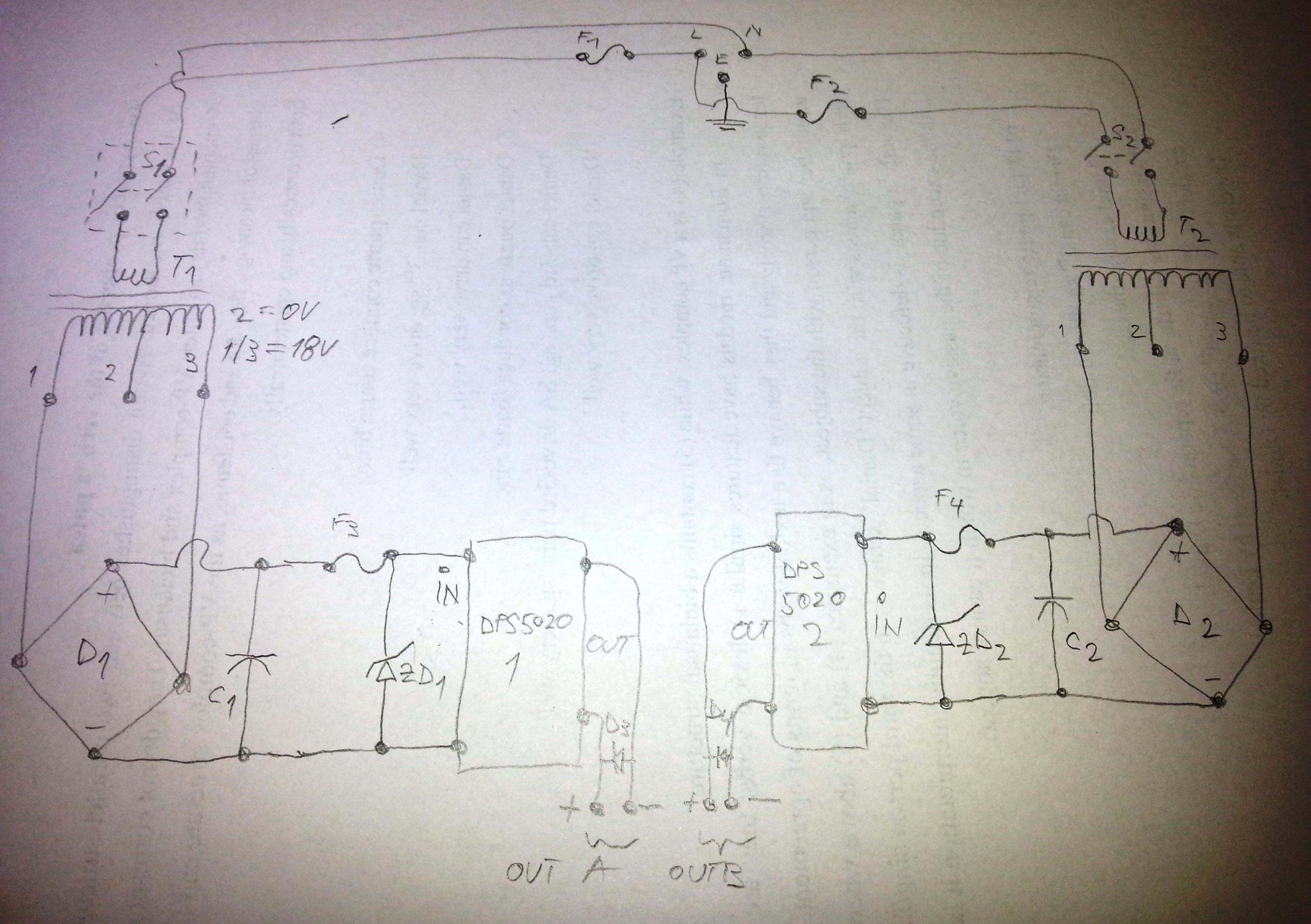

    I laid down a wiring diagram, although it's very simple: there's two circuits side by side, perfectly identical, to form a dual-output bench supply. This way I can have two completely isolated supplies or I can join their GNDs together to have a common-GND dual-output supply which is handy for testing devices which require more than one power rail (12v-5v for instance). That's the theory at least.
    There are some things I still need to work out.
    1) Let's start with the very beginning: notice how I wired the two transformers straight to the 230VAC input - should I look for some sort of EMI filtering there ? If so, what should this be ?
    2) For C1 and C2 I found some caps on Ali which CLAIM to be 10000uF/80V....is bulk capacitance a generally good idea on the input of the DC-DC modules there or should I look for some inductors as well ?
    3) ZD1 and ZD2 - 51v zener diodes. 50v is the maximum input the modules can tolerate. If the 230v input swings too high, the secondary voltage will also increase, possibly past the 50v margin, so supposedly those zeners will become biased and blow F3/F4. Good idea/bad idea ? I fear they may false-trigger often :|
    4) feel free to suggest stuff and improve on my design
    I'll keep you guys posted along the way with pictures of the build Cheers and thanks.

    wth 10000uF...??? Have you done the peak current maths upon power up
    Not to mention EMI filters needed, chokes, ..., and the total cost amount...!!!
    imo, keep it simple, functional, clean and... much cheaper »
    » use DC laptop adapters (eg: 19V~3.5A, 30V~3A) to power the DPS50xx modules.

      Inrush current might be a problem indeed, so I'm trying to come up with something like a soft-start....
      The modules themselves are the most expensive part of the build - the transformers were scored for free out of the junk pile and I already have them, so no money lost there

        i wouldnt worry about chokes, the DP units run at very high frequency and without a scope you would have trouble pinning down any noise to suppress.

              well with regular transformers and rectifiers you have no noise to suppress because your following the sinewave.
              the DP modules may create noise - but maybe not - they have good caps on them.
              and if they do create switching noise, any filter would have to be selected for the frequency you want to block.

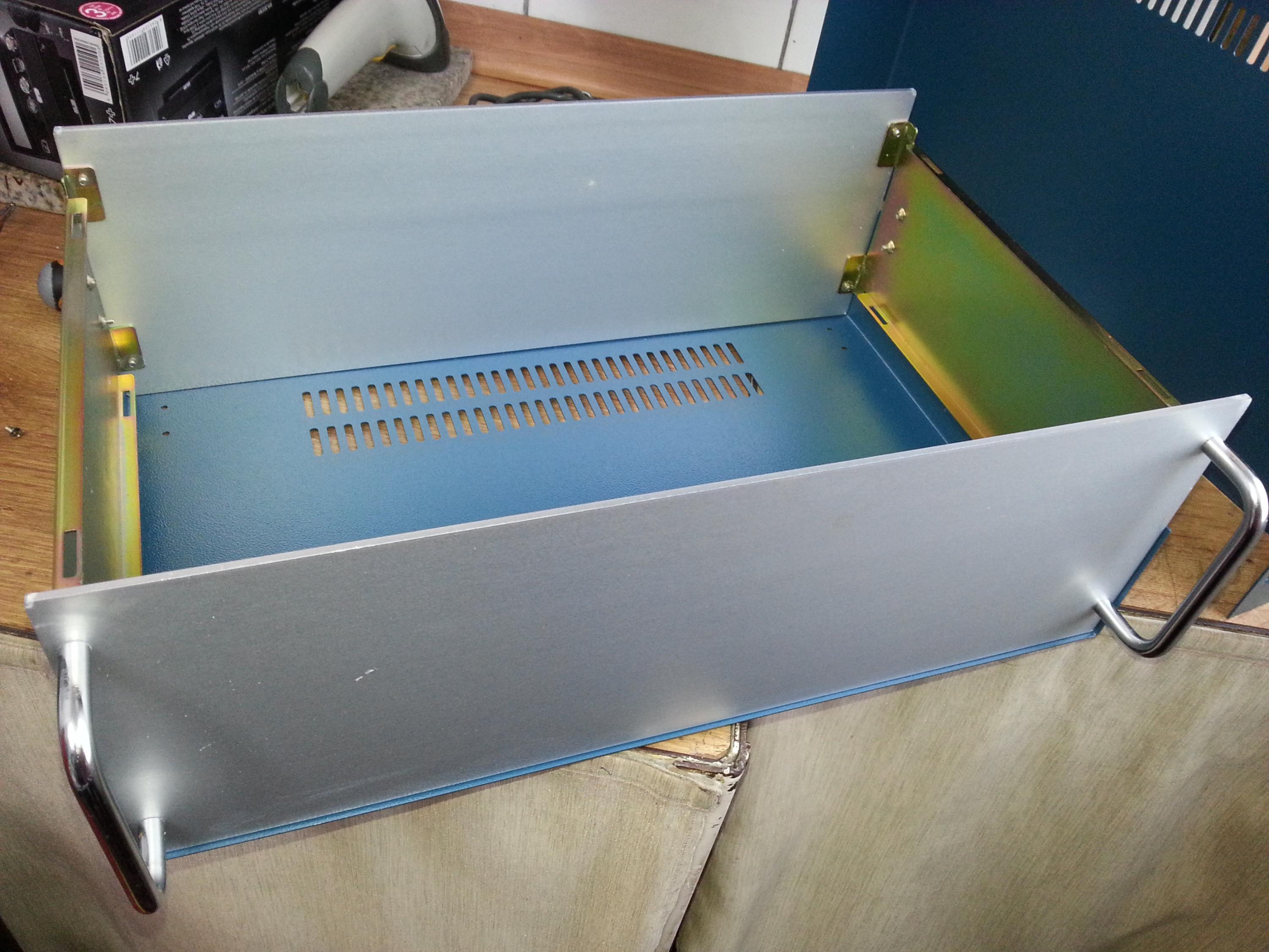

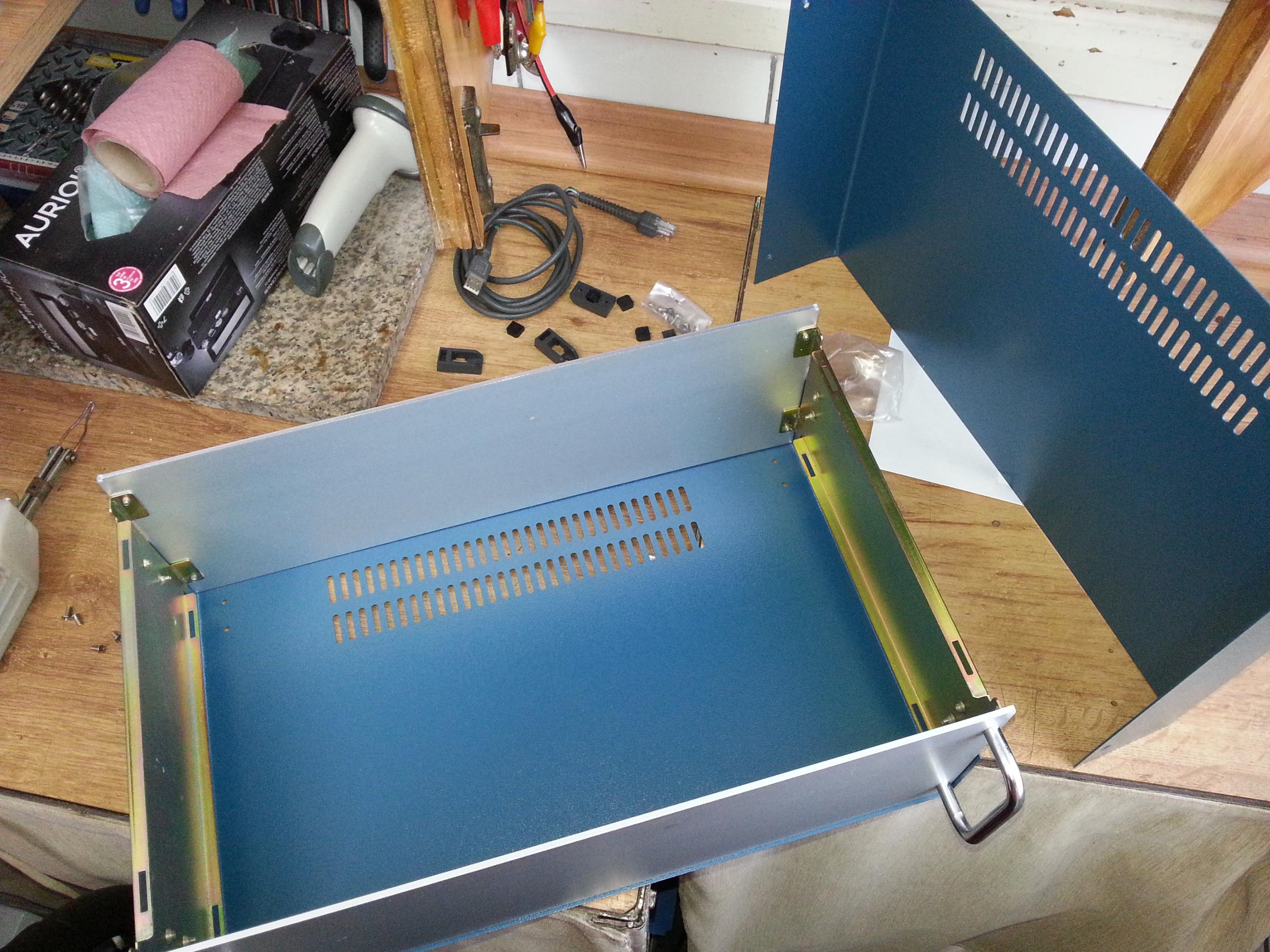

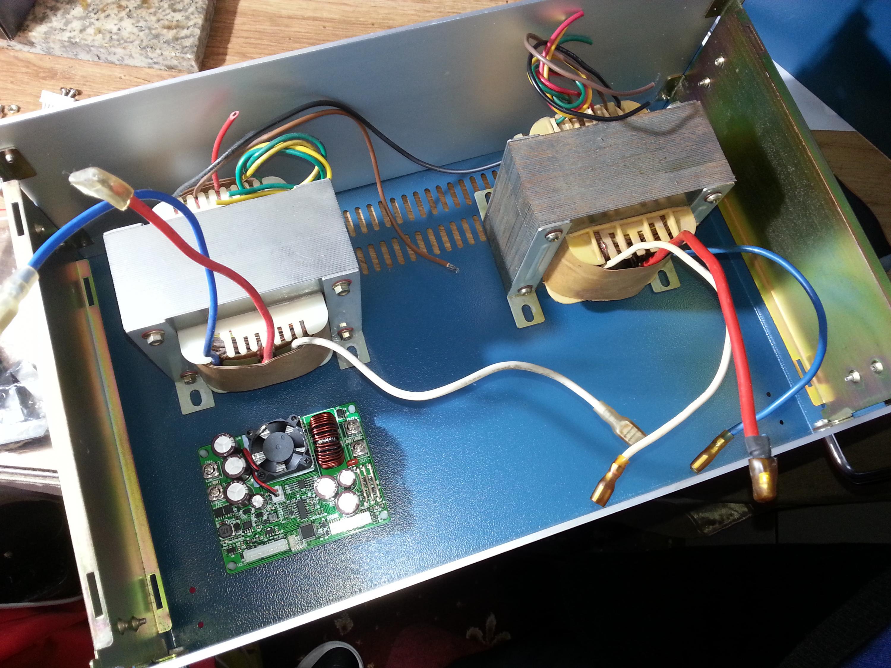

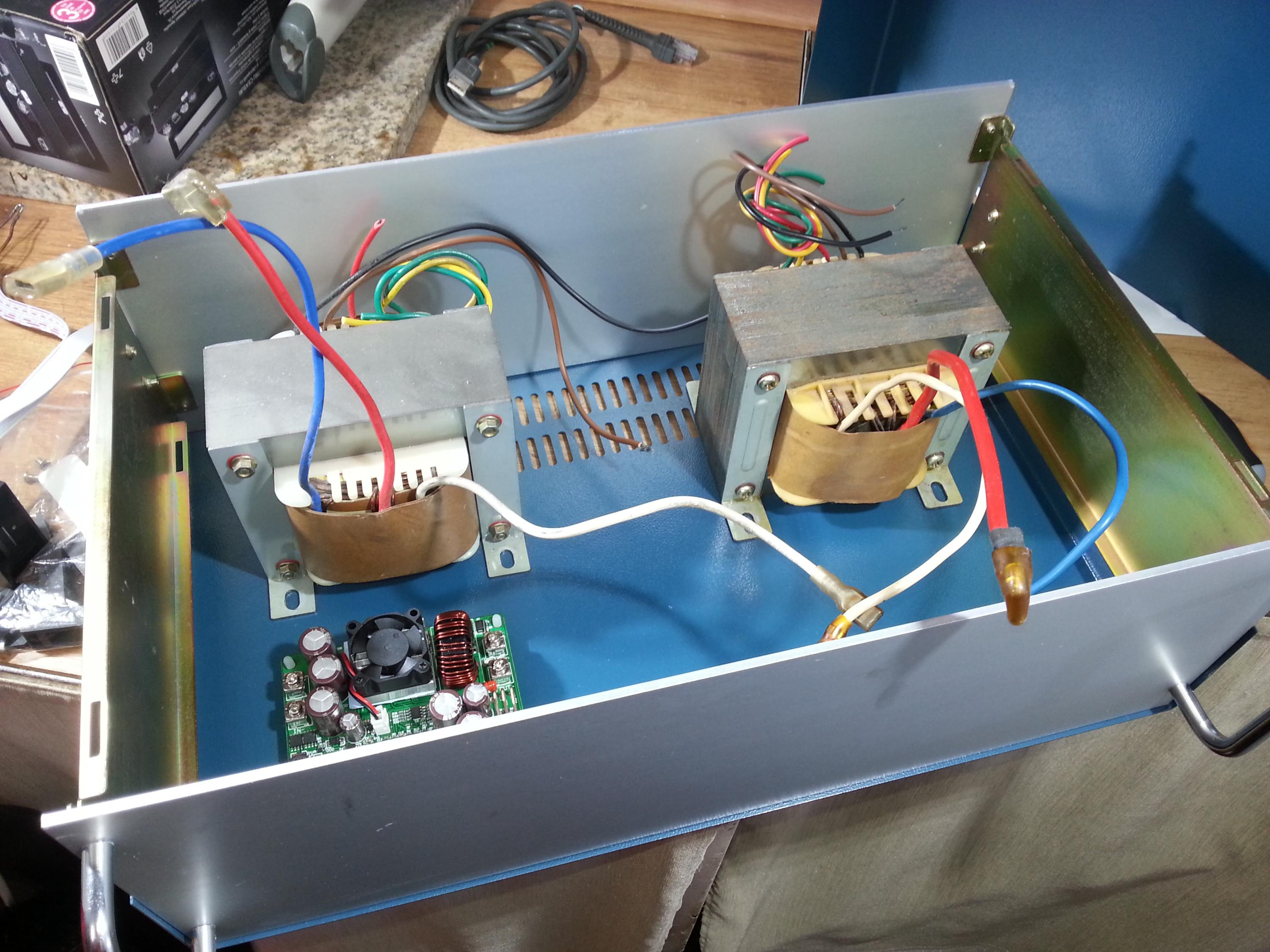

                Here's some pictures of the case that just arrived today and how I plan to lay it all out. Only one PSU module for now as you can see, but I shall prepare the second location as well for when I'll finally get the other one too. I'm actually planning to take the front panel to a CNC or router to have it machined professionally because that's 3mm thick aluminium there...sawing through that and hoping to achieve some precise cutouts would not be fun or easy. This project has gone way overboard already, so might as well go all out. Not sure if those DPS supplies deserve such a nice case, but hey...YOLO
                Wattevah...
                  • 30919
                  Re: DPS5020 dual power supply build
                  oh nice, an oldskool rack case!!

                      I love enclosures like that, could build a power amplifier...
                      With the DPS modules I add (Y-caps 2,200pF or more) from (-) and (+) to chassis GND, to limit HF noise.
                      Once I did try add an output choke and cap, noise was gone but the extra DC resistance ruined the regulation. A clamp-on ferrite could work. It's mainly if you want to power radios or need quiet power with little noise, I add an extra filter on the DPS output.
                      Add a resistor from the bridge rectifier (-) to earth ground to limit the stray voltage due to the power transformer's leakage.
                      Most DPS modules have a low-side N-ch mosfet, so they disconnect output (-) when you command it off. You can check with ohmmeter, there is no continuity from module input (-) to output (-). This can make them confusing.
                      I think the mosfet allows the units to not blow up when charging batteries.
                      I would rotate the bottom so air from the ventilation holes can go by the DPS for cooling.
                      I also use big 10,000uF filter caps with no problems, the modules like that and RuTech recommends several 1000's uF so AC ripple does not stress the module. An 8A bridge or better, with heatsink can take the inrush and steady 5A.
                      Serial comms will be an issue if both DPS modules are floating.

                        Should those caps be on the input or output of the DPS module ? I assume the output. So one cap on the negative leg and the cap on positive, then the remaining legs of the caps tied to chassis GND. Trouble is, although I'll use an IEC 13 connector to power the whole box, which has an earth terminal which I shall tie to the metal case, most buildings aren't actually earthed here
                        Keeping the two modules separate kinda goes out the window, since they now share a common GND.
                        Something like this ? I actually have these after ordering some a while back. Again, should these go on the output or input ? Or perhaps both ?
                        What value should this have ? Just like with the Y caps, this will just sit there probably doing nothing, since there's technically no earth Also, it removes any chance of the two supplies floating...which may not actually be a bad thing in the long run now that I think of it.
                        Yes, I just realized that myself. As soon as you try to connect both USBs to a PC, the ground becomes common. One workaround would be to use the BT functionality. The trade-off of course is that you can't have both connected at the same time, unless you use two PCs, each running an instance of the software. I doubt it can run multi-instance on the same machine to allow controlling two or more supplies in real time. Haven't tried that yet. It would be interesting to find out.

                          dont link anything after the transformers to ground.
                          it will cause problems if you want to tie the 2 channels together as a split-rail output.
                          you can get usb isolators from china for beer money.
                          why not put a dirt-cheap hub in too - so you only need one external connector.
                          btw, how does the usb know which module your addressing? do they have configurable i.d.'s??

                              earthing, earth the rack case and the transformer bodies - although that will happen through the bolts anyway.
                              split-rail,
                              you connect the - of one channel to the + of the other channel.
                              so instead of [0v +15v] [ 0v +15v]
                              you have [-15v 0v-0v +15v]
                              if you did that and there was common ground you would short out the first channel.
                              • Dannyx
