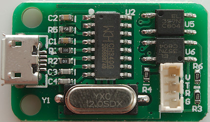

    the metal of the usb is frame-ground - it should be seperate from the 0v pin.
    but that's not important, what matters is the side that plugs into the psu - that's opto-isolated from the usb side.
    so you should be o.k.
    check it - plug the adapter in and ohm between the usb socket and the ground on the psu module

            Originally posted by stj
            no, the usb to serial boards are optically isolated.
            as long as they are not touching the metal case the pc wont be referenced to the psu's
            @Dannyx
            Did you forgot our previous discussion here...?
            Plus stj post i've quoted gave you another hint (psu metal case)
            and a relief concerning usb port to serial boards being optically isolated.
            WTH how did you manage to forgot the main power switch at the psu front panel...???
            [Your father, besides being good craftsman (my congratulations to him )
            is a good guy to put up with his son laziness (shame on you )]

              Originally posted by megaraider
              @Dannyx
              No, I didn't forget that. I went over the thread several times, since I was still a bit confused as to whether or not I should connect anything to the case. Running the two modules in series is not a priority to me ATM and I'm not even sure it could be done....can DC-DC converters like these even be wired in series ? However, keeping them separate to allow for a split-supply IS important, otherwise I would've just had a common GND at all times, including on the case.

                          Originally posted by Dannyx
                          Second side done
                          Looks really good. I add a PE GND green binding post in case I need it.
                          The DPS5020-USB board has two opto-isolators, so the USB should be OK. The shell can touch chassis PE ground or float unconnected.

                              Re: DPS5020 dual power supply build
                              Yes, you are right: the metal shell of the micro USB connector does not contact the GND of that output header which plugs into the PSU module itself. I checked it today.
