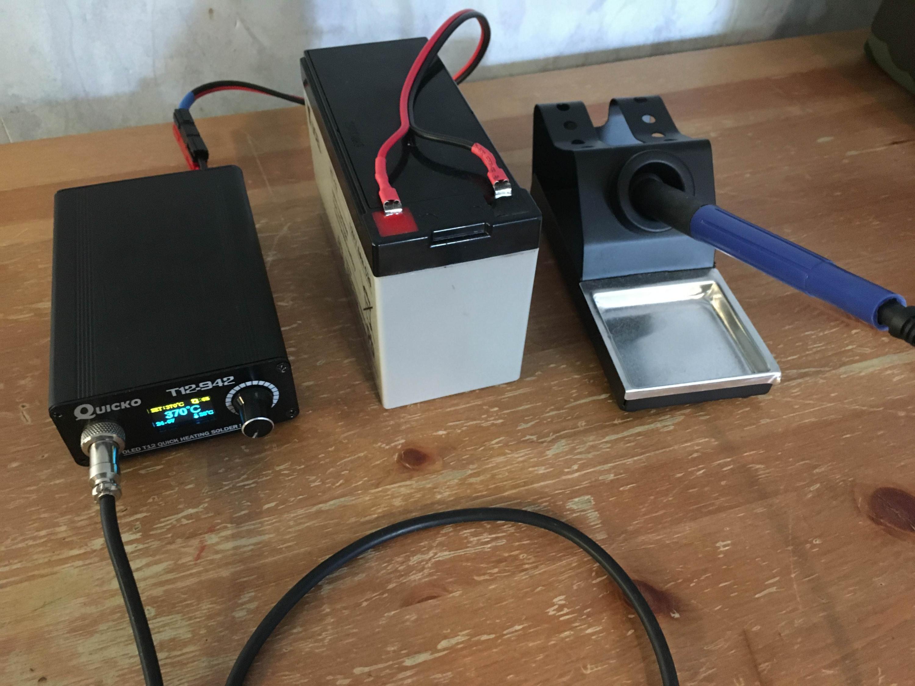

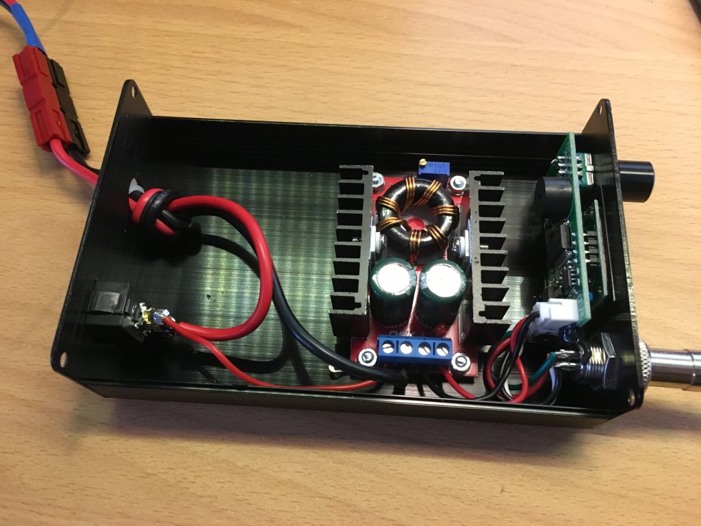

            I see lots of T12 soldering stations, some low cost $26 due to plastic housing and a STC 7-seg display controller. Older STM32 OLED controllers overheat the linear voltage regulator. It looks like lower cost and more selection for T12.
            I did like this T12 with boost-converter and 12V gel-cell bd139 built. It seems to need 24VDC at 3A max. for a few seconds on warm up. Or XT60 RC hobby connector or cig lighter for input.
                Be careful when connecting to car cigar lighter... 80W plus is pushy, might burn the fuse.

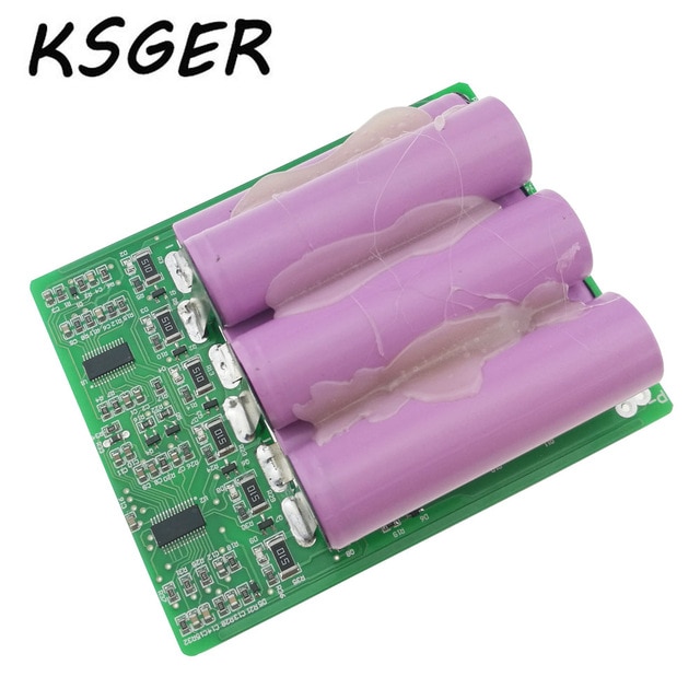

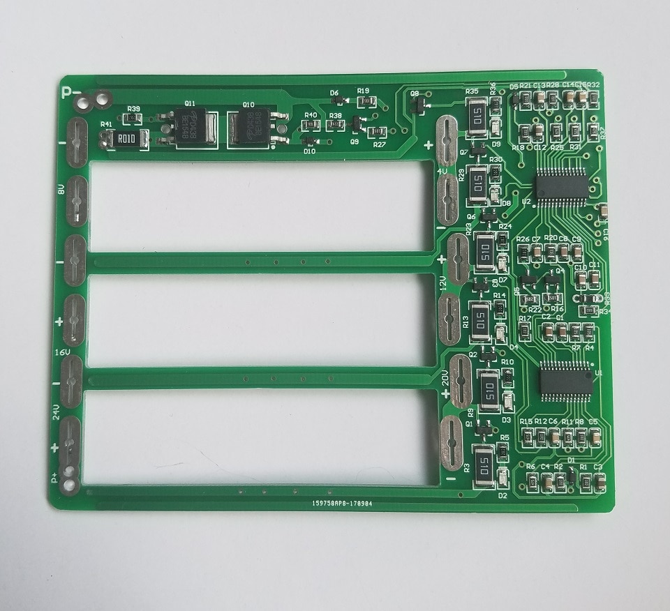

                                I see a KSGER T12 battery-powered station uses six 18650 2,500mAh batteries 6S1P with BMS. Brick is 25.2V 2A.
                                The BMS board alone is around $15 USD, and the batteries are heavy. It's alot of battery power.

                                A 12V->24VDC boost-converter would make 24V 3A from 12V 7.5A (80% efficiency), or 19V 4.7A 56W if using fewer batteries:
                                6S 22.2V 2.8A direct drive 61W
                                5S 18.5V 2.3A direct drive 43W
                                4S 14.8V 1.9A direct drive 27W
                                4S 14.8V 3.8A with 19V boost 56W
                                3S 11.1V 5.1A with 19V boost 56W
                                2S 7.4V 7.6A with 19V boost 56W
                                It's only full power for 10 seconds on warm up or soldering big joints.

                                  I bought two Ksger batteries protection for this soldering iron I want try them out and see how well they work
                                  Battery-powered T12 Soldering Station Dedicated 6-series Lithium Battery 24v25.2v Balanced Protection Board
