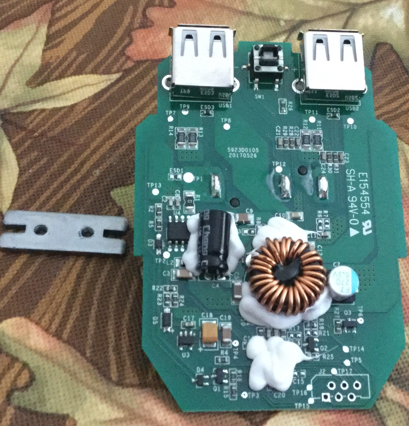

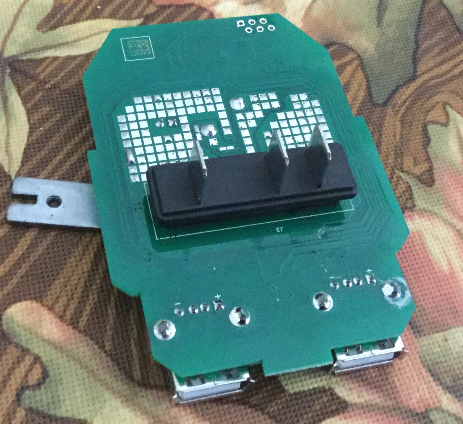

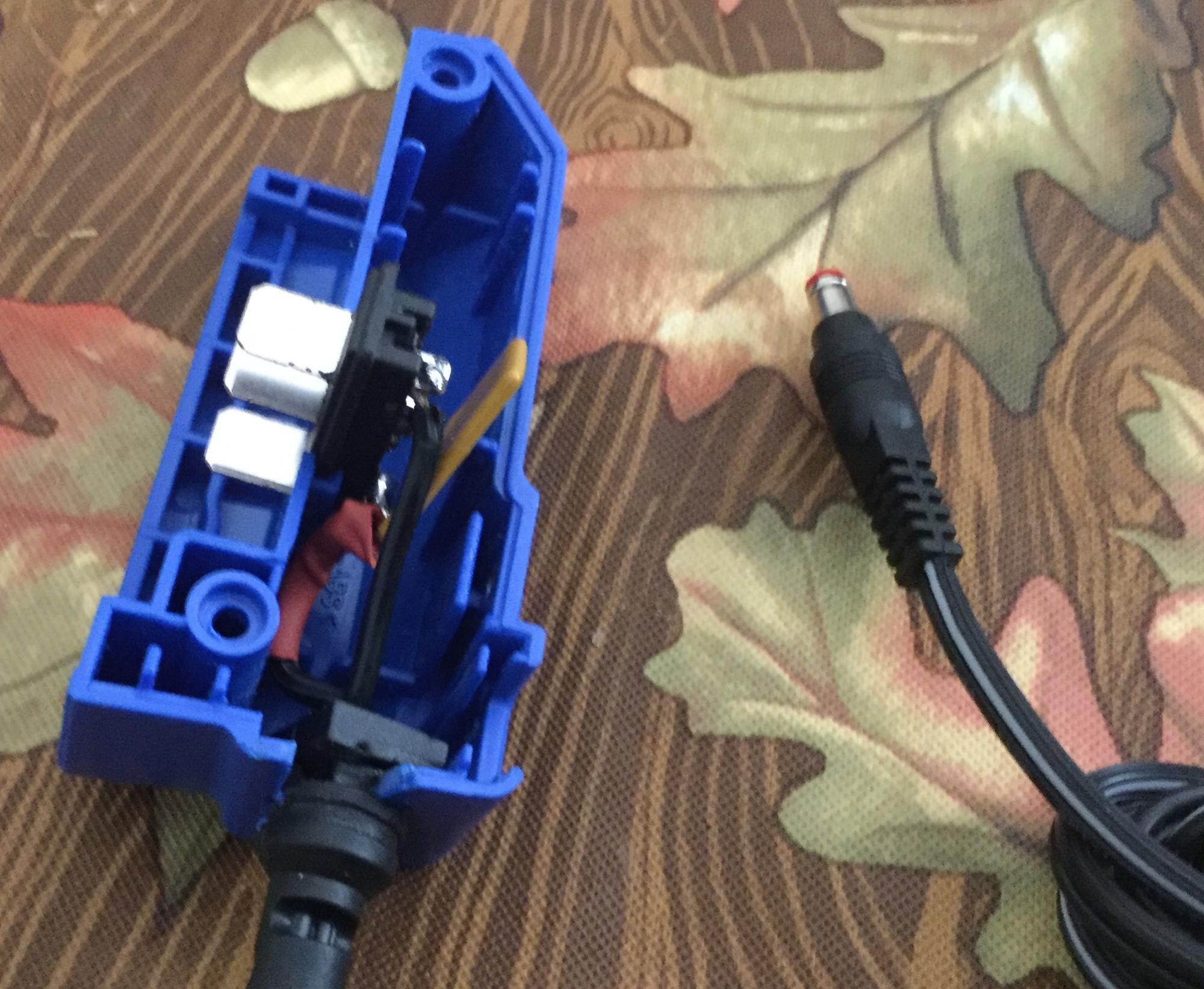

                  Here is the battery pack for a battery operated soldering iron
                  This unit cost $20.00 and very is hack and easy convert to power this soldering iron

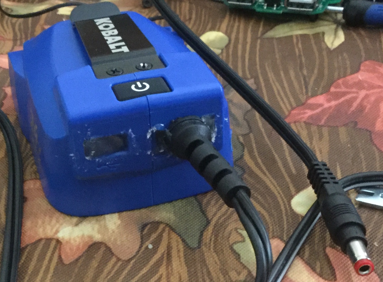

                    Here is a picture of the setup that I come up with
                    All battery parts were bought at Lowe’s Store *
                    The USB charger converter $20.00 *
                    The battery 4amph $50.00 *
                    The battery charger $25.00 *
                    The soldering controller $13.00 * AliExpress
                    So for $103.00 I have a very good setup
                    I used a 5 amp re-set-able fuse going to the power cord
                    I still going to convert a ZD-915 soldering station and use the same USB converter housing to power this unit as well now that I found a 24 volt battery pack for fairly good price
                    One note I have seen a tear down ( on You Tube ) of this battery pack and they do use very good quality batteries in there battery pack
                    One other note what I like about this soldering controller is that when you do not touch the iron for a little while it goes into the sleep mode and if you still do not touch it goes into power down mode very important feature for it being used on battery power ( and very inconvenient if being you are powering it on a home outlet the power down mode)

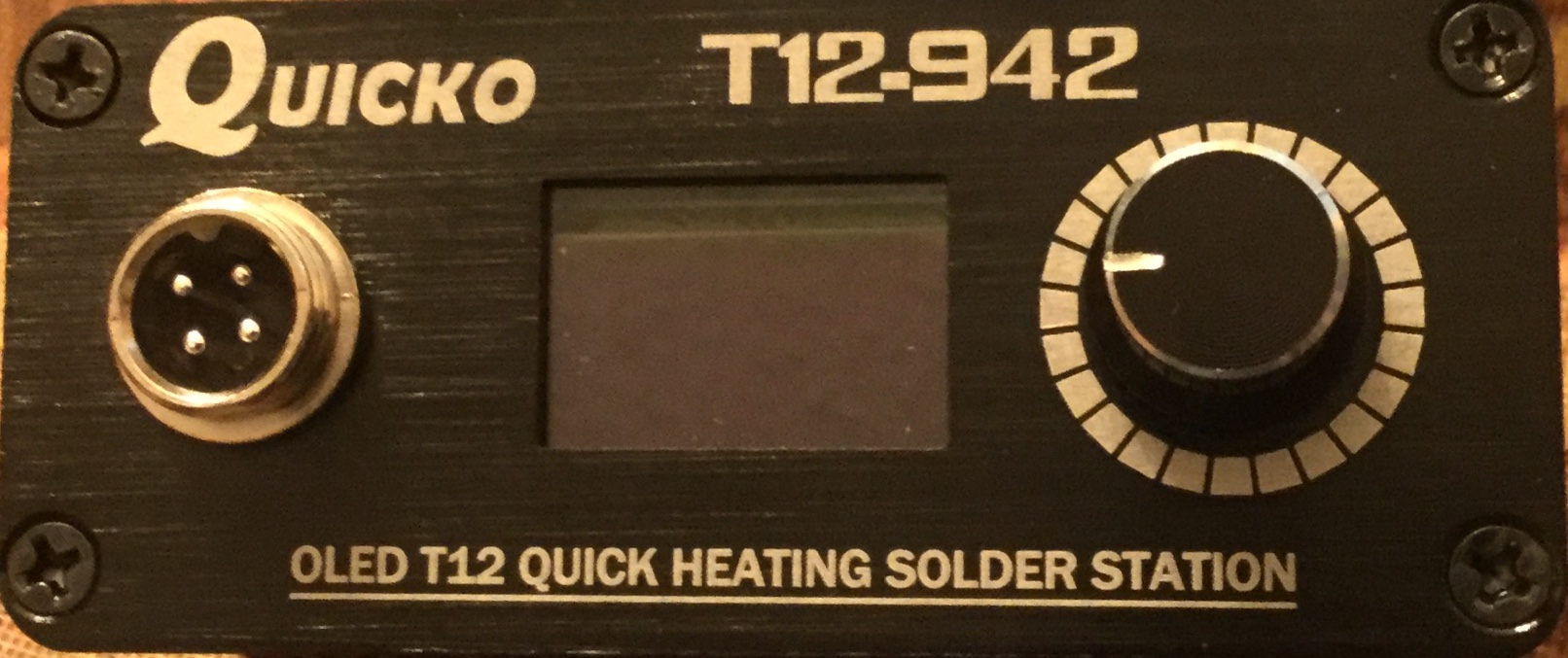

                          Here is a photo of the other version of this soldering iron controller
                          This works a little bit different I have figured out how to go into the menu and set the sleep and shut down timers for how I want it to work on battery power
                          Quicko T12-942
                          I just love this version of this this soldering iron controller
                          I just have one complaint about it and that is that does not have the feature that when you turn the encoder switch to the left it put it into the sleep mode or the power down mode but I can live with it
                          That the Ksger model does have this feature but it is a pain to set the temperature you frist have to push the temperature encoder switch then you can change the temperature
                          But like said earlier I like and dislike some features on each one
                          But what I do like about both of them are the tips are that they are very easy to use and heat very well
