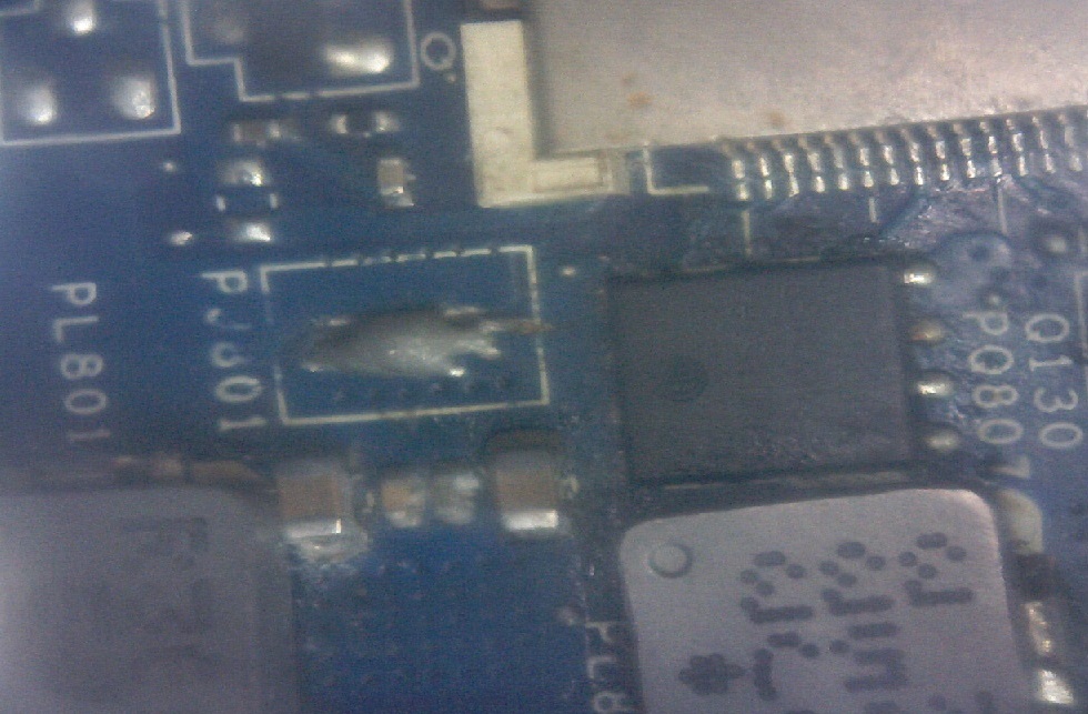

    Dear Technicians,
    I have a bad experience in soldering:
    Two months ago, I soldered the point of PJ801 (in the photo) on a laptop mainboard using flux and leaded solder. Then, I cleaned the area using pure paint thinner. I did not used any other substance. but there was still some flux residues which I refused to clean. I did this because I did not want to use too much thinner.
    Today, the customer came back. I opened the laptop and observed one side of the capacitors in the area got a dark color. Even the solder of PJ801 became dark. This is what happens to capacitors when they get liquid damaged. but the other pins of the components look shinny.
    In the photo, I noticed that the flux residues are gray-colored too. Probably, the thinner made brown flux turn gray.
    Now my questions are:
    Why have this liquid-damage happened?
    What did I do wrong in that soldering?
    Was the liquid-damage due to flux residues or something else?
    note: I do not use my isopropyl alcohol because I used it sometimes but it had the following problems:
    1- It could not clean the flux completely.
    2- It could not clean glue from the board.
    3- It leaded to liquid damage too. It may be mixed with water by the maker.
    Then, I decided to use paint thinner which is stronger and can clean flux and glue completely.
    thanks

    Re: How to avoid Liquid Damage due to Soldering
    I always and only use 99% Isopropanol for cleaning boards and flux. It doesn't cause any damage and dries perfectly leaving no residue. IPA is hydroscopic, it absorbs water but stored and dispensed properly and this isn't an issue. I use an antistatic brush for stubborn parts and foam swabs to clean up. I've never had any issue with a board after repair and clean up.
    What's in the paint thinner you used ? there's many types/formulations.
    The customer either spilled liquid in the exact same place, or what was in your paint thinner/flux did the damage, not being cleaned properly.
    What flux do you use ? some are water based.
      The thinner is colorless and is called "Instant Thinner". Its ingredients were not mentioned by the maker. It was recommended for cleaning nitro cellulose paint, clear lacquer, polyester lacquer, putty, primers, and washing industrial components. It does not seem to contain water, because it completely evaporates when I leave a drop of it on a surface.
      The flux is an ordinary liquid flux made by an unknown maker. It may contain water, but I do not know. It is pretty oily and looks like a solid paste flux that was heated and became liquid. When I leave a drop of it on a surface, it gets dry and solid after a few days.
      The flux is brown. When I pour thinner or isopropyl alcohol on it, it turns dark gray.
      I found a photo that looks like the thinner which I use.
      Any ideas on why the capacitors turned gray in one side?
      In general, what substances can make such a damage on capacitors?
        Only you can tell if the liquid has come from the customer.
        If its not from the customer it's from you. I use genuine Amtech 599 no clean tacky flux, cleans away easily with Isopropanol.
        Perhaps when you didn't clean the board properly, heat made what was left on the board flow towards the caps and that's what damaged them.
          Probably, there was no liquid by the customer.
          can flux residues damage the capacitors like what happened?
            Decent flux won't, neither will isopropanol.
              I have to change my cleaning methods.
              If we consider flux residues that were mixed with thinner and turned dark gray, cam them damage the capacitors like what happened?
              Is it possible the instant thinner makes solder joints weak? or no such problem to worry about?
                            Thanks for all the replies.
                            Finally I found the problem:
                            I discovered that the board was exposed to a bit of water. most areas of the board are clean now. but the points that contained my flux residues, absorbed the water. So only those points were damaged on the board because those points made the water to stay. This is what happened to the capacitors.
                            The flux residues did not damage the capacitors directly. because I used the same flux and thinner on another board and it is still fine.
                            At least, we learned something.
