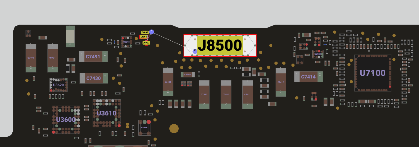

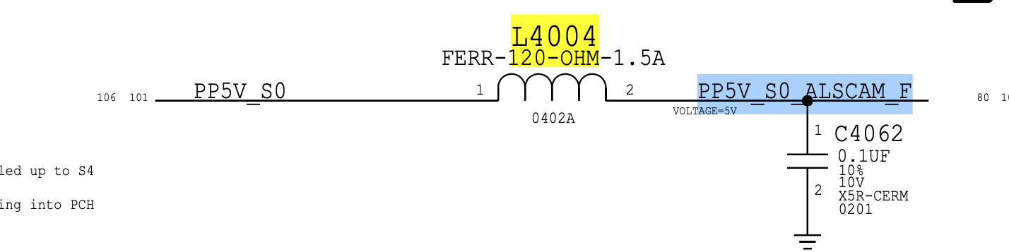

    My mac had liquid damage a long time ago, the connector from J8500 is damaged on pin 46 (PP5V_S0_ALSCAM_F), I guess the LCD/display panel is in short circuit, as I saw the connector from the LCD burned as well.
    And the resistor L4004 is literally burned.
    From what I see from the schematics, it does not affect any other rails, only the connection to the display port.
    (see attached photo L4004-J8500)
    (see attached photo L4004-120OHM)

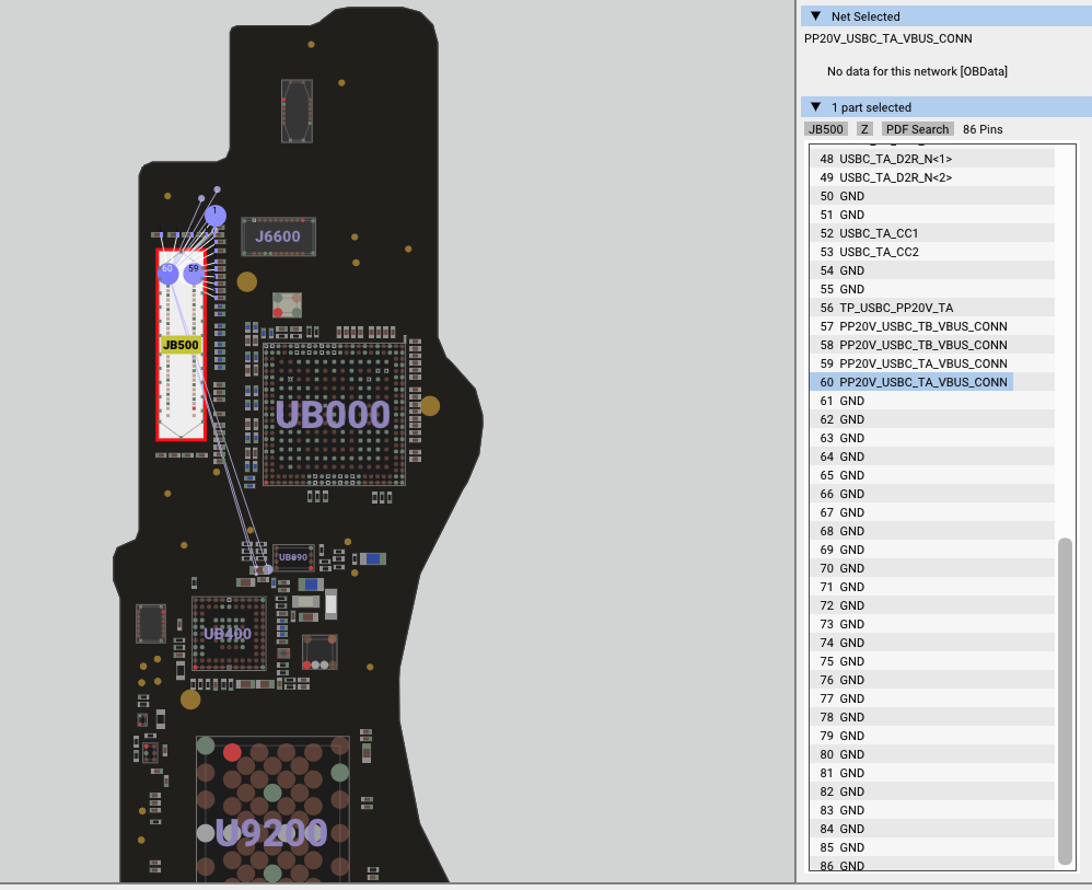

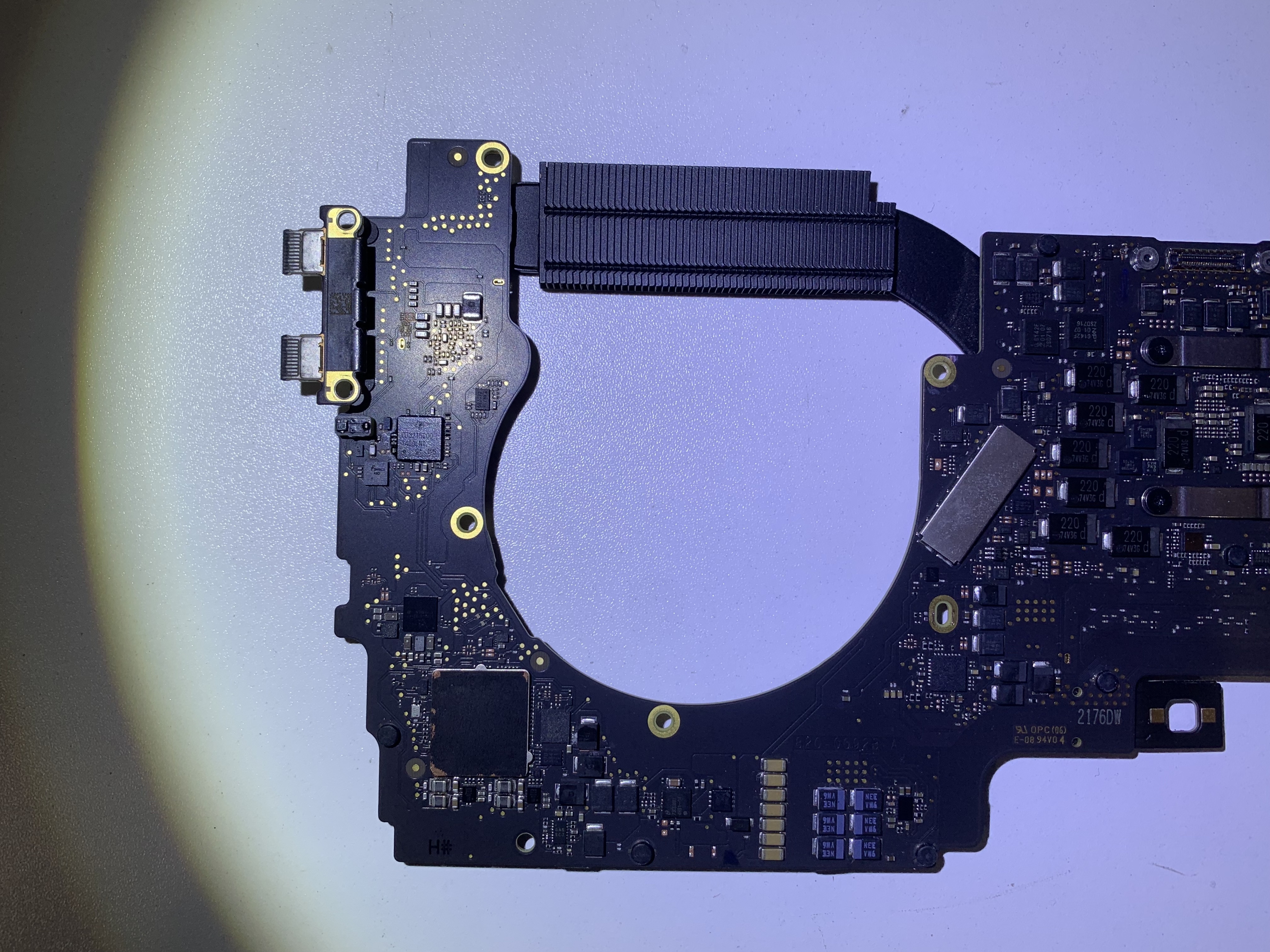

    I have checked, they removed the USB-C port from the motherboard: JB500 ( left side of the board, but USB-C when mac is on the desk is on right side )
    (see attached photo JB500)
    I have checked the board there where and the connector were removed, and I saw a little bit of small burn/scratch on the 20V+ connectors:
    PP20V_USBC_TA_VBUS_CONN
    PP20V_USBC_TB_VBUS_CONN
    And also on the USBC connector from the mac case on the same pins.

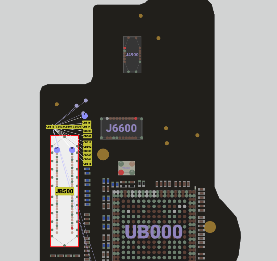

    One note, I think they removed CB513 from the left side of the board near the USBC connector. ( as I see it missing, and on the right side, all 4 are there )
    (see attached photo CB513)
    Usually I charge my mac from the right side, so I think, after the liquid damage, the USBC right side got burned, and also on the LCD side on L4004

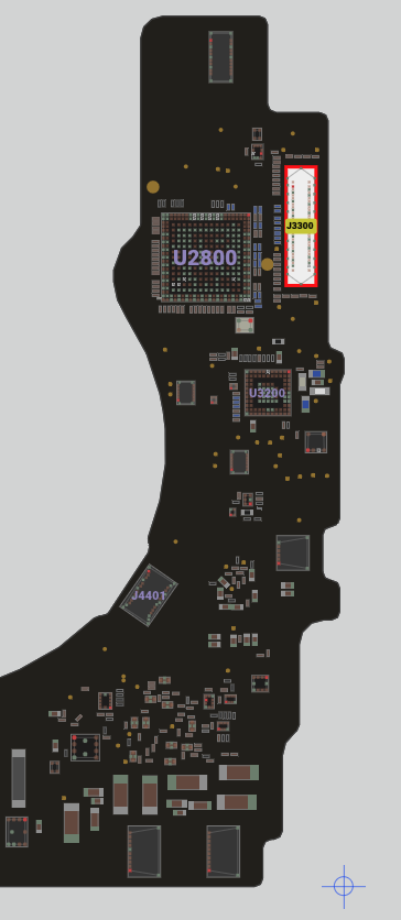

    Without connecting the LCD or L4004, can I start debugging the board from the USBC that is in place ( J3300 ) and connect it to the charger and start measuring stuff? ( without connecting anything, no keyboard, no battery, no LCD, no nothing, just the board )
    Or it will get burned the connector J3300 as well?
    (see attached photo J3300)​

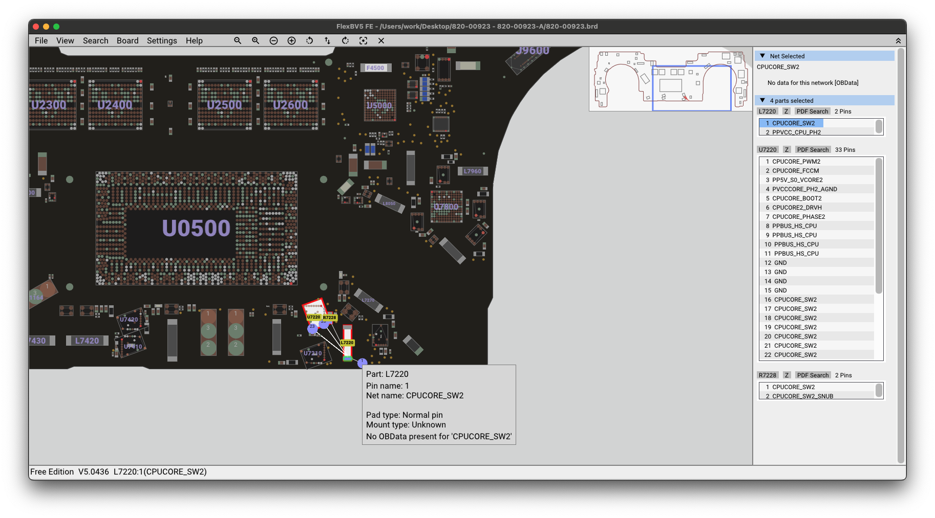

              - Multimeter in resistance mode, at 200
              - Black probe at GND of the motherboard
              - Red probe of multimeter at CPUCORE_SW1 ( from L7210 )
              - Red probe of multimeter at CPUCORE_SW2 ( from L7220 )
              >>>> On both core test had 6.1 ohm

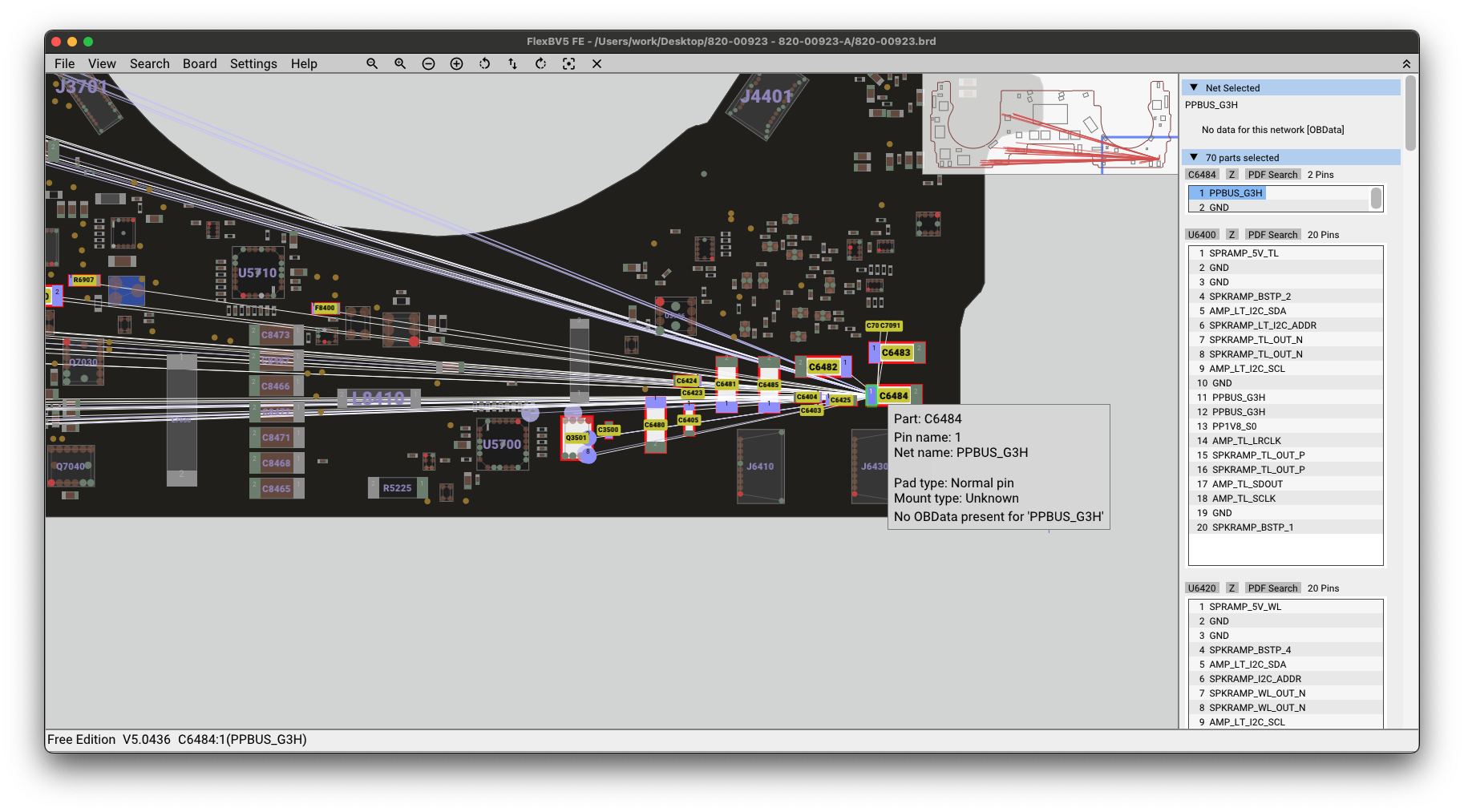

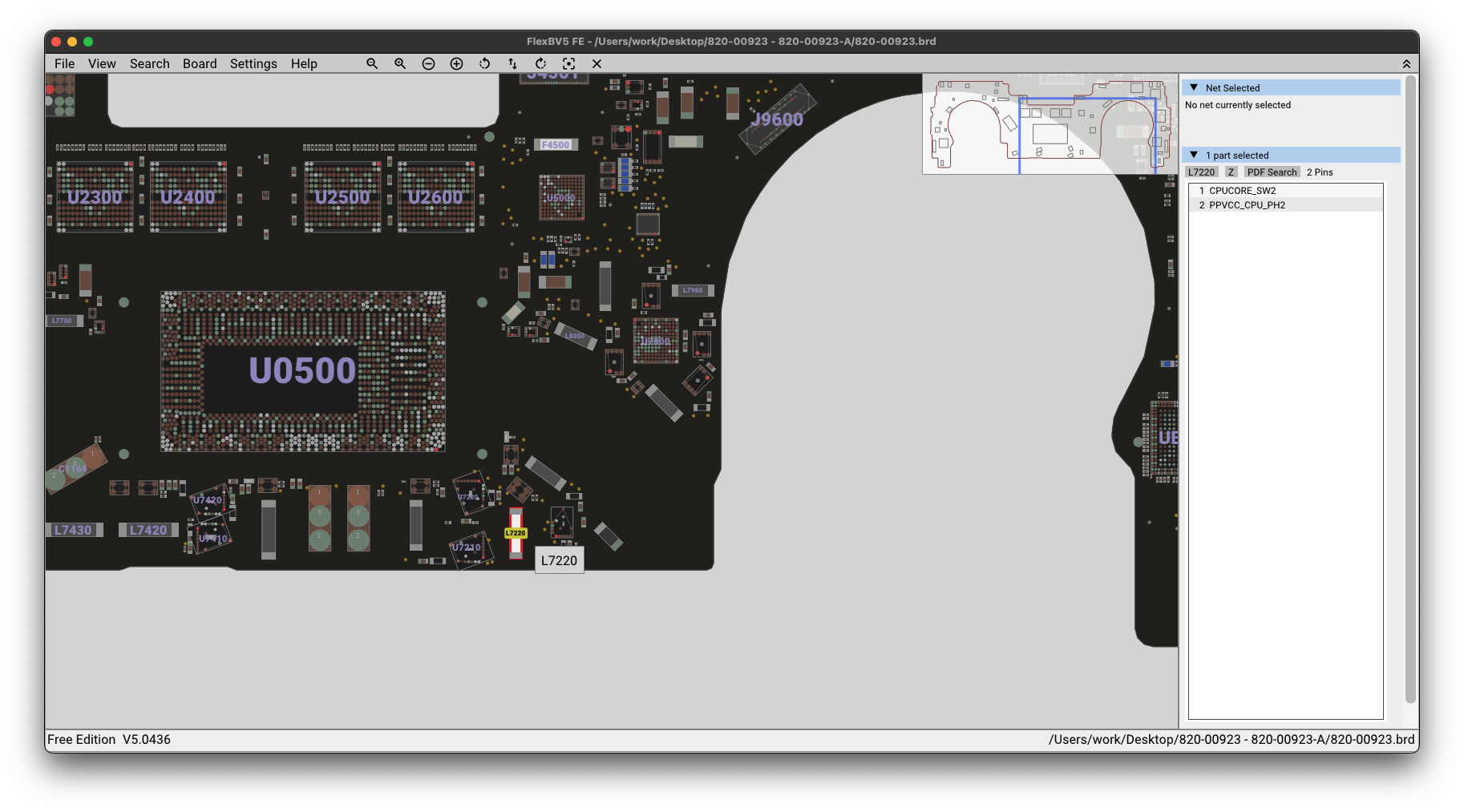

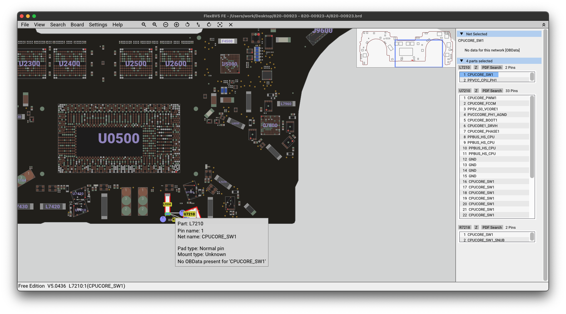

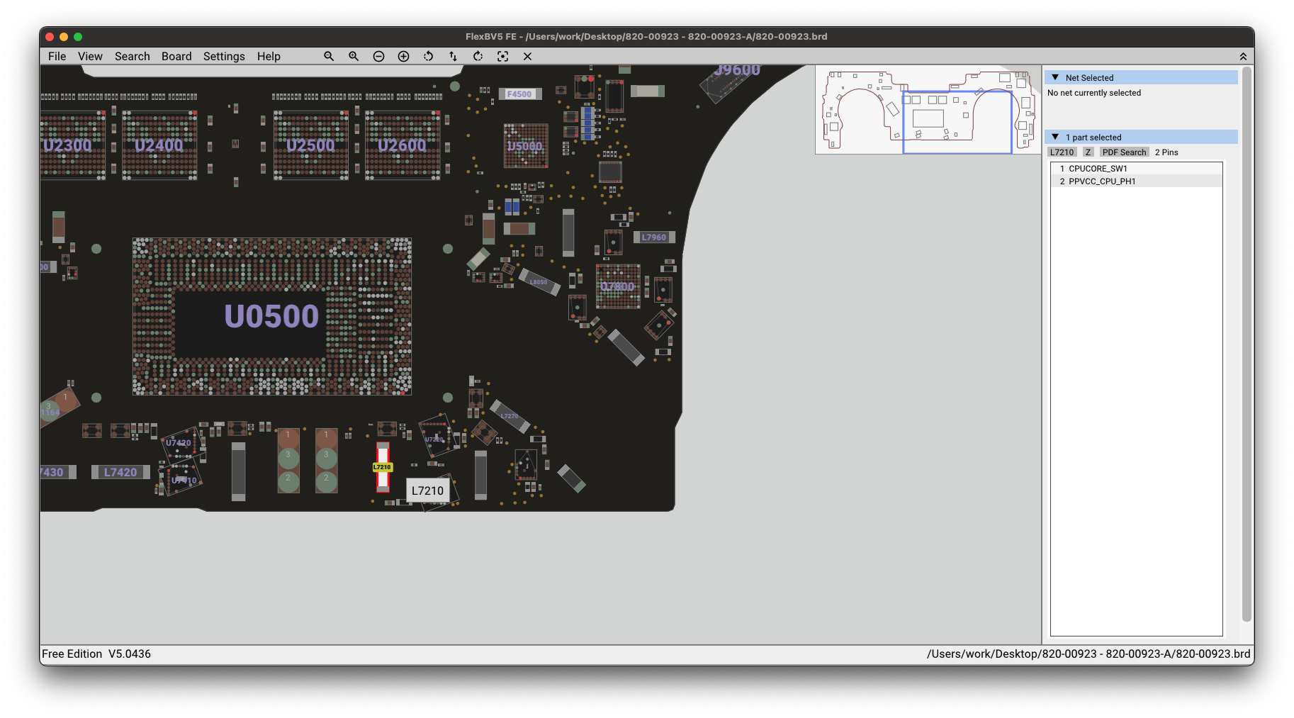

              Second measurement I did:
              • Multimeter in resistance mode, at 20k
              • Black probe at PPBUS_G3H ( from C6483 where I had 13V in the past )
              • Red probe at PPVCC_CPU_PH1 and then at PPVCC_CPU_PH2 ( from L7210 respectively L7220 )
              • It started to show on multimeter 6 ( I think 6kOHM ), and then it kept rising, and at around 10k I've removed the probes.

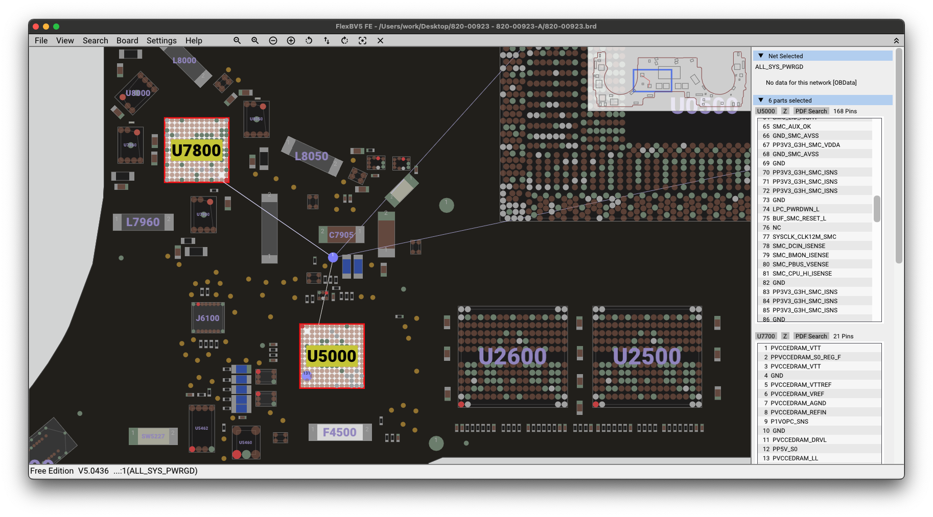

              *Attaching some pictures with the schematic.
              • mon2
                • Dec 2019
                • 14213

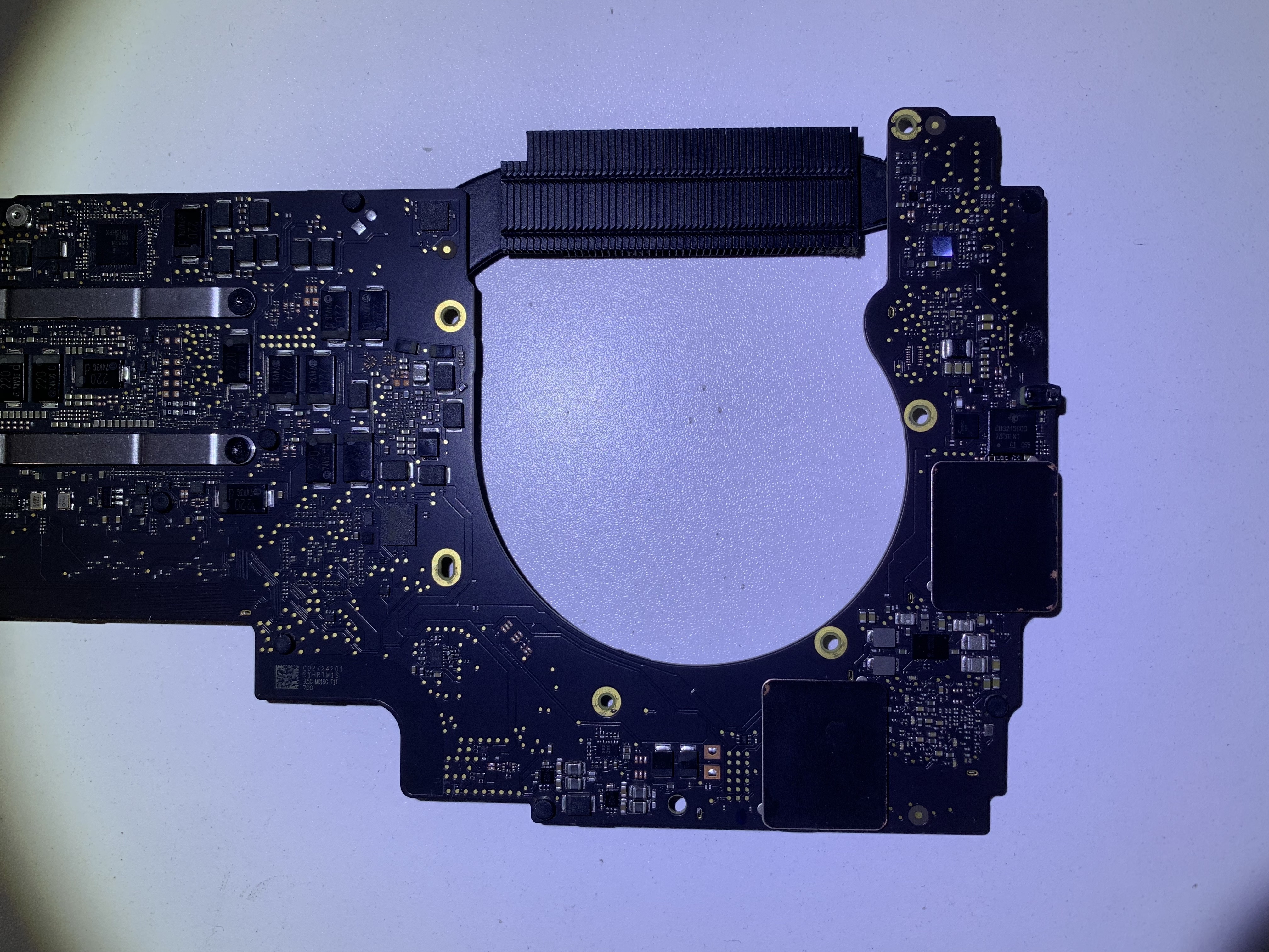

                Correcting my incorrect comment - if you have PPBUS_G3H then PPBUS_G3H is not shorted. Respectively, believe your CPU is ok.

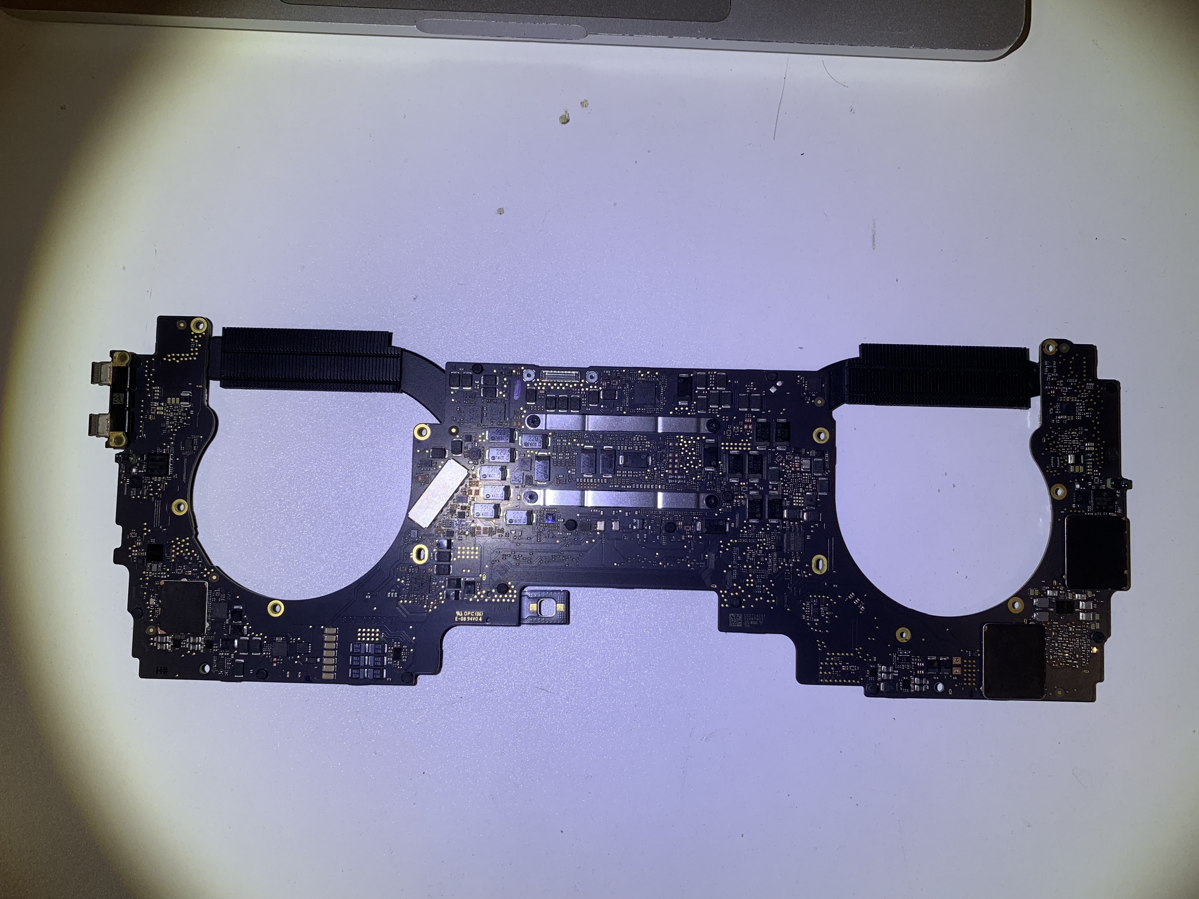

                Do you have actual pics of your board that can be posted? Not boardview screen grabs. Suggest to pickup a bidirectional USB C meter from Amazon or similar. Then we can know the voltage and current draw of the logic board which can assist in debugging your case. Lots of similar cases on repairwiki, etc.
                Any fan spin?
                What is the voltage to ground of ALL_SYS_PWRGD? This is a power good signal that should be a logic '1' if all power rails are deemed to be OK.

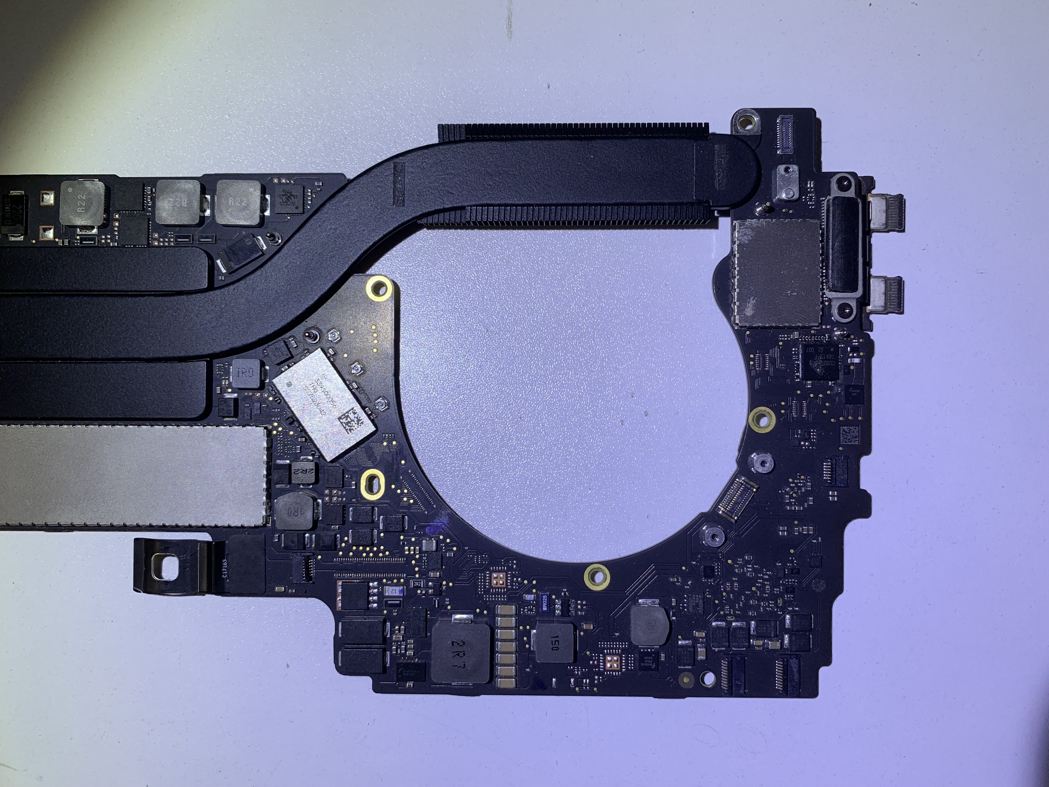

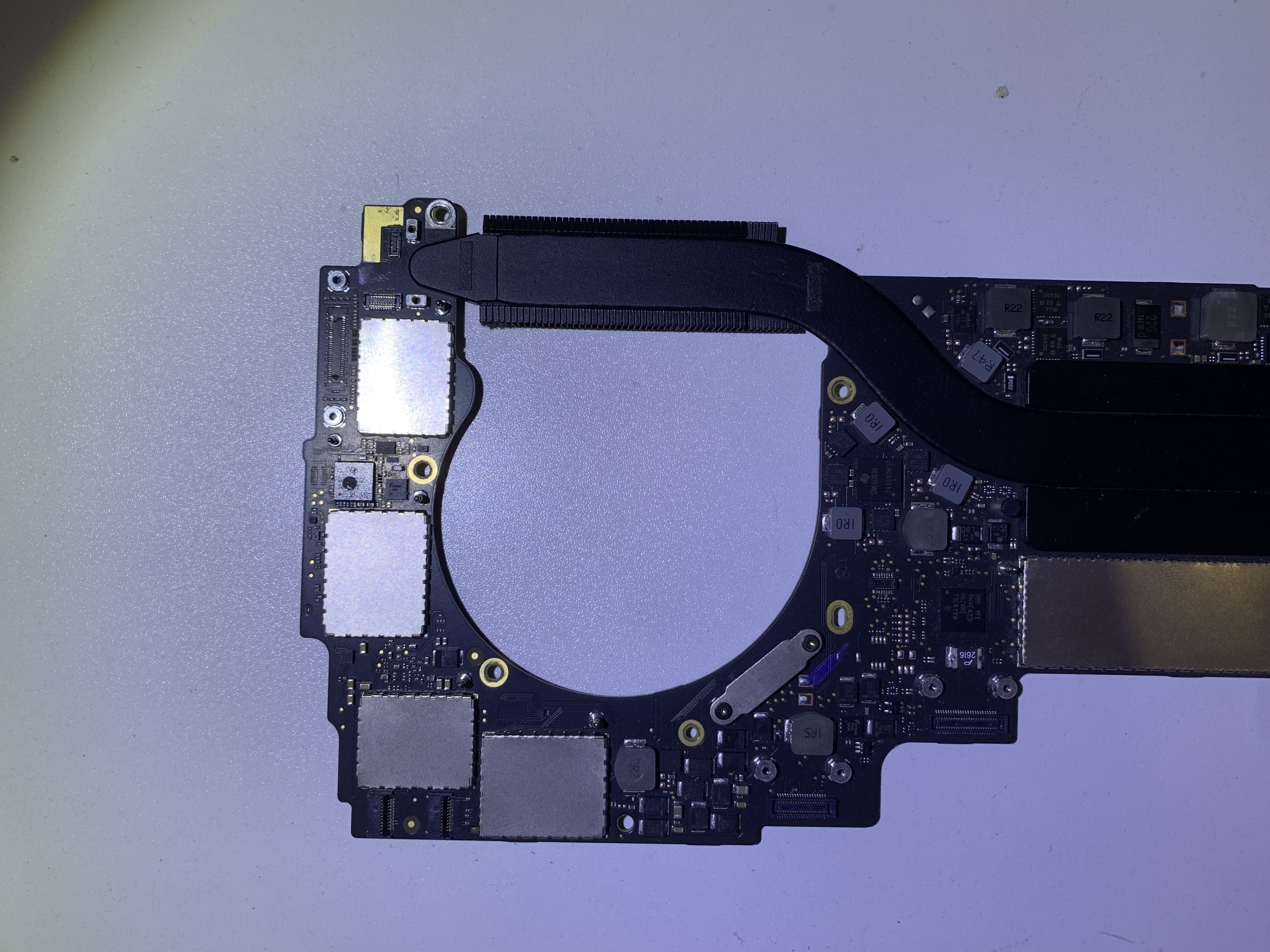

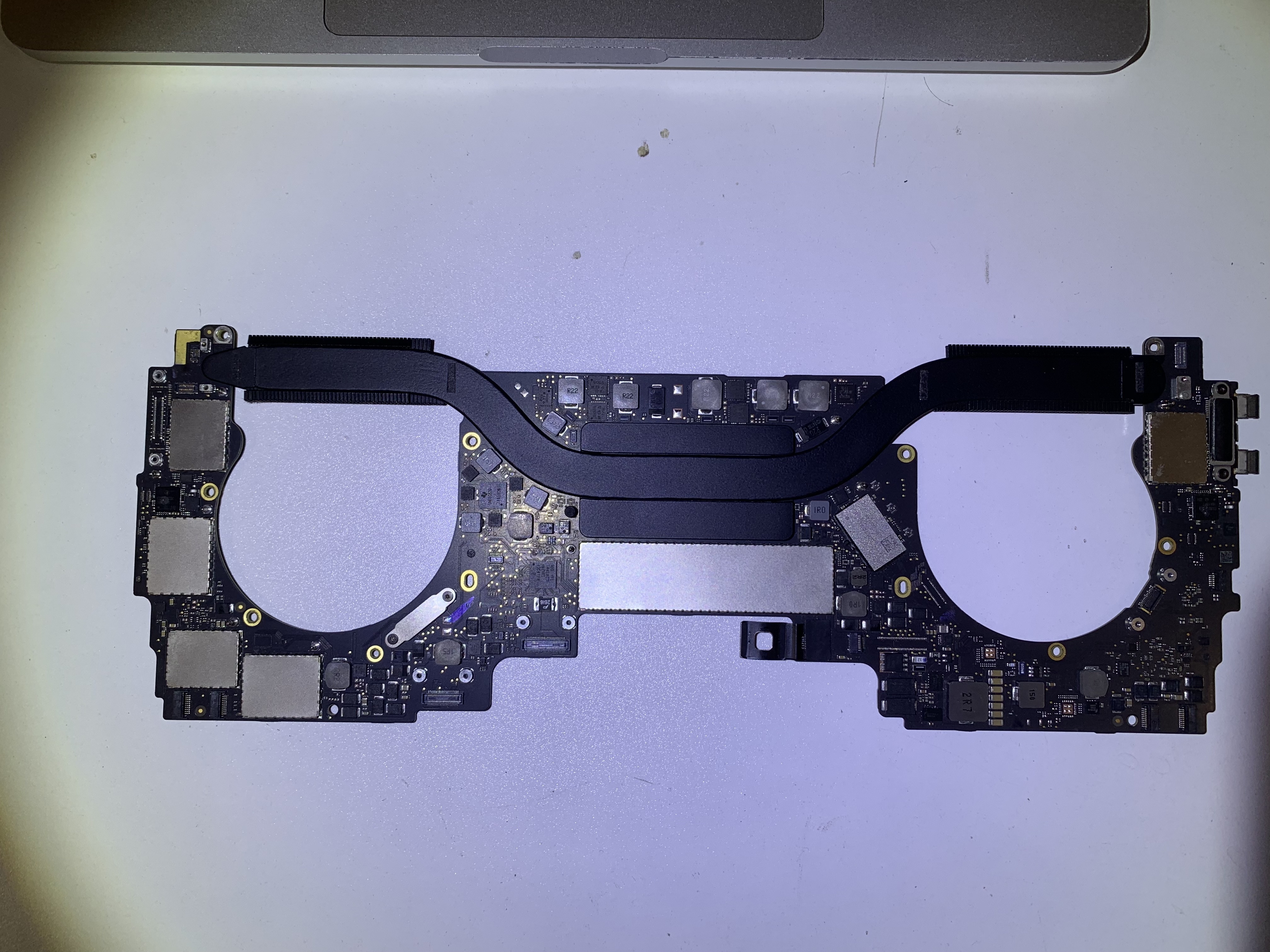

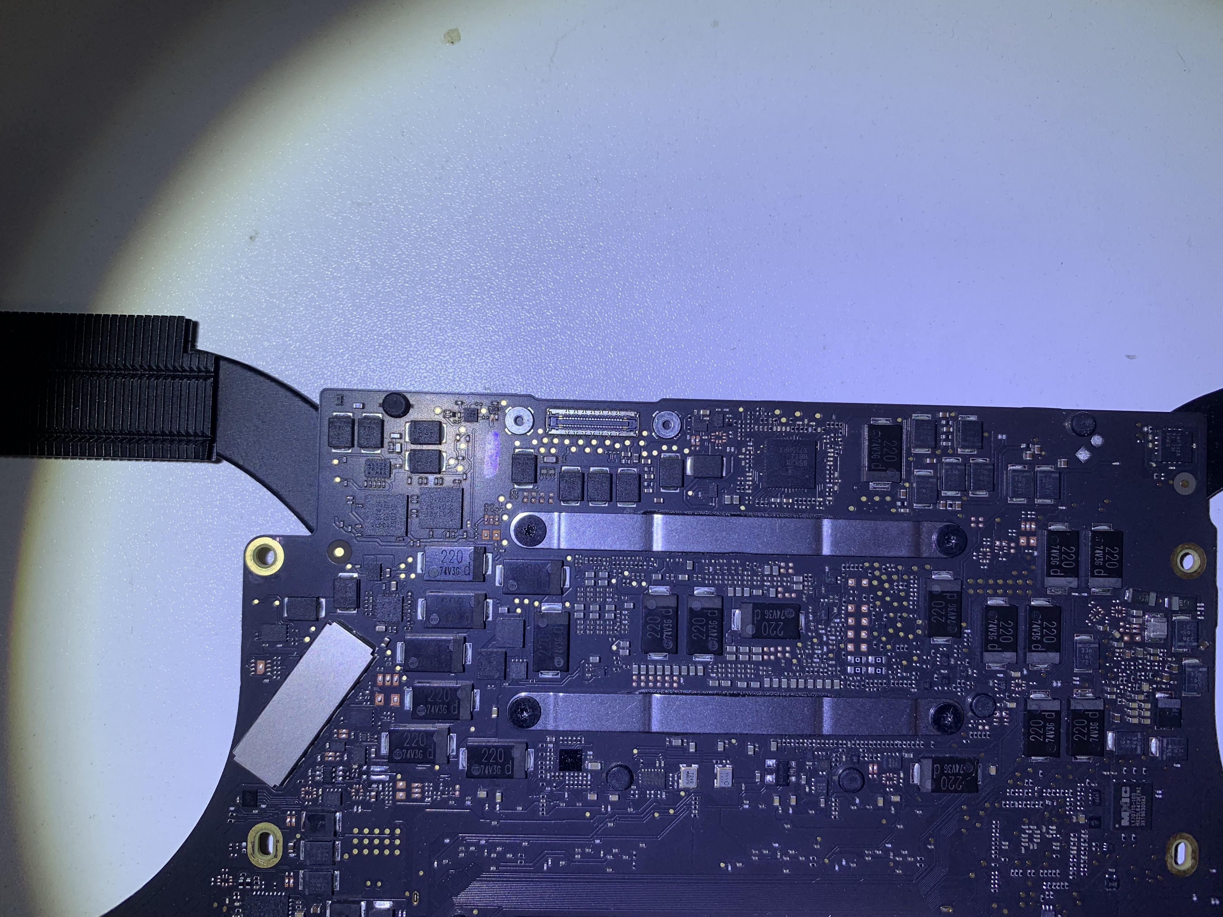

                  I'm attaching here some pictures that I took with the board, and will respond afterwards with more details. (sorry if it might be bad quality, took them with my iPhone and the lighting right now is dark here, will do more in the next days if needed)
                  • rilley
                    • Jul 2024
                    • 30
                    • Romania
                    Thanks for answering about the CPU, this is a relief as this board might have chance to work.
                    About the bidirectional USB C meter, will try to buy one soon.
                    I tried also connecting the board with the keyboard flex, and trackpad flex, did the SMC_ONOFF_L and nothing happened, no fan..
                    What I saw, the trackpad seems to work, when I touch it, it has that "force touch" sound.
                    What I also noticed if I had the battery + battery status cable connected, it started to charge it, as I noticed the power adapter transformer was warm, and after removing the power cable, the trackpad still worked, also verified the motherboard battery + - connector, and I got voltage there.
                    (power button I think is unresponsive because I did a test with the board outside of the casing, with only the power adapter cable to the USB-C and pressed the power button, and measured the SMC_ONOFF_L and didn't noticed any change, it was 3.3v there, regardless of the power button press, and I checked the MESA connector from the board, and the MENY_KEY_L pin is missing, not sure if is related or not)
                    The display connector from the board looks good, but the flex cable that went to the display, on the PP5V_S0_ALSCAM_F is burned, also on the display connector the PP5V_S0_ALSCAM_F is burned, and the only burn that I saw on the motherboard is near the J8500 connector, the L4004 is burned, missing.
                    Also, the USB-C connector from the board JB500 is missing ( left side ), I think the service that I employed a long time ago tried to remove most of the components that were in short. (I think).
                    Will try to measure ALL_SYS_PWRGD​, a little bit harder as it is too small, but will try to measure.

                      I've checked at the ALL_SYS_PWRGD test pad, while board connected to the power adapter only (no other cables connected to it), I have 0v on that.

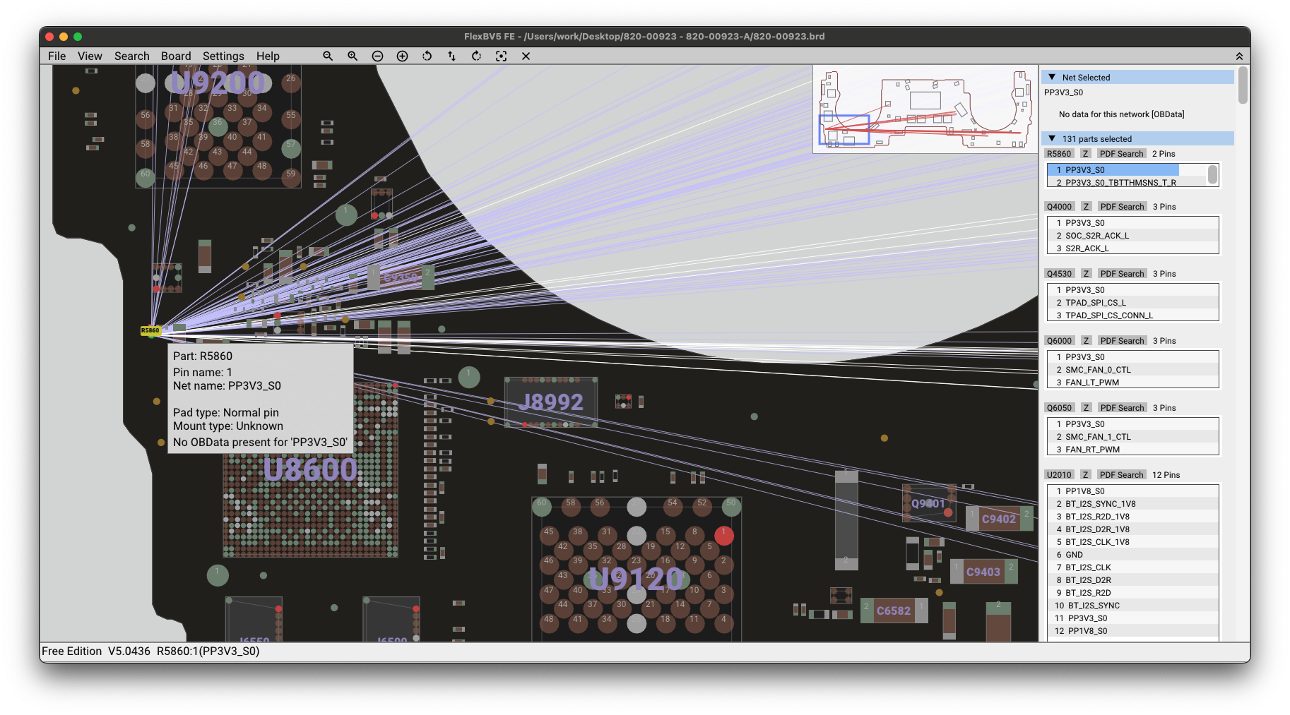

                        Measured the PP3V3_S0 at R5860, and I have 3.35v

                                  I've re-checked the ALL_SYS_PWRGD, black probe to GND, and measure unit to DC red to ALL_SYS_PWRGD​, still 0V, when I touched the red probe, I've noticed small changes on the measure unit, but still 0V. ( measure unit set to 20v threshold )

                                    The PPBUS_G3H at C6484 it is 13V stable.
