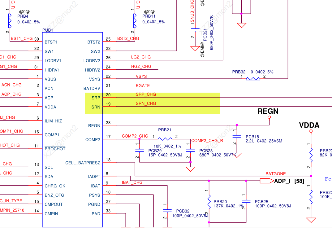

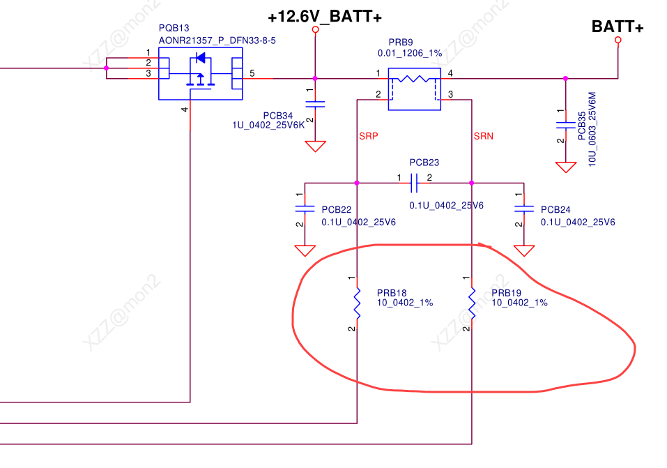

              Remove all power. Meter in resistance mode. Measure the full path resistance of the battery charge circuit. Measure directly on the charger IC @ PUB1, pin # 19 & # 20.
              This full path resistance should be ~20 ohms. Confirm it.

                Forgive me, but I am a bit confused on the instructions. I have found charger IC @ PUB1. Are you wanting me to measure the resistance between pin #19 and PRB19 and then pin #20 with PRB18?

                  Correct. Sometimes / often, the resistance between these 2 pins is not matching the schematic values. Then the charger IC believes there is too much of a load in the charging process so the charging is halted.

                    I'm getting 10.6 ohms on both.

                      I may have measured wrong because I I was misunderstanding what you wanted me to measure. Resistance mode, one probe on pin 19, the other probe on pin 20, I am measuring 21 ohms. One probe on pin 19 and other probe on PRB19 is 10 ohms and same with the other. Hope that clarifies. Sorry for the confusion

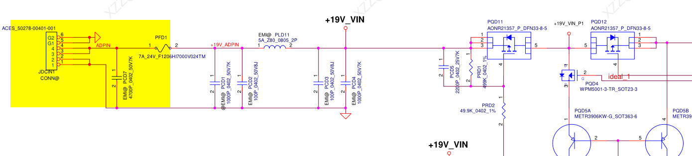

                        Does this model offer a traditional barrel / coax power connector @ JDCIN1? Have you attempted to power the board using this method? Does it allow for charging?
                        The battery charger path resistance is within specification and is fine.

                          No, this model does not have a coax/barrel charger. It uses USB Type C only.
                          EDIT: My mistake. There is a coax/barrel connector on the board it just didn't come with one installed and the hole in the side of the bottom panel isn't there to allow for a charger of this type to be connected. I would have to connect a DC-Jack and then drill the hole in the bottom panel if it worked....

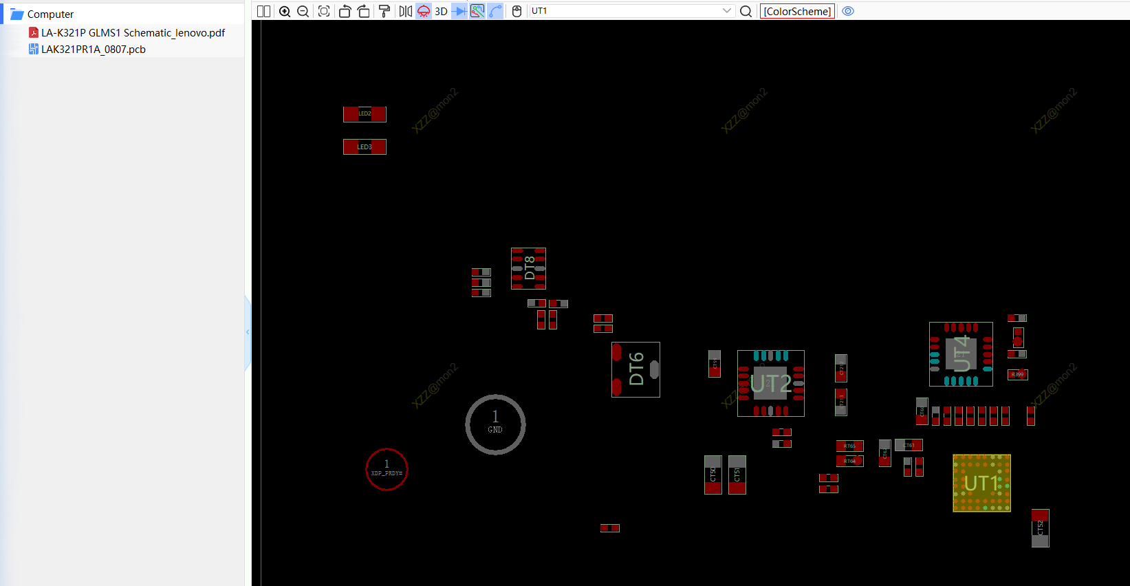

                            Wow. I just connected power through a USB-C meter to take some measurements and I saw a puff of smoke. Looked and see DT8 is now charred. Part CESD2510UC3V3U. Seems to be ESD protection. Coincidentally, this sounds very similar to another post I was following where you helped someone else with a similar problem, mon2. That post can be found here.
