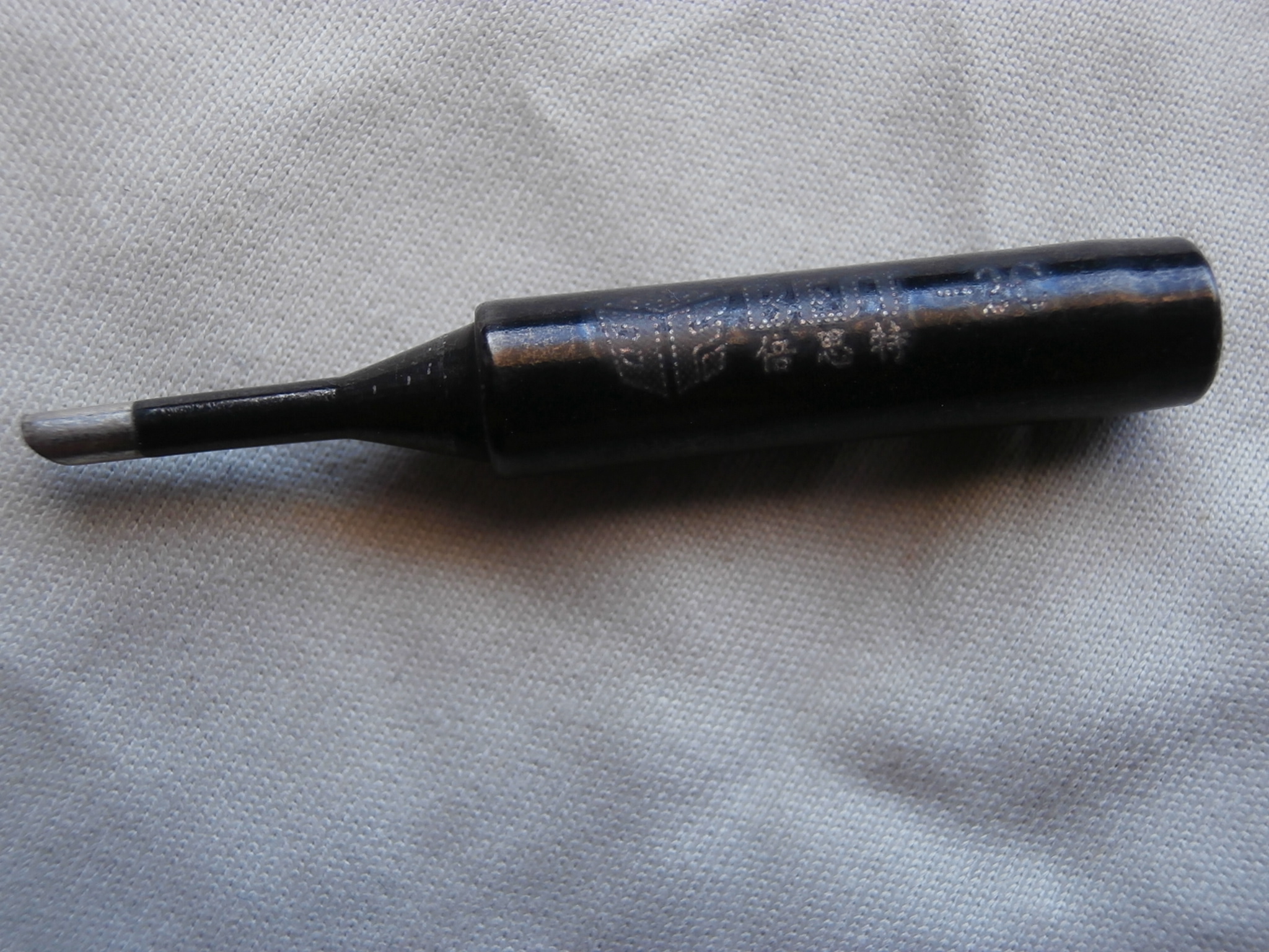

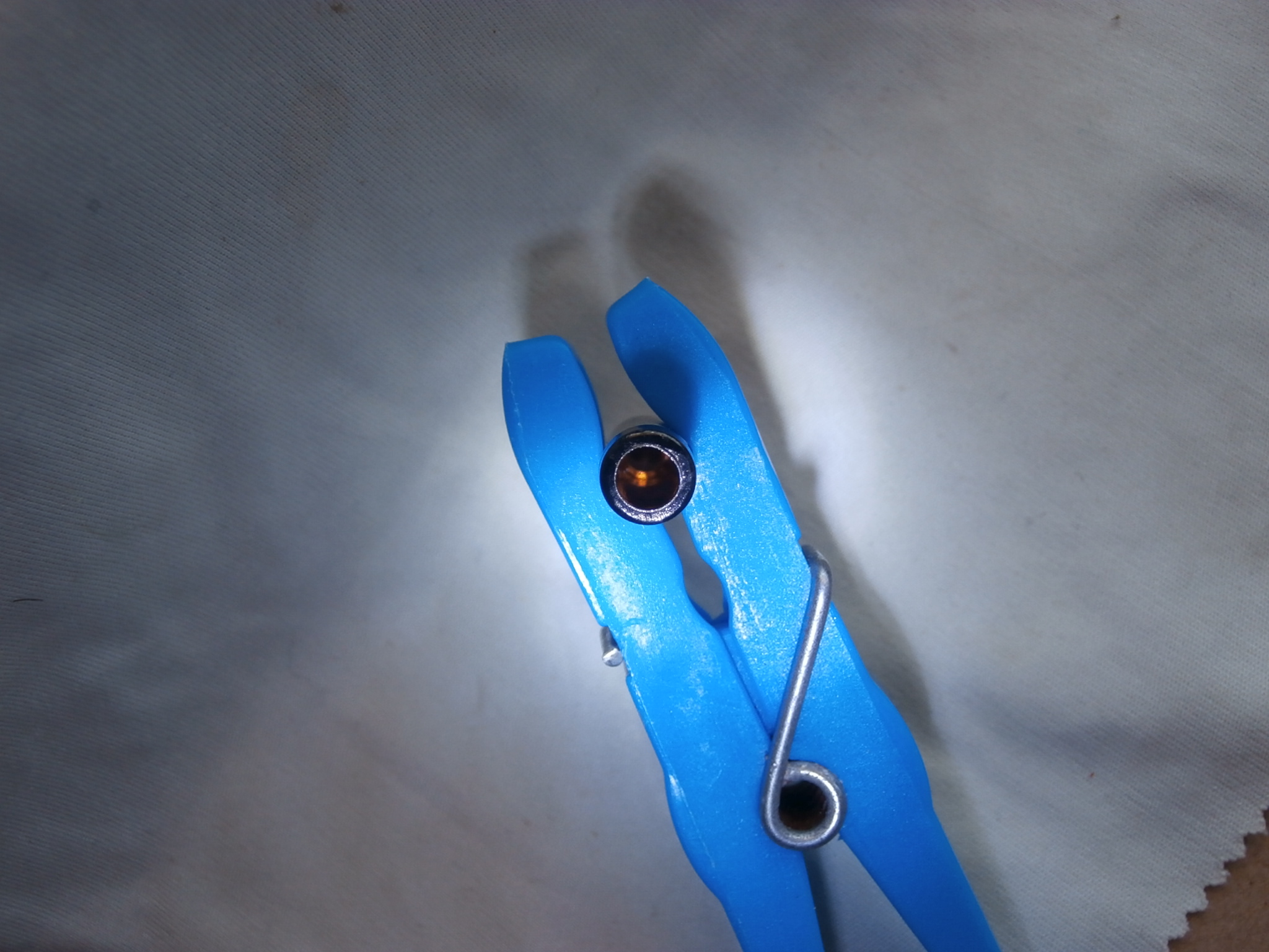

              For 936 clone type stations I recommend, for all-round work, the 900-M series: Shape D or C , 2~2.4 sizes
              I would prefer the 9000M-T-2.4D, but you can't always get what you want, so I'm using this BEST 900M-T-2C from ebay and it's a good tip for the price, you can see it in the photos
              When buying look for a brand, see the description tip weight, a junk tip weights less.
