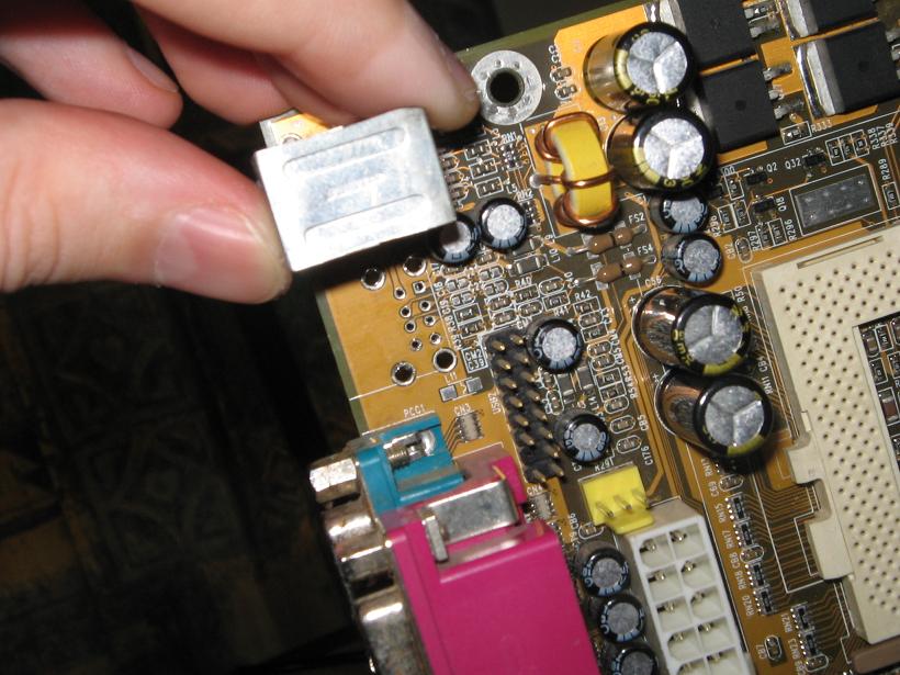

    I just went to plug in a USB cable to the soltek board I successfully recapped, to find that the plug didn't stay in.
    Now I notice that the middle plastic bit is missing and the pins are bent.
    I can easily scavenge a new port off a scrap motherboard, but the question is how to desolder a new one without damaging it, and how to remove the broken one without ruining the board?
    Obviously there's more pins than a capacitor, not going to get away with the same removal method...

        Well, I gave it a go anyway..... here's the story:
        Having several completely trashed boards was helpful, first candidate was a socket 7 something which I had already removed a lot of spare things from and decided to test an idea I had
        Took the solder wick to the data pins, they came undone easily, but there was still the shield to contend with... I figured I would do that one like a capacitor, being enough room between each side I heated up 2 of the legs from one side, and pulled to tilt it half out (note: this is where 2 soldering irons and another person come in handy).
        That side came free pretty easily, but when I did the same thing to the other side, I ran into problems. One of the data pins must have still had a bit of solder in the via when I pulled, and it got rather bent before letting go. Upon trying to straighten it, it broke off. Still, I knew the idea worked.
        So I got myself another board (CPU socket was broken) and proceeded to do the same method, this time making sure all pins were clear first! It came out with minimal hassle. (note: having some sort of heat insulation between your finger and the metal shield is a good idea here...)
        So now I had a new USB socket to put in the motherboard. Question was, could I get the old one out of the good board without causing damage?

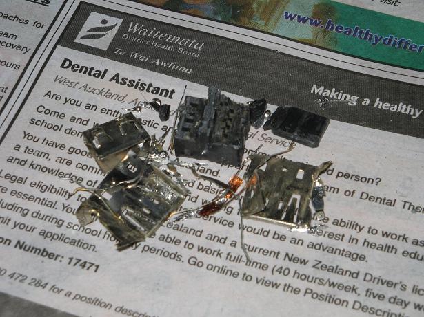

        Well this is where I decided to get creative - instead of trying to keep the socket intact (as it was already broken anyway) I decided to dismantle it. Using pliers I broke the plastic inside part out and was left with a metal shield and the data pins. I then cut the shield in half along the top and pulled each half and each pin out by heating and removing the usual way. Only one iron was used.
        The leftovers of the broken USB socket. It's still broken
        The holes cleaned out ready for the new socket
        Soldering in the new one was as easy as pie, of course. Then to test if it worked.
        Before thinking you've destroyed your board, please plug this in first. it helps a lot:
        End result: 2 new working USB ports on the board
