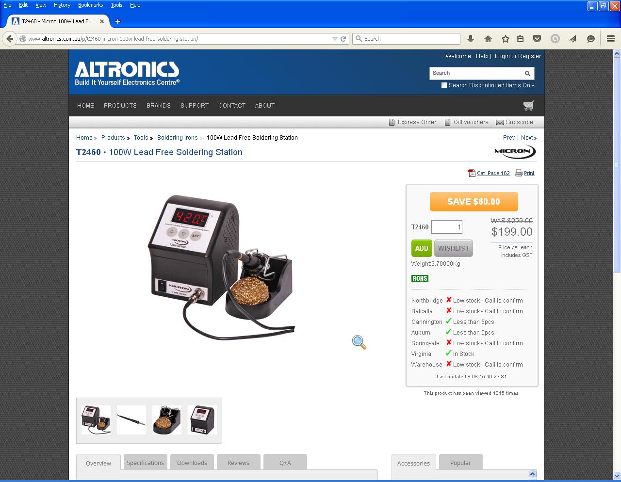

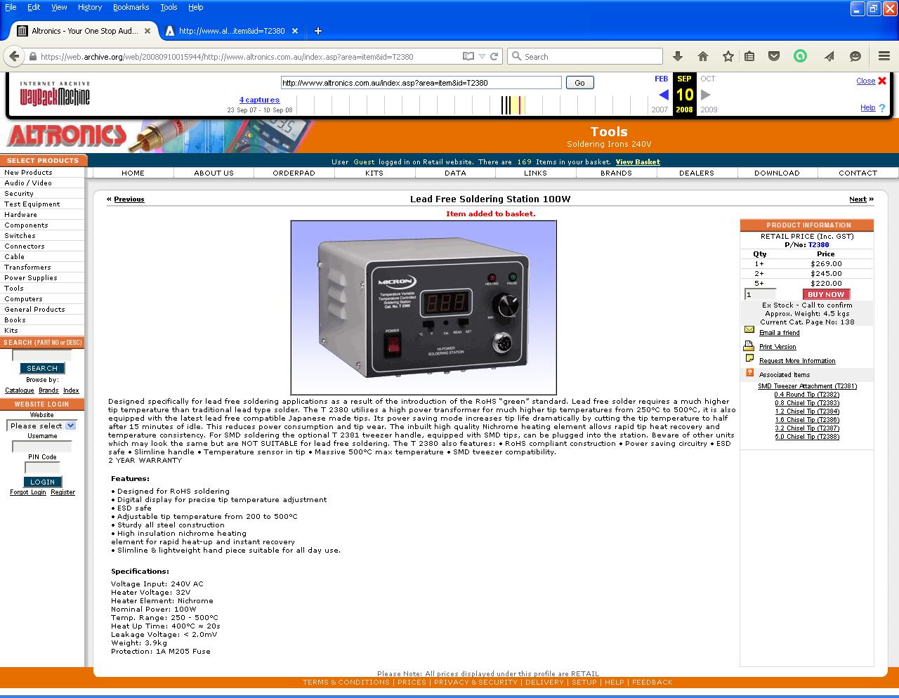

                      Re: Altronics T2380 Soldering station busted
                      Shot myself in the foot
                      After ruining a motherboard trying to remove caps with my old station, I noticed Altronics offering suspected closing-out price on their T2460 - I think a rebadged Xytronic LF-2000:
                      http://www.altronics.com.au/p/t2460-...ering-station/
                      or first pic
                      Bright idea was to try old handpiece on new station, and vice versa
                      It arrived today, and its handpiece is six-pin connector, not seven
                      Handpiece seems to be a Xytronic 307K - at least it's a much lighter & neater unit

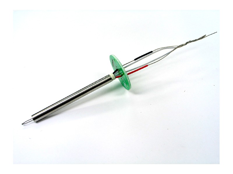

                      So my quest continues for a heater element like second pic, borrowed from:
                      http://ndn.com.pl/akcesoria/3034-grzalka-79-210012.html
                      who won't deliver to Australia
                      FWIW, original station looks like third pic
