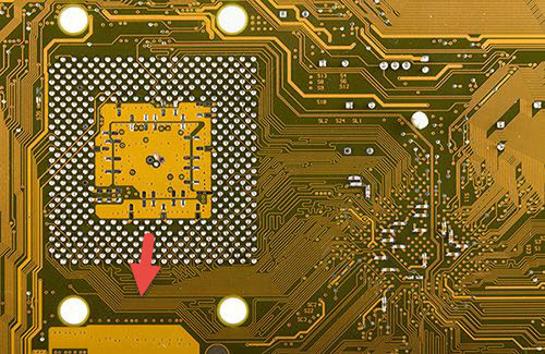

    I was wondering if anyone here has any experience using conductive ink pens as it seems the motherboard I am recapping has some broken traces. The problem is the traces are next to each other and I am trying to avoid bridging the traces together but what's the best method to do it as I've tried:
    1) using 3M Scotch Magic tape outlining the trace but the ink still seems to bleed to the other trace.
    2) just apply to the entire area and let it dry but after it dries, using the tip of a paring knife to draw the lines between the trace, it will basically take all the conductive ink off.
    Is there another way to apply it so it will just be a hairline instead of spreading and creating a short?

              • Almighty1
                • Apr 2014
                • 222
                Re: Conductive Ink Pen - how to apply without bridging when there are multiple traces
                Hard to get a picture in focus so I've borrowed one basically showing something in a similar manner, there is like 6-7 traces which all are broken that I'm trying to fix. I can see how single-strand copper wire can be placed but how will you get the solder to be hair thin so it doesn't touch the other traces. I even heard some people use a 0.5mm pencil to fix traces but it just won't be long lasting as that's how some people defeated the AMD CPU frequency lock.
                  In such cases what I would do is clear off a small section of soldermask further up on each trace so you don't risk bridging it with others adjacent to it. Just alternate the locations on the traces accordingly to avoid any scraped traces right next to each other.

                    • 31196
                    yep,
                    strip & tin the tracks,
                    tin the wire,
                    then they will solder together fine.
                    • rievax_60
                      • May 2012
                      • 897
                      • australia
                      That is what I do also, works well.
                      If the tracks are very fine and I need many attempts at getting the wire soldered in the right place, I use candle wax as flux. It doesn't need to be reapplied often like other flux types do.
                      • Almighty1
                        • Apr 2014
                        • 222
                        Good point so basically I can join any two parts of the trace as long as it's the same trace? Also, where would I get the wire for this? What's a good way to clear off a small section of the soldermask without damaging the trace beneath it?
                              It is important to not scrape soldermask from adjacent tracks if you want to avoid solder bridges. I use a stainless steel rod sharped like a small flat screwdriver point, but slightly rounded.
                              The fine wire from small mains transformers can usually be tinned easily at normal soldering temperatures.
