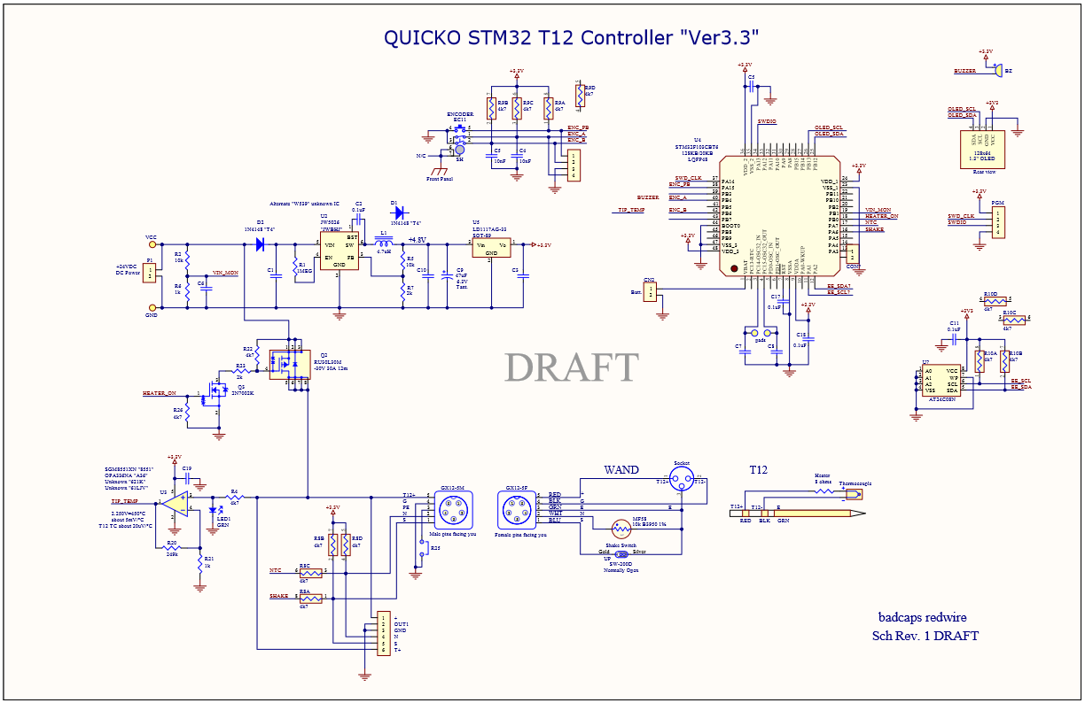

                  What version # is written on your controller board?
                  When I get time, I'll review the schematic and mention what I think needs to be fixed. Like the thermocouple op-amp circuit does not make sense. BOOT0 is just connected to GND.
                  I forgot I was drawing this schematic for Quicko STM32 Ver3.3 controller last year, it has a different power supply than yours but some basics should be similar, including I/O assignments.

                        Using the Post #24 schematic, U7 LMV321 is wired as a comparator but values with R6 5mΩ sense resistor and 130mV at pin3, it trips at >26A which does not make sense.
                        If it was 50mΩ then >2.6A trip seems reasonable? It does look like it only checks if there is heater current above a certain threshold.
                        Quicko put in the extra hardware to monitor this. I kinda like their controllers better.

                            I'm not sure which firmware load to use.
                            If a heater cartridge goes open-circuit, and these T12 clones are notorious for crappy carts/sockets and connections, there are two ways to tell.
                            Heater current will not be there when the mosfet is on, or the thermocouple voltage will peg when the heater mosfet is off. Good firmware can figure it out. But it is a shortcoming for some people to think outside the box.
