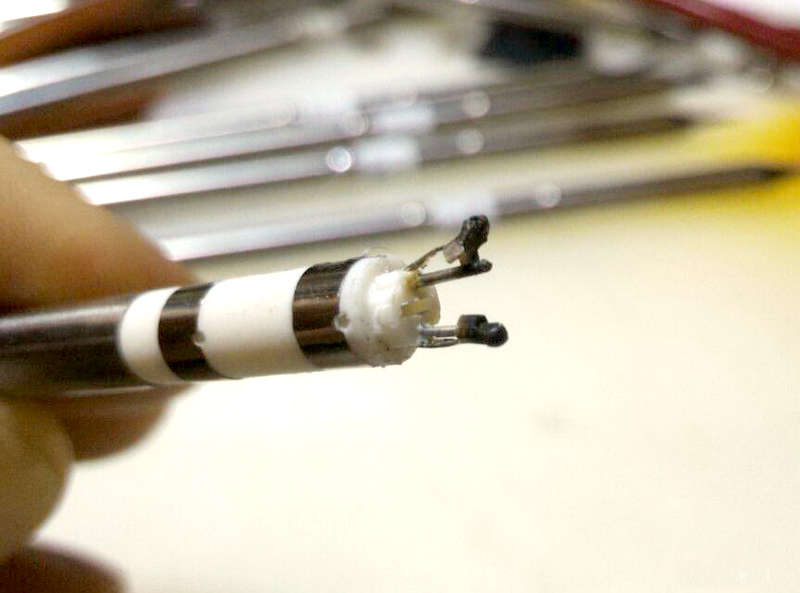

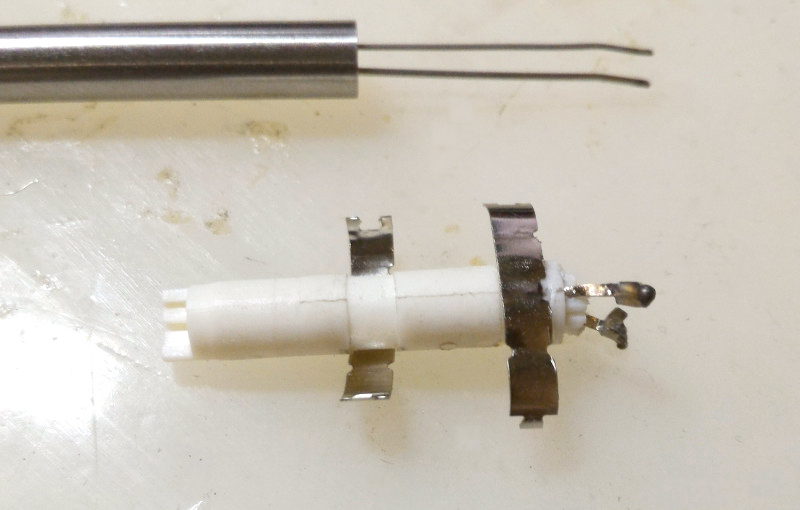

              Just add a 1MEG pullup at the GX12 pin 5/heater/thermocouple input, to power +24V. It ends up being across the mosfet D-S. This stops the spazzing and freaking out, an open cartridge will now give a stable OPEN error message instead of picking up hum and noise. This is also aggravated by how noisy your PSU is. Your battery does float from PE ground so hum and noise pickup at the tip will be greater. Or add more bulk capacitance to the 24V rail, some controller boards are really cheap and have no 100uF cap there.
              The tips have bad connections inside, new ones they sometimes need to be cooked it can sorta work. I think it's just dirty spot welds inside the white caps or in the maybe in the heating element, but using it seems to eventually fix the bad connection.
              Some cartridges I have taken apart (caps) and tried to solder that bad connection to stop the drama.
              There are also lots of other fixes to T12 quirks.

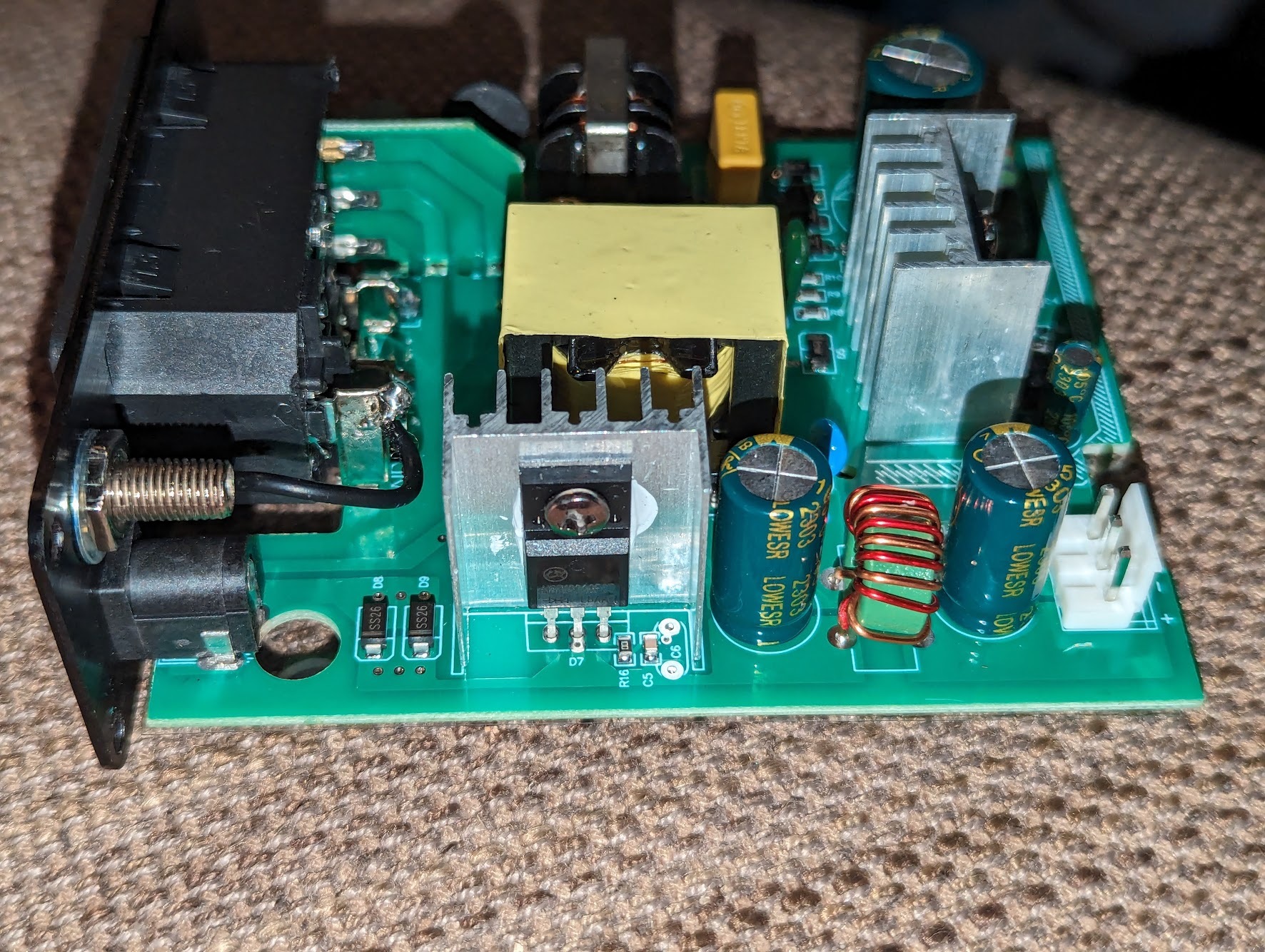

                Thanks, this sounds promising. I'm struggling to figure out which pin that is on my GX12 connector you're referring to - I have T+, T-, GND, NTC, and SLP, is it one of those?
                There's no 100uF cap on the controller board or on the power side, only one 680uF cap - do I just need to put a 100uF 35V electrolytic across +24V and negative?

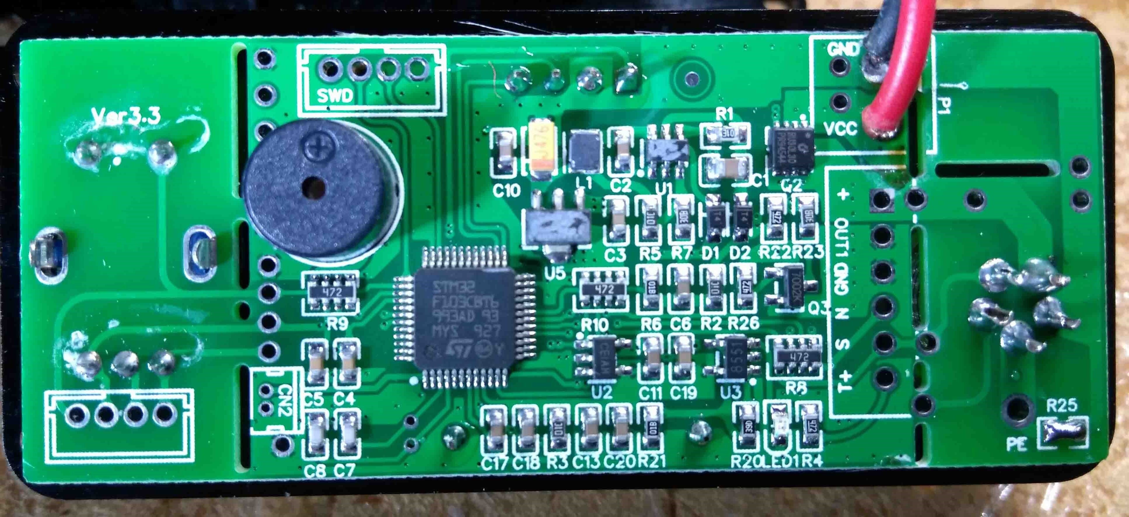

                  I don't know exactly what your controller looks like. Quicko has 4 or 5 wire models. I have a Ver3.3 STM32 pic and sch I worked with a Russian fellow on it.
                  First add 1MEG resistor from GX12 pin 5 (T+) to +24V (VCC). It is so a floating op-amp does not pick up as much noise if the heater cart goes open--circuit.
                  The 24V bulk cap depends on the controller board regulator circuit and how stable power is on the battery. The mains PSU usually has two 1,000uF caps - you have one 680uF?
                  Point is, off the battery you have none of that so I suggest 47-100uF 35V added but not mandatory unless more is known about ctrl board.

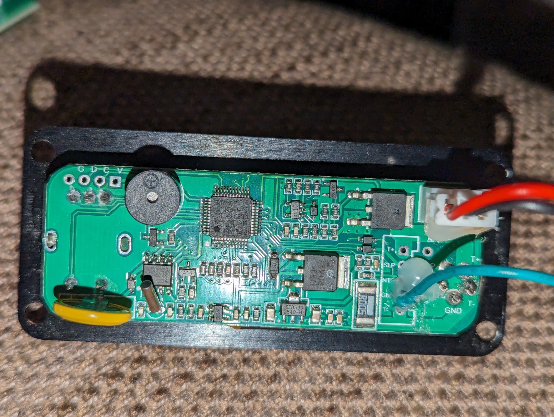

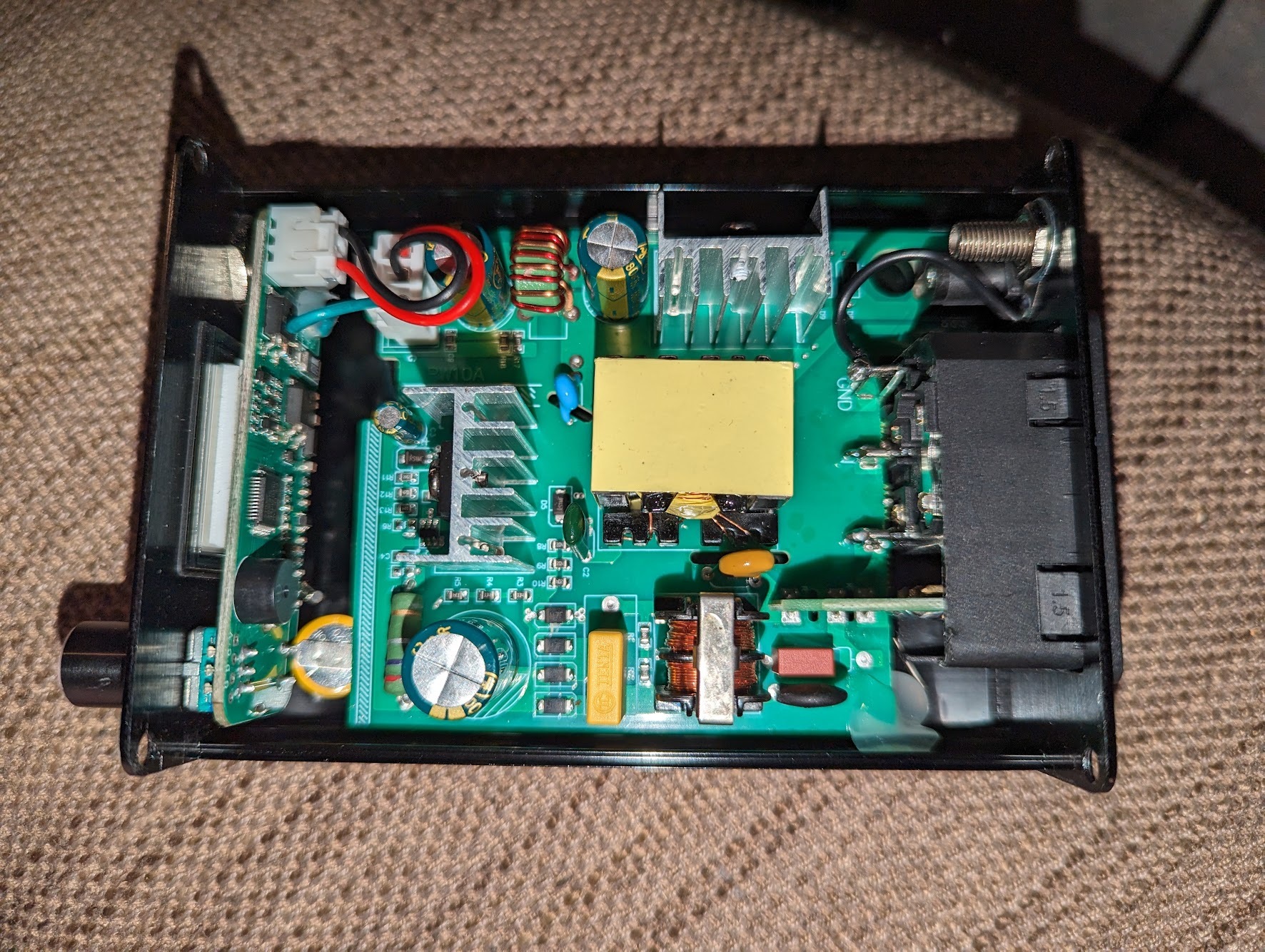

                        You know, I don't see anything to change!
                        That looks like a Quicko STM32 T12 controller, they have better hardware design than KSGER. Not afraid to have a few extra parts and beefier mosfet etc.
                        The thermocouple op-amp is a 3-Peak TP1541A smt marking 541. I see they already have the 106 resistor pull-up I've been talking about.
                        Also, the PSU has the 24V battery input and so the 680uF caps are in-circuit then and no need for extra capacitors. There should be a menu to set the low voltage cutoff to say 18V.
                        That leaves your troubles to the cartridges or maybe the grounding but I can 't see a reason for battery operation to make the unit malfunction so.
