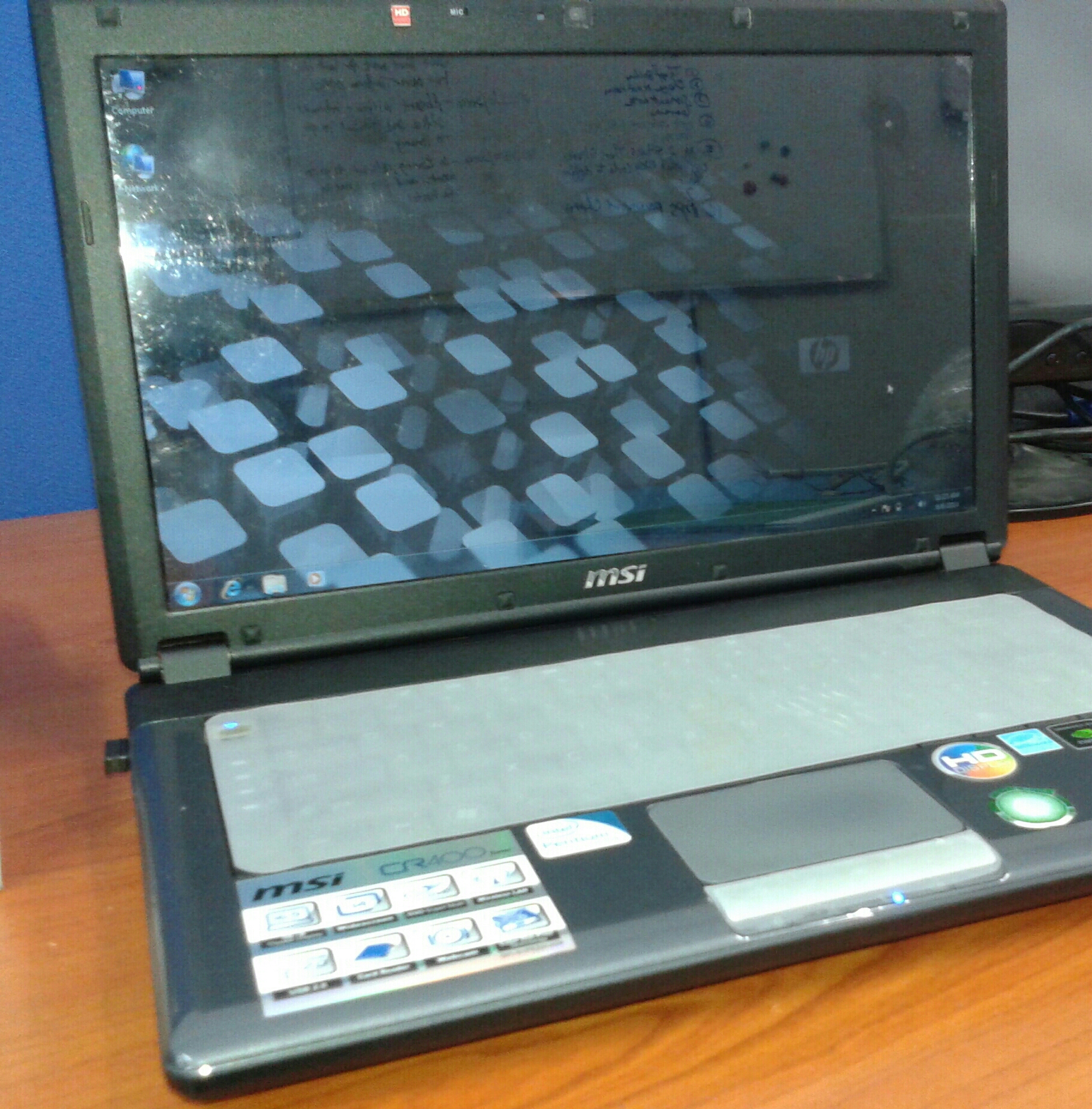

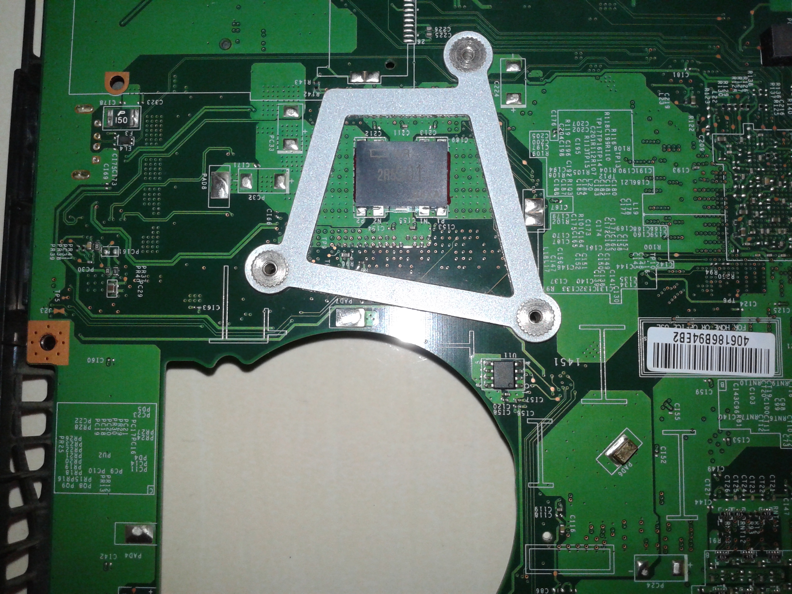

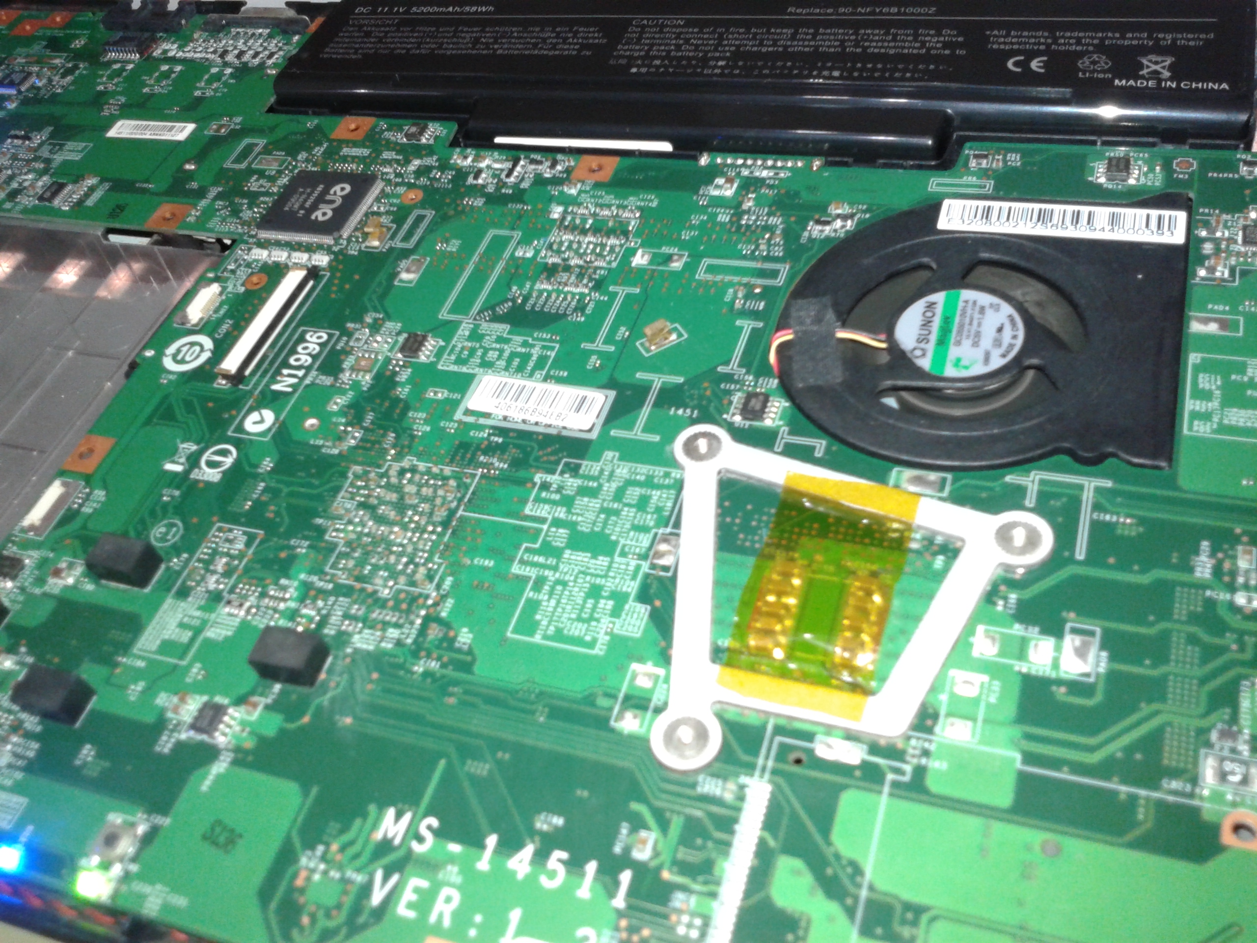

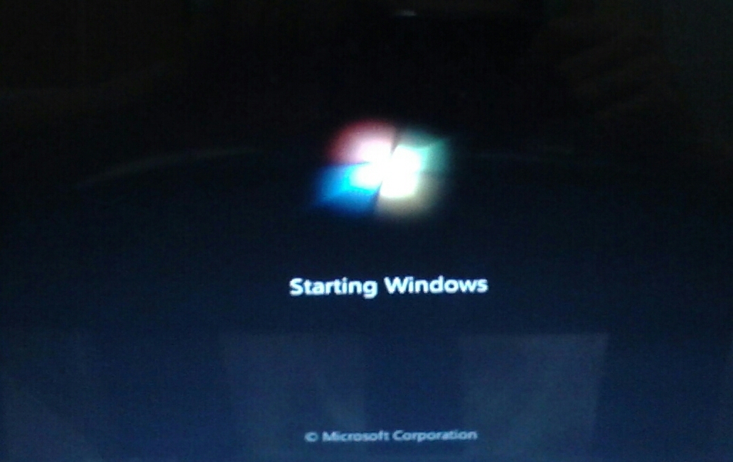

                              Finally after 3 months of researching on the internet for fault cases of laptop motherboard intermittent shutdown or such a problem of MSI CR400 sudden shutdown issue, I had managed to solve it while persistently finding the fault with precious help from this forum. This is my first ever project of fixing a failing capacitors of motherboard like MSI CR400 and successfully doing a recap on the motherboard. The kind of patient you need to follow when a laptop/desktop doesn't work will lead you to getting it fix and bring back the lifespan of a bad or damaged electronic unit like this one. Here I would like to say thanks for your help Badcaps !

                                Originally posted by LENOVO-A880
                                Finally after 3 months of researching on the internet for fault cases of laptop motherboard intermittent shutdown or such a problem of MSI CR-400 sudden shutdown issue, I had managed to solve it while persistently finding the fault with precious help from this forum. This is my first project of fixing a failing capacitors of motherboard like MSI-CR400 and successfully doing a recap on the motherboard. The kind of patient you need to follow when a laptop/desktop doesn't work will lead you to getting it fix and bring back the lifespan of a bad or damaged electronic unit like this one. Here I would like to say thanks for your help Badcaps !
                                what caps did you change? 330uF or small ones? 5-10uf?
                                • LENOVO-A880
                                  Not A Bad BIOS
                                  • Feb 2014
                                  • 79
                                  • MALAYSIA
                                  Re: What SMD Rework tools do one needs, preheat, etc?
                                  This is what I have changed (refer to the first pic). The specification of the capacitor for MSI CR400 motherboard is similar to the NEC Proadlizer® Tokin PF/A series which has rating as follows:
                                  1. Tokin Rated Voltage(V) = 2.5
                                  2. Tokin Capacitance(μ F) = 900
                                  3. Dissipation Factor (%) = 10
                                  4. DC leakage Current(μ A) = 250
                                  5. ESR(m Ω) at 100kHz = 1.5
                                  6. Part No.= PFAF250E907MCBTE
                                  This failing capacitor is located beneath the processor (depends on which kind or speed you have) and managed to trigger the signal for shutting down the motherboard circuit if the ESR reading is abnormal (too high). Again after so many hours the MSI CR400 doesn't seem to have anymore shutdown related problem. For further details of the ceramic capacitors that I managed to get from RS-Components online refer to the link here:https://www.badcaps.net/forum/showth...963#post448963
