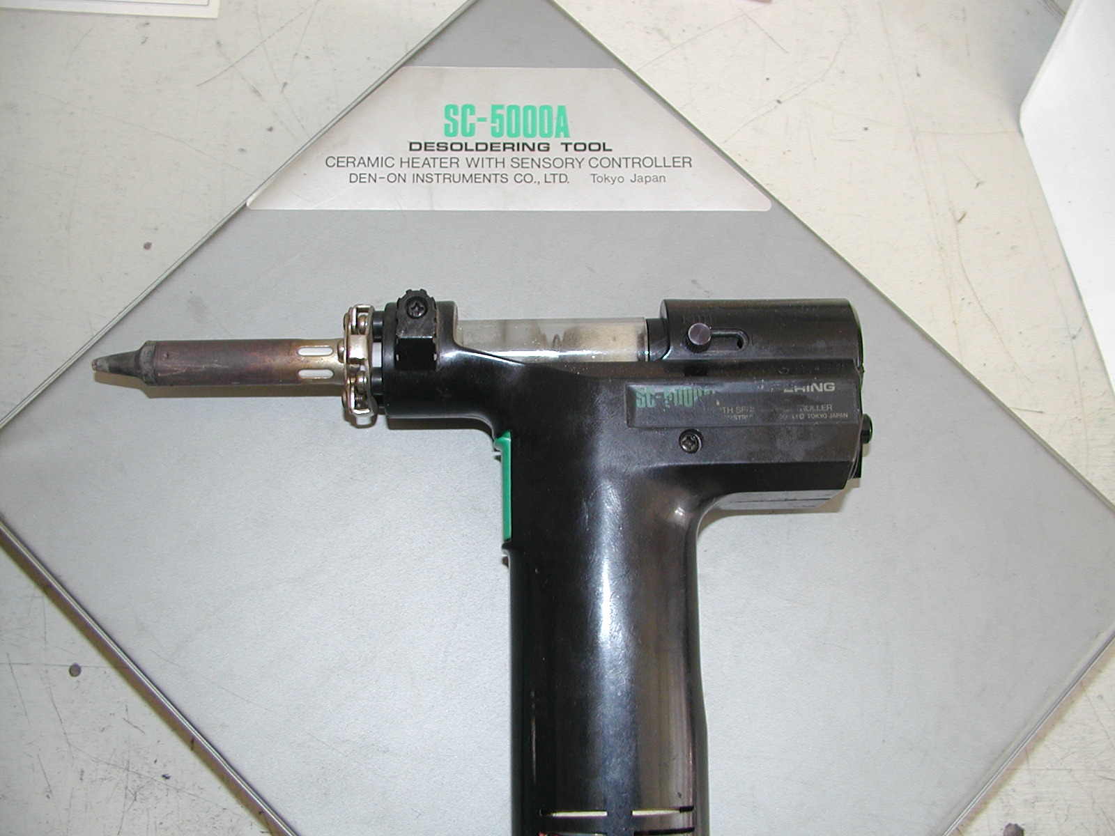

      I have the DEN-ON brother model of the 7000,
      it is an very old design capable to handle single layer PCB and throw hole desoldering.
      The pump is noisee and not powerful enough as needed to handle a five layers PCB just with hot air.
      You need to find an more modern tool than that.
      Yes it is made in Japan and with a cost around 1000$ USD as new, and so what?
      It does not come even close to a modern rework Air station.

        Is it the SC5000?
        The newer one I linked to doesn't use hot air to do the vacuum desoldering. It uses a ceramic heater core iron /w a hot, hollow tip connected to a "vacuum" pump. Which, when activated, sucks the molten solder into the chamber and yadda yadda.
        You can however reverse the vacuum pump to blow out, instead of suck in.

                  I'm sorry, but I don't see anywhere in my posts in which is spoke of my own personal experience with any of the products. Only what I'd read others say in regards to them.
                  That's definitely the previous generation model, of which I can find no information.

                          All that I am trying to do, is to protect you from getting something that it will not work.
                          This is a hand tool, the pump is tiny, no matter the model as 5000 or 7000, the pump in those dedicated hot air stations is double or triple in size.
                          Yes I have use recently a Hot air station which it was doing miracles regarding performance, the lesson that I got from it is to select my own among the ones with analog temperature controls.

                            I have an SC5000 also. It works quite well on multilayer boards if I preheat the board with hot air first.
                            What I do not like though is that since the pump is in the handle it vibrates through to the work and can cause damage to the board more easily.

                              Well @y_not made me to have a second look on my SC5000 prior giving my reply above.
                              I did take out for a first time in my life this 1.5mm copper noose and the about 10cm long tube came out too.
                              My finding was that the on-board wire ( cleaner for the noose) it very thin and incapable to clean sufficiently the tube where the air moves.
                              I did clean it up by entering an 1.5mm drill bit.
                              After restoring the air flow I did run some tests, but I got disappointed again.
                              It can heat up one solder blob and make it soft regarding melting, but it has no power to move the solder away from the PCB.
                              In the best scenario you are using the metal noose to heat up the solder, and you may use the air just to push and clean the PCB hole and that's it.
                              I have one Nvidia VGA which has a cap that needs replacement, the SC5000 even by been clean as new it was incapable to do the magic.
                              My feelings about it due the fact that I own it for two decades, is that due the new multi-layer PCB,s this tools has lost it practical value.
                              Preheat with another hot air tool and then with the SC5000 it is like using two cars at once with just a single driver = extra trouble.

                                It sounds like maybe you did not really get a full melt. I followed the procedure I saw here: http://youtu.be/e8KRPFOD1RE - moving the tip around to check that the lead is loose.
                                On multilayer boards, the trick is getting the feel for when the lead comes totally 'free' in the hole and not just half-way. There is a difference but it's small. I am still getting the hang of it. Thick\wide leads in small holes usually feel different.
                                I don't know if it's the best solution, but it does seem to work. Just have to be careful not to overheat the board, I have lifted some pads being too aggressive with the hot air before. You have to preheat for longer on the big copper planes.
