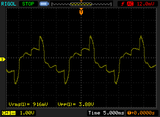

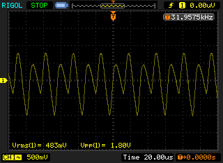

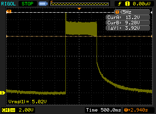

                Re: Oscilloscope suggestion?
                I stand by Rigol DS1052E/DS1102E. The USB port lets you generate output pictures like this, and it's a dedicated instrument, so you can keep it away from your computer.
                Third one shows the AC line current drawn by a power supply with a faulty PFC circuit. I used a Taewhatrans TS-10L current clamp. I have about 120 of the things at home. If anyone needs one, let me know.
