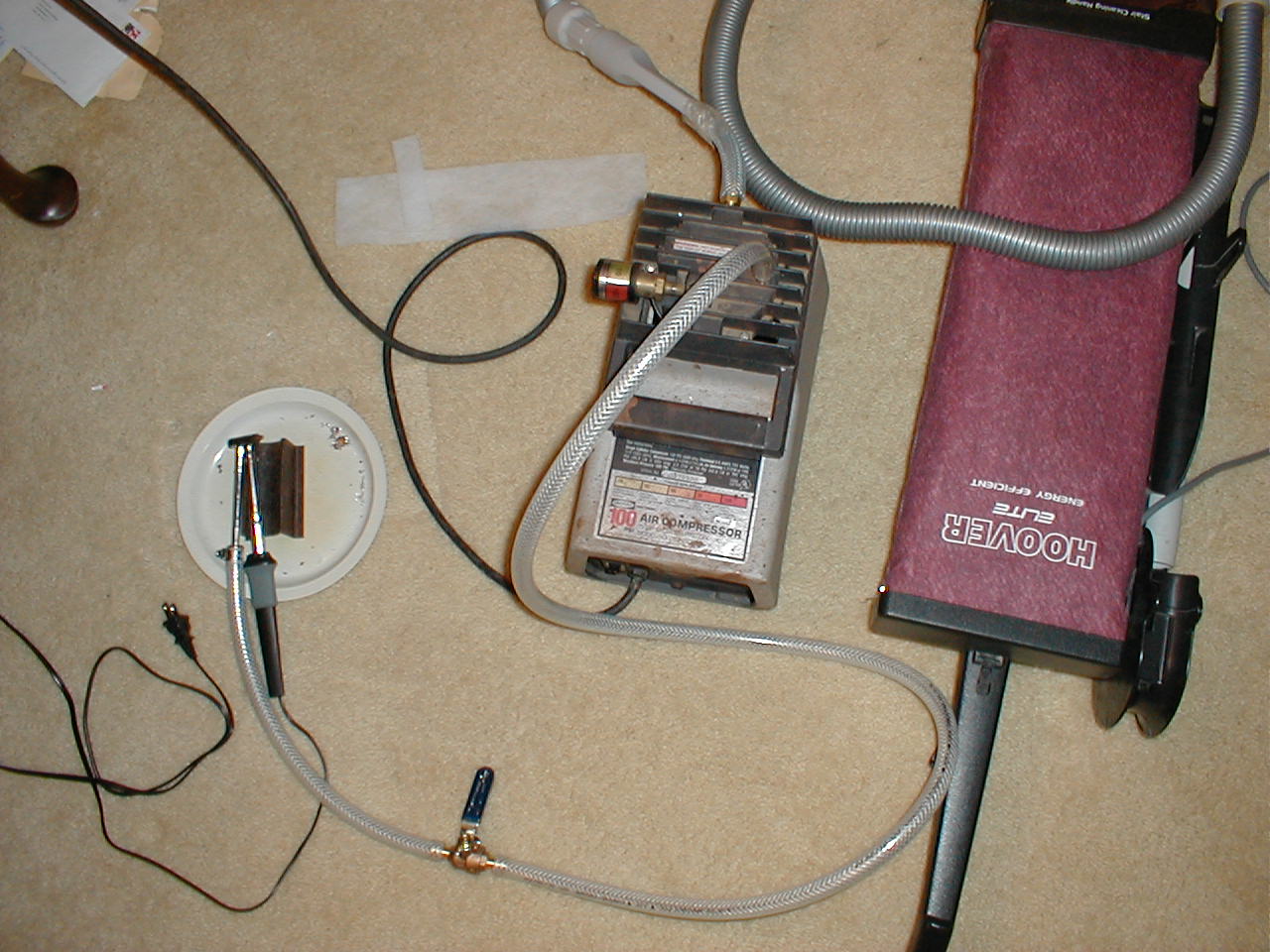

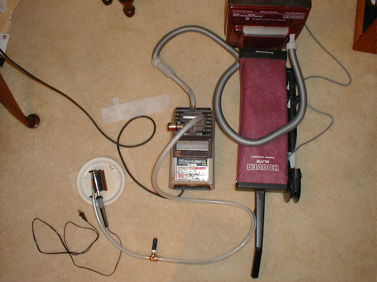

                                    moby solder sucker
                                    Originally posted by Kako
                                    Any other recommendations for removing that stubborn piece of solder?
                                    Don't call this a "recommendation," but, for your amusement, and with apologies to Tim "The Toolman" Taylor, here are a couple of photos of my solution:
                                    http://www.burtonsys.com/BP6_desoldering1.jpg
                                    http://www.burtonsys.com/BP6_desoldering2.jpg
                                    Yes, they are hooked "in series," with the bags removed for extra power. (Removing the beater-brush or belt might also help a bit.) They made a most impressive roar, lemme tell you! Note that the power cords snake off in different directions, because I plugged them into different circuits, so that they wouldn't trip a breaker.

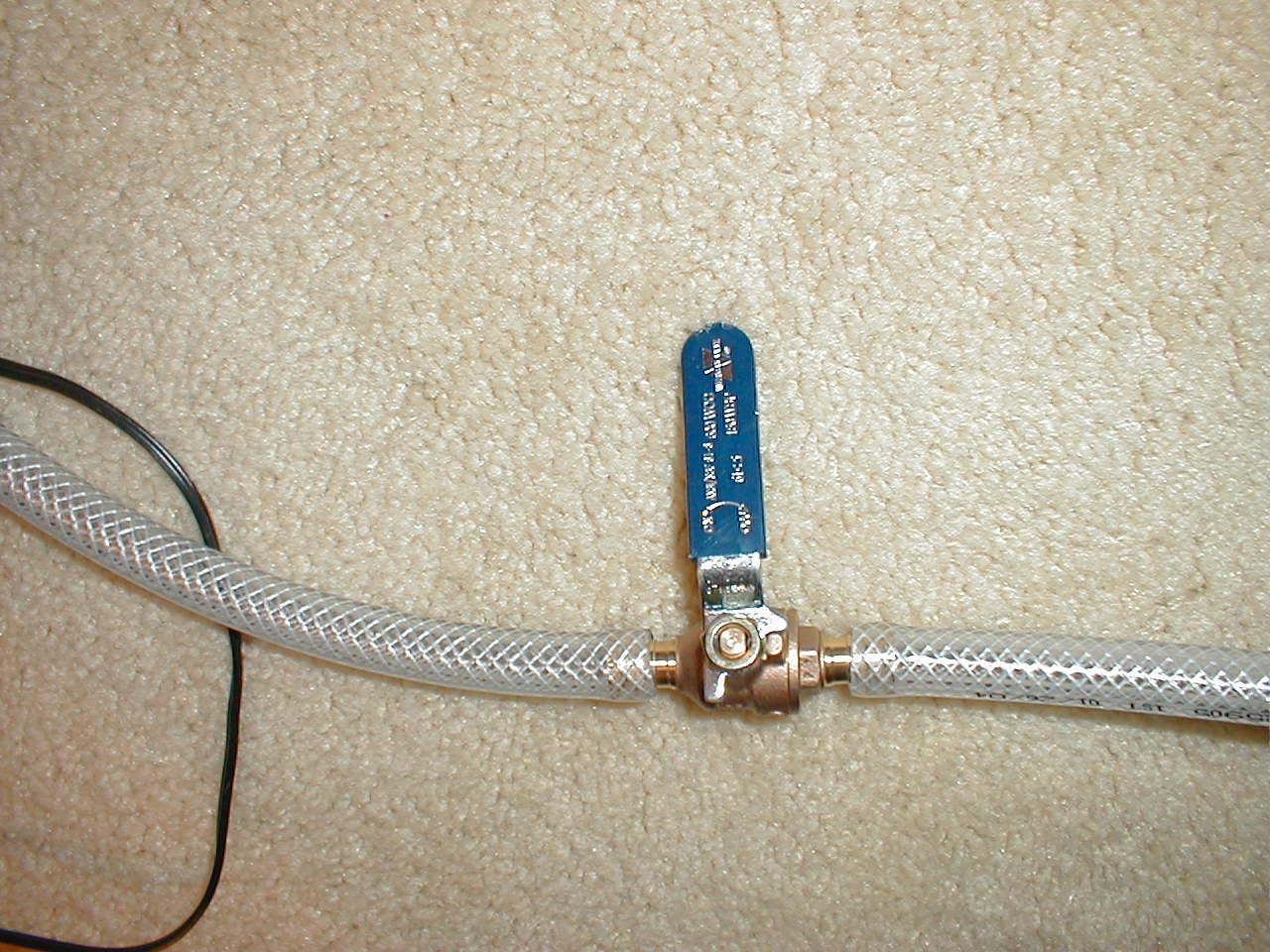

                                    I tried to improve the design with a ball valve in place of the clamped hose...
                                    http://www.burtonsys.com/soldersucker5.jpg
                                    ...but no joy: it leaked the slightest smidgen, which made it impossible to fill the desoldering tip with molten solder. I need an SPDT "Y-valve" rather than a simple SPST on/off valve, so that I can switch the tip back and forth between atmosphere and vacuum, but I can't seem to find such a valve. :-( Does anyone know where I could get one?

                                    Really, I think TopCat's dental pick or sewing needle is a better solution for those stubborn little holes.
