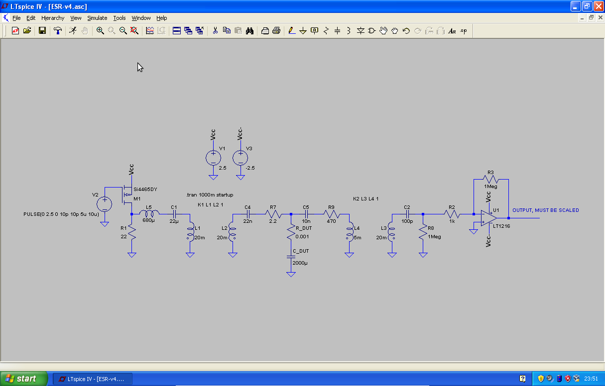

                  Here's my stab at an ESR meter. It passes a constant current sine wave thru the cap (converts square wave to sine), picks up the voltage and outputs an AC (100kHz) voltage with an amplitude approximately equal to ESR. A scale factor control would allow for compensation for true-RMS or average-reading multimeters. May as well use the meter's conversion circuitry...
                  In theory, as it is all ac coupled, it can handle a fully charged capacitor with no problems. Maximum voltage would be 630V or 1000V depending on cap limits.
                  TODOs - think about AC-to-DC conversion, think about split supplies (try and avoid them.) Ideal meter would run off either 2pc or 3pc of 1.5V AA.
                    #49
                    Re: Analog ESR meter design
                    The circuit in post 45, the output is rectified to feed analog meter, you may be able to just use cheap DMM that can read low DC mV range.

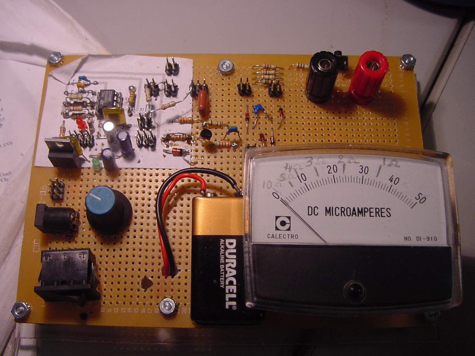

                      This my experiment with ESR meter using some scrapped parts I have in my parts bin, LM555 and 2N3904. Works pretty well compared to my SECORE LC75 for the reading range I want.
                        Cool.
                        Mind posting a schematic or link where you might have gotten the schematic? I need to build me one as well.

                          #52
                          Good job!

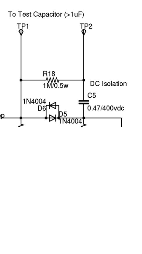

                            Thanks, here is the Diagram & BOM. I am going to make smaller board to fit into old RadiShack Analog meter, since proof of ciruit is verified and it works.
                              By the way, for more bias stability of Q1, you can add 100 Ohms between Emitter and Ground and bypass it with 0.47uF cap, and if you want adjustable gain, then put that 0.47uF cap in series with 500 Ohm trimpot for gain adjustment.

                                      Just to make sure: this meter isn't capable of testing caps in circuit, or?
                                      Maybe in next revision you could add diodes + bleed resistor to protect the circuit if a charged cap is connected?

                                          agent24 is correct, if you have a bunch of caps in parallel, the bad one will not show up as having the high ESR. I always test component out off the circuits.
                                          @sebr: I did add the 1N4007 Diodes to the test terminal, you can add it if you worry about accidentally attach a charged caps to the tester, and if you want more complex, you can add the cap and a bleeder resistor also.
