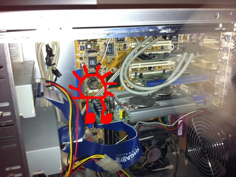

    Can anyone identify this board please and any components in there. I thinks it ASUS and maybe Socket 478?
    I now own it and its on its way...in a Lian Li case to die for.....

      Must be Asus...

        Looks like an asus P4C or P4P series. I'm not an asus fan at all.....seen way too many of them with nothing detectably wrong with them, but they just don't work....hope yours is actually good.

              If you look around the board you'll find a model number.
              That is a nice case. - Lots of air flow.

                  That's an Asus board.

                    Check the little bitty caps.

                        100% sure it is ASUS, the word ASUS is right next to the cmos battery in the pic. :P
                        99.9% sure that is a P4PE.

                              That case will take a full ATX board. The board thats in it is full ATX. It won't take an EATX, but thats nothing you have to worry about.

                                  Well it arrived and those that said it was ASUS P4PE-GE have a cigar
                                  After blowing all the dust off everything and testing bits it fired right up and runs without a hitch
                                  The three RAM slots are strange in that you can only run double sided RAM in slot one you want to use all slots 2 & 3 have to be SS or it wont boot
                                  Its got its original BIOS 2002 I notice there is a 2010 would this address this limit?
                                  Nice looking board in its day no doubt, we will play with it.
                                  All the cards and drives are working fine as is the PSU

                                    No
                                    The 845GE chipset only supports 4 banks total.
                                    Read page 11.
