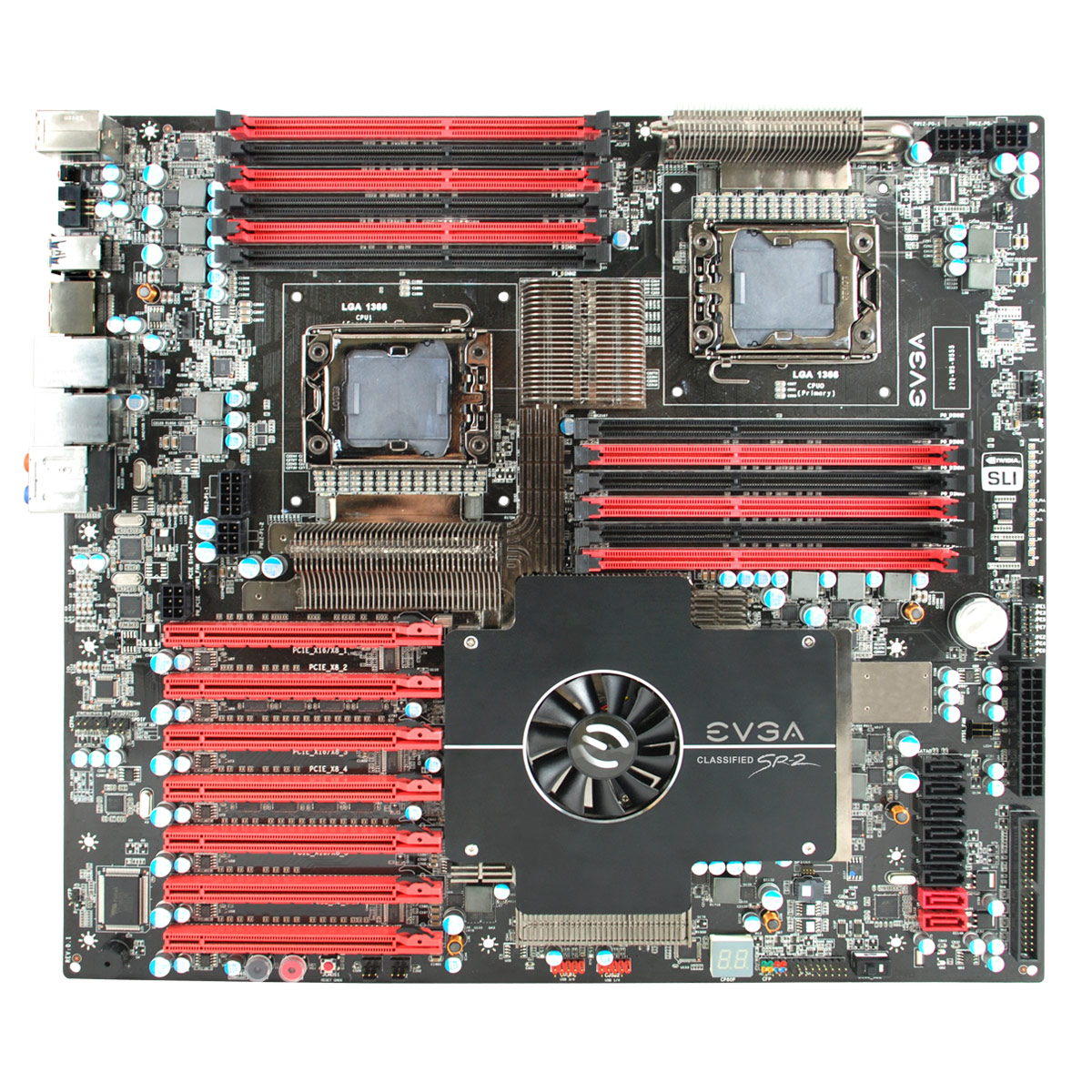

                      Re: ICE ICE baby (low temperature topic)
                      Everybody says that when they see it - got used to hear this already. Iwill MPX2, as mentioned, is going to be placed in my second one .
                      But don't worry, I do have contemporary desires, such as this, and exactly in the same case:
                      I just love big things
