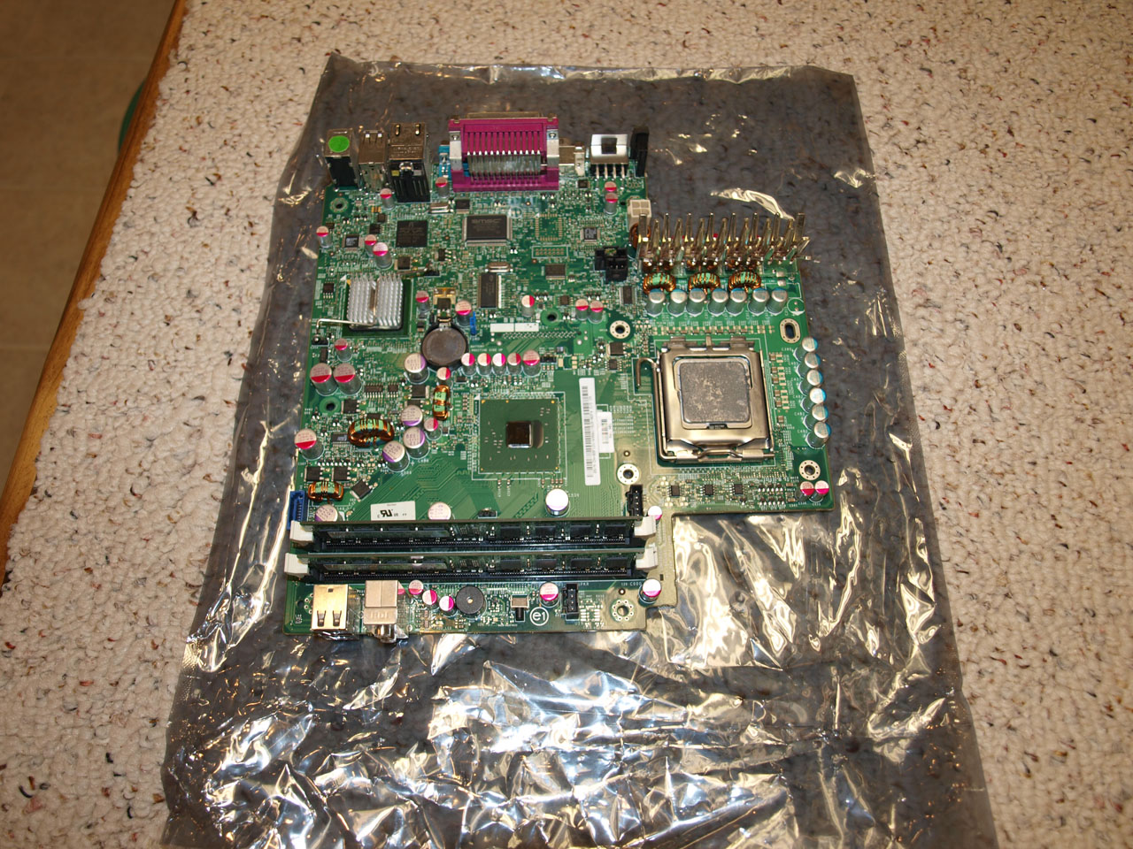

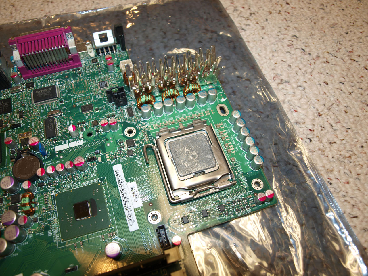

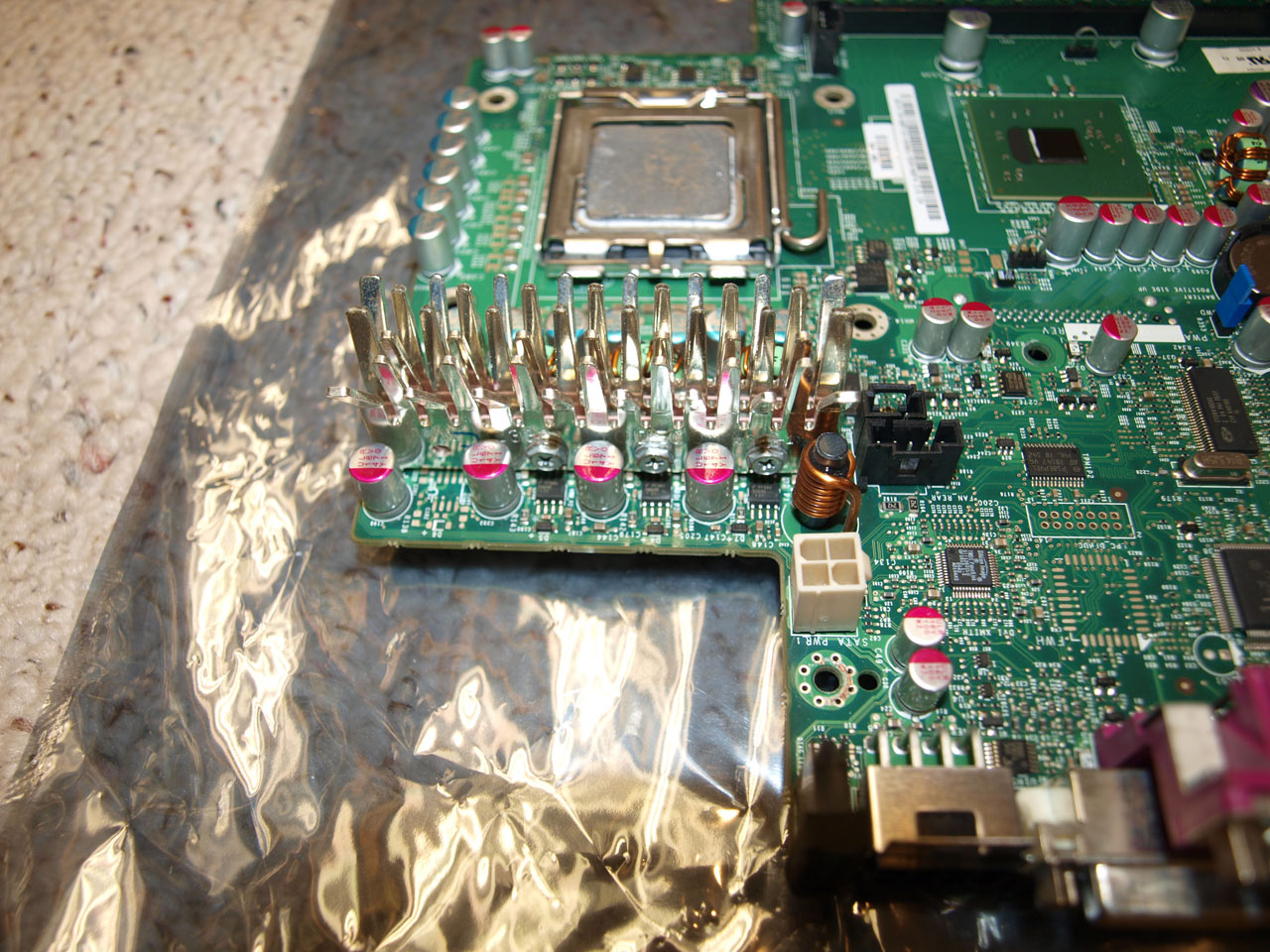

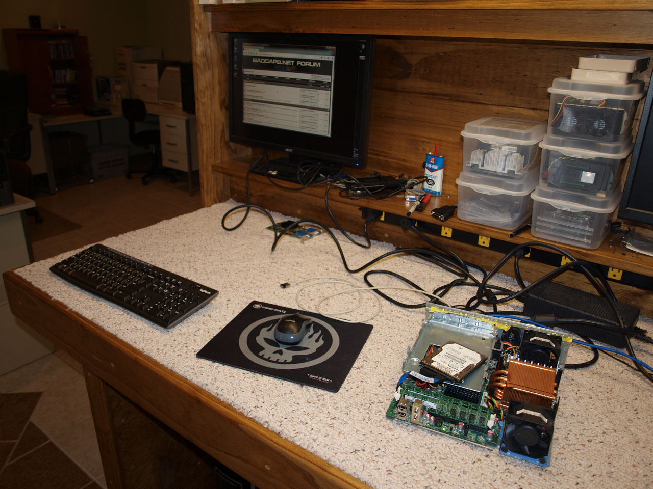

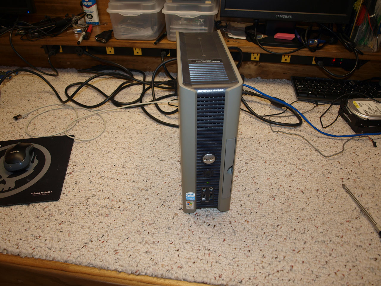

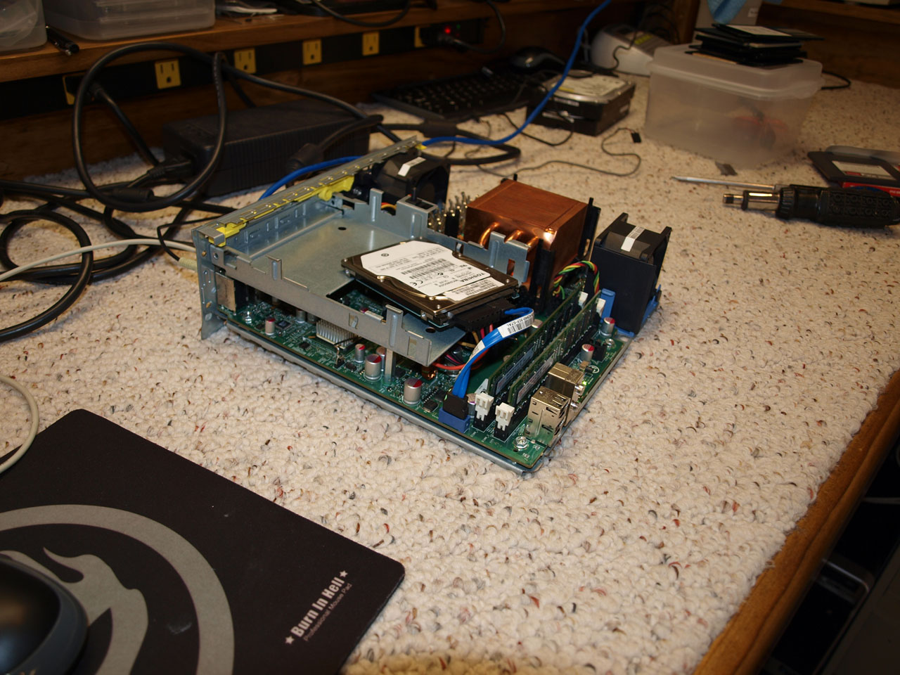

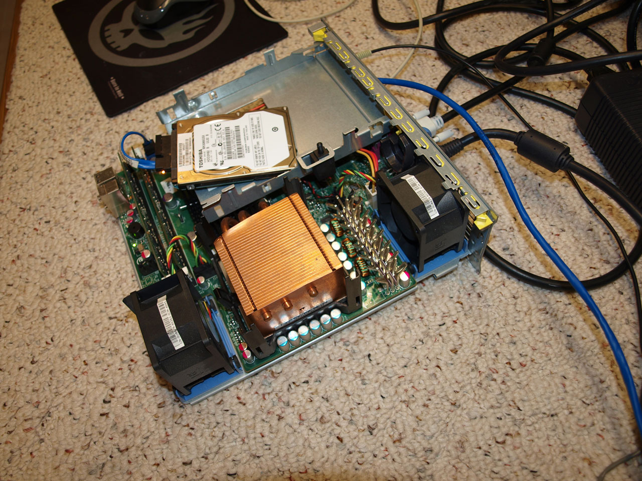

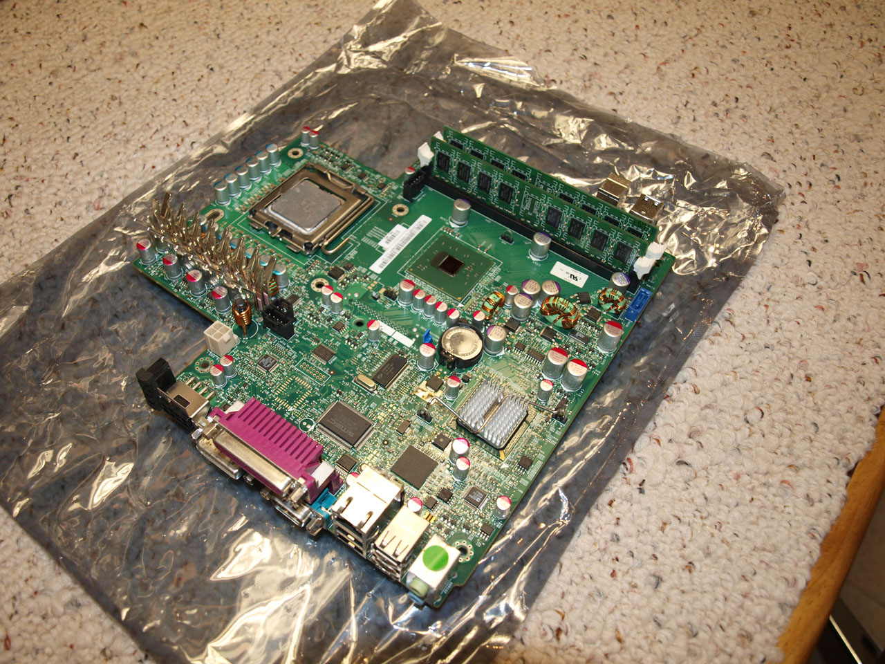

                To wake up an ancient thread......Many moons ago I bought several pallets filled with these little toasters. I recapped and sold them all except one I wanted to play around with....well 6 years later I finally did it. If anyone remembers Joe Lo (BigPope), he gave me a large sampler of Samxon's X-Con polymer caps in a wide range of values & voltages before he disappeared off the face of the earth. Using some of those plus some I had, here's the Truly Indestructible FULL poly modded GX620. There's not a single lytic remaining on this board.
                Testing.... It ran memtest86 all night, no issues, same with the usual battery of tests. CPU is a Pentium D 840 3.2GHz with 4gb RAM, windows 7 pro x64.
                This post of course created from it:
                Back together.
                Rather worthless system I know....but I've been wanting to do this for a while and finally had the time....well, and actually remembered.
