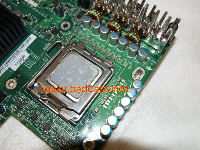

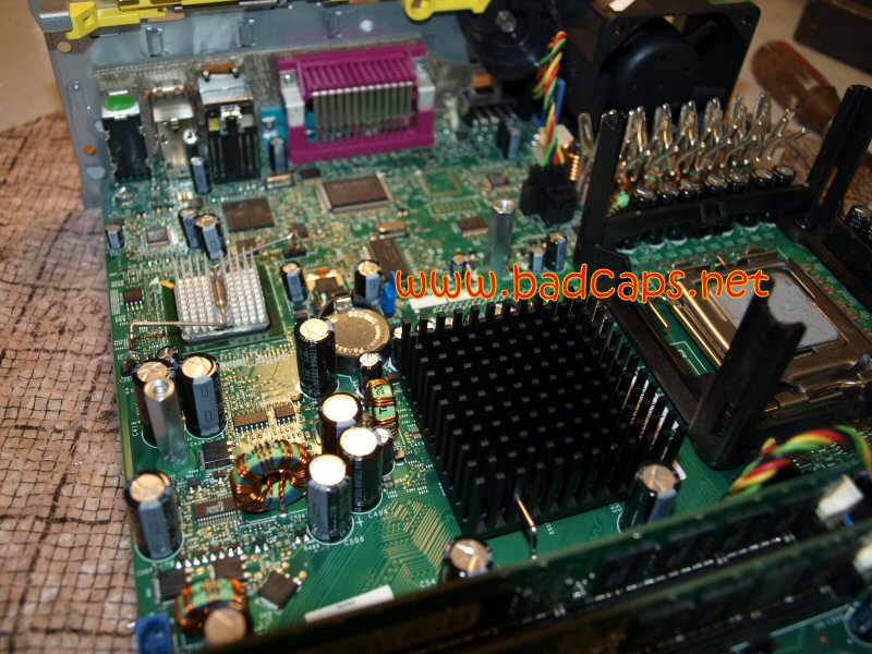

Anyway, the problem areas on these systems are the same as the SX280, in that the larger caps on the south end of the system are always fried. I've seen these systems fry UCC's, Rubycon's, and even Panasonics. The common failures are the 3x 820uF 6.3v caps around the northbridge chip (the 2 in front by the power button usually don't cause any trouble, but I changed them with polies anyway), 7x 2200uF 6.3v, 1500uF 16v, and if the fans become clogged with dust bunnies, they'll also roast the 1800uF 6.3v & 1000uF 16v caps around the processor.

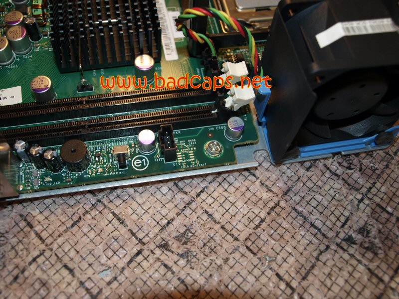

It came to me......I've poly modded a lot of SX280's, but unfortunately, theres not a whole lot of poly options for the south end of the board, which is where the majority of the failures are.... What could I use in their places... Well I fired one up, upside down on the bench and started measuring voltages...
All of the 820uF 6.3v caps had 3.3v on them. All the 1500uF 16v caps had 12v. The 2200uF caps were a mix ranging between 1v to 5v. Of course, all the 1800uF 6.3v caps were just VCORE. The 1000uF 16v caps behind the heatsink had 12v on them. The 1000uF 16v caps were the only lytics I didn't change to a poly, as I didn't have anything polymer in a 16v 8mm config.

the 820uF 6.3v lytics were changed to 560uF 4v polies
the 1800uF 6.3v lytics were changed to 820uF 2.5v polies
the 1500uF 16v lytics were changed to 330uF 16v polies
the 2200uF 6.3v lytics were changed to 1500uF 6v polies

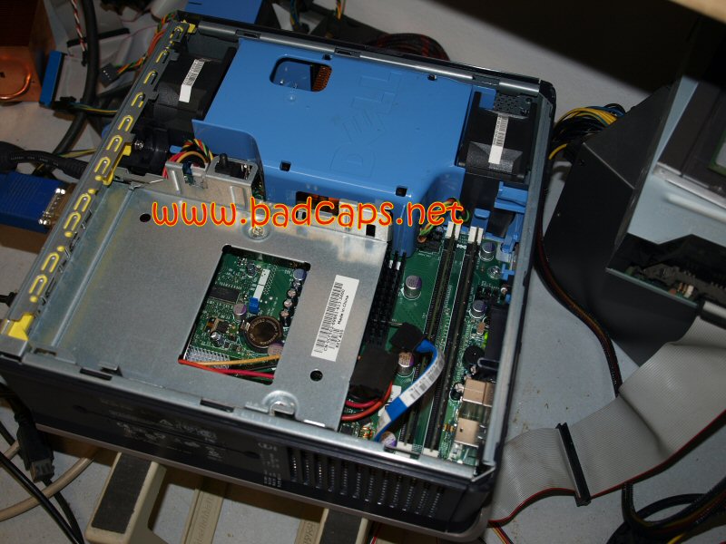

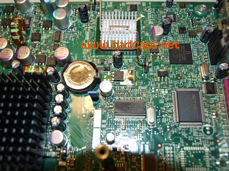

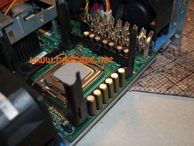

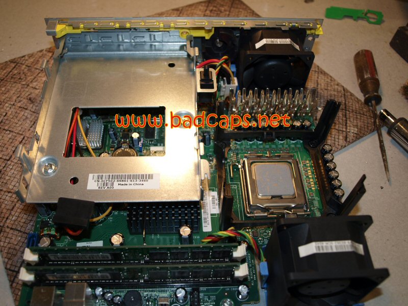

Here's some pics of the test subject....
The original UCC's:
Some rubies too:

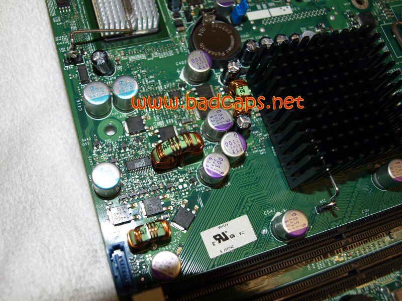

After the poly recapping:
Ok, now to see if this is going to work....
YAY, it POST's

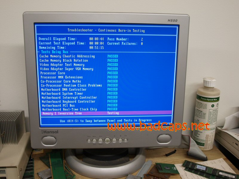

It ran some burn-in cycles for a while without any hiccups...

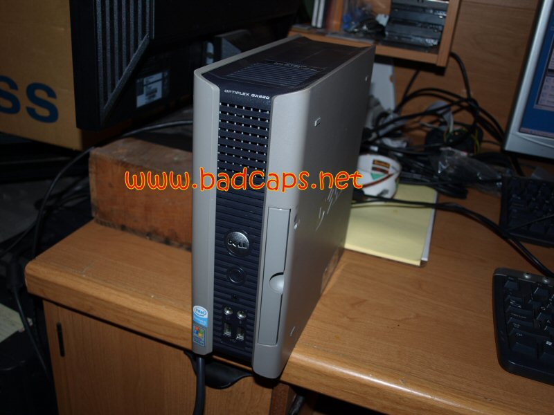

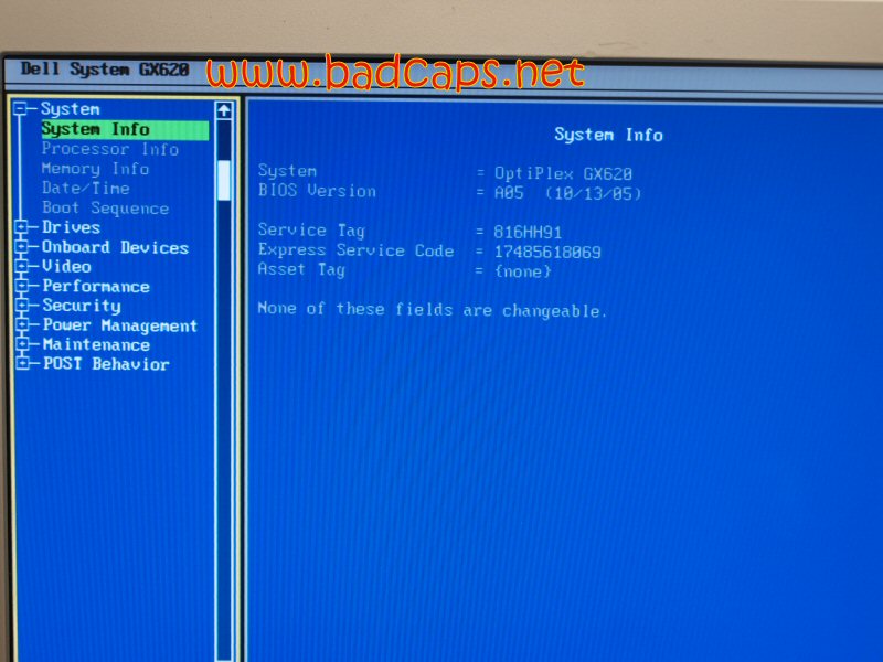

Quick OS install, which went without a hitch....

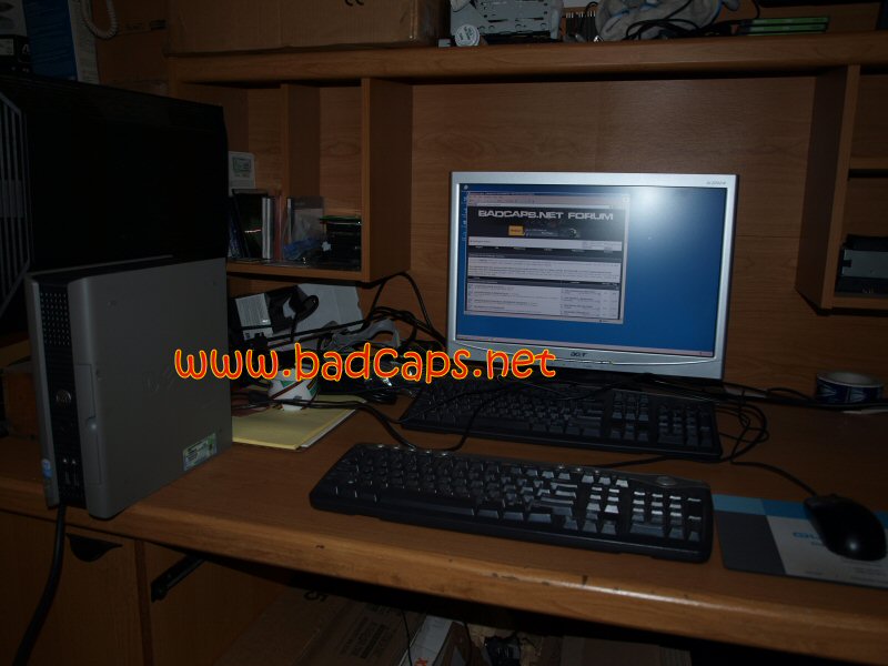

All done, up and running!
I'll find some use in the shop for this system, something that will keep it running 24/7. These don't last more than a couple years when they're allowed to run 24/7 with lytics, curious to see how long this one will live.
